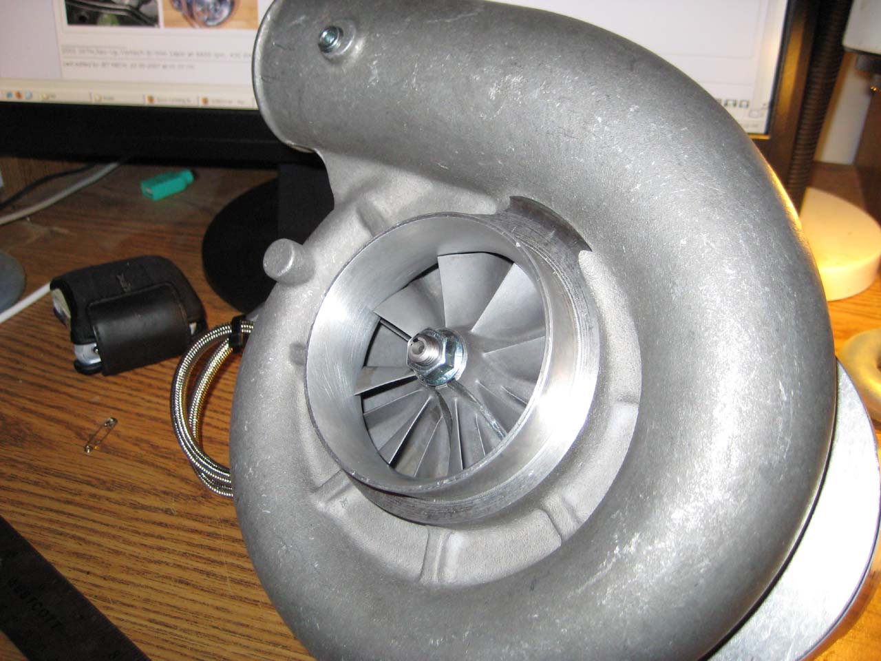

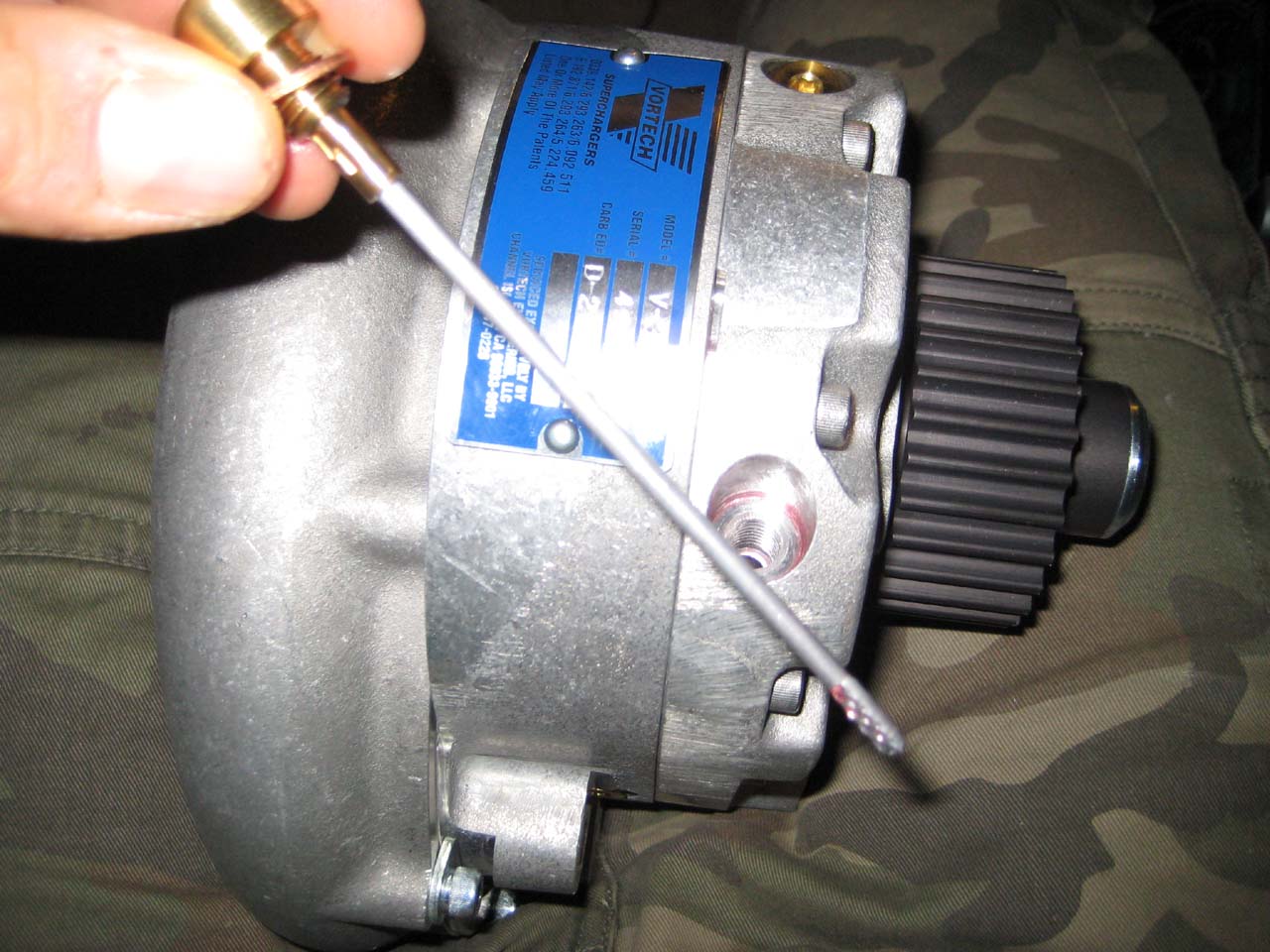

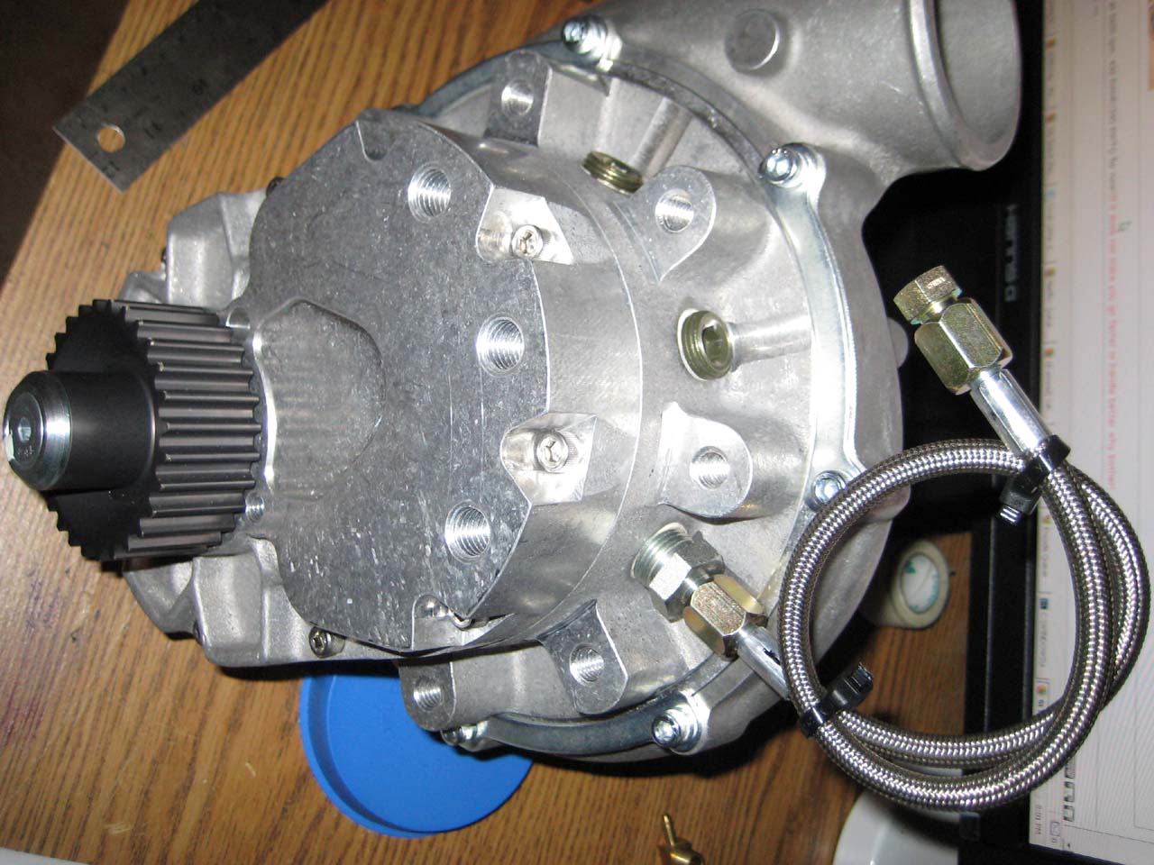

I know a bunch of people have this blower already but I hadnt seen any pics, so here are some. On the vortech website, it seems they are phasing out the V-2 blowers for the G/Z application.
The impeller/volute side is the same. On the Gear side, all you have is a drain line. There is a vented screw on the top of the blower. The dipstick is on the side.
Vortech says thats its the exact same internals as the V-2 Blowers. This is not an upgrade, like an Si impeller, but rather you'd have to get the exchange price if for some reason you wanted to switch. I probably should have got it polished

So this uses a self contained lubrication system like the ATI instead of engine oil?
Old Oct 1, 2008 | 04:31 PM
str8dum1's Avatar
str8dum1
Joined: Oct 2007
Posts: 8,807
From: raleigh-wood NC
yup 4oz of paxton sl blower oil. In fact they look exactly like a Paxton blower now
change at 2500, then at 7500 mile increments.
