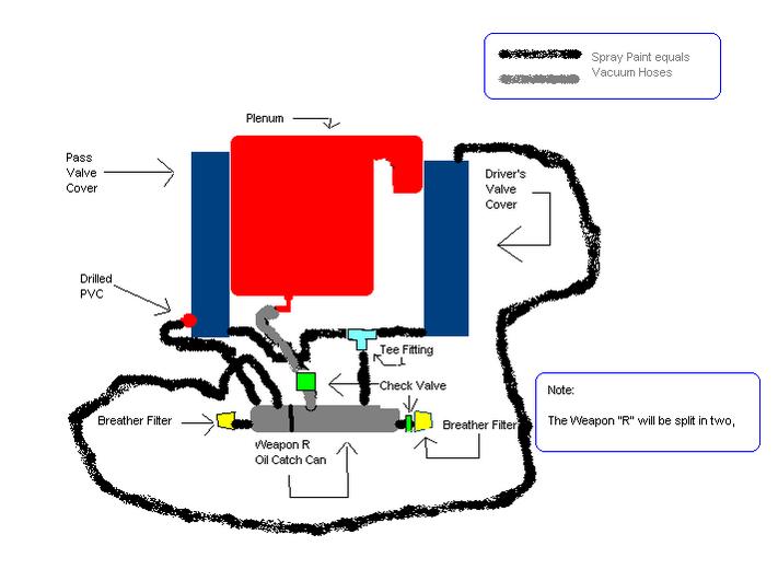

So much info: But it confuse me a bit. I hope i got this right. So here is my ghetto diagram.
Here is the catch can I'm using, keep in mind I have a G35. I will be adding extra ports.
Attached Thumbnails NE1 removed PCV on passenger side valve cover?-citymunky-s-pvc.jpg

^^^ If you orient the check valves correctly, I think that will work.
I've gone through another iteration of re-plumbing. The crankcase breather setup works, but it does dump fuel vapor out. You can minimize that with the plenum attachment for the hard vacuum on decel, but I ended up collecting more oil in the plenum than I wanted, even with the catch can in place (with the baffle, filter, etc).
Now I've gone to a design recommended by Joe Kenefic (the "MadScientist"). I have reconnected the central hose between valve covers and I'm running both passenger and driver's side vent to a greddy catch can that has been baffled with metal mesh screens and vacuum is provided from the driver's side turbo intake with a Krankvent valve in place (http://www.et-performance.com/). I haven't tested this out yet.
Time to bring this thread back to to life. I been very busy these last few months, that I didn't have time to thing about modding.
Anyway I sent my pic to a friend of mine and this was his reply
no! you will have a vaccum leak if you set up your catch like that and your not providing any suction durning boost
Originally Posted by citymunky
Does this seem right to you?
Now I feel----> I'm going to try to make another pic base of the info of this thread, I'll post as soon as I'm finish.

Wow, that's a little convoluted. You just need to use the manifold for vacuum during idle/decel and use the turbo intake as vacuum during boost. You can get away with one catch can by using check valves to ensure air only leaves the catch can regardless of boost/vacuum in the manifold. Or you can use 2 catch cans but you still need a check valve to prevent boost from the manifold from going back into the catch can. Some folks ONLY use the turbo intake. I tried that but I would get some smoking at idle (either out the tailpipes or out the engine breather if I used an open breather in the engine bay) so I went back to using the manifold for vacuum during idle (generates 5 psi of vacuum in the crank case).
