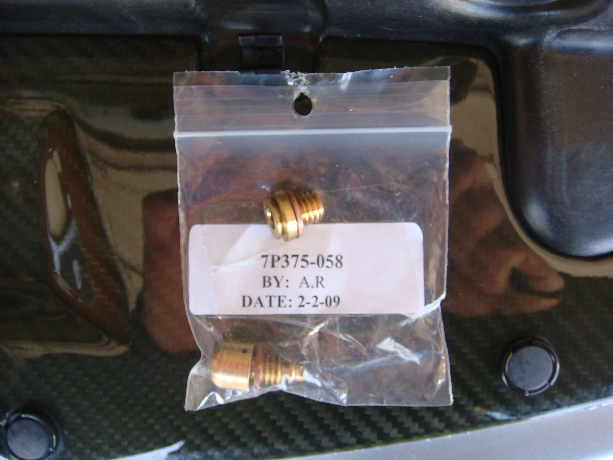

Ok, the oil drain line is the steel braided line that is attached to the bottom of the blower. Route the line so it descends down toward the ground vertically from the blower and use a zip-tie to secure it. You can access the blower oil drain line which will be above your under panel near the drivers side front wheel. Sounds like a pain in the a$$ but it really isn't. You will have to remove that panel anyways when you change your engine oil. Just remember to change the blower oil after the first 2500 miles. After that, it is every 7500 miles.
Another important item is the brass flat head shipping plug that has to be replaced with the vented round head brass plug. I attached a picture to help show what I mean.
I have to admit though, once the blower is installed, removing the dipstick is a major pain. It's a tight fit but I was able to remove and replace it with some manipulation. Not a big deal.

^ Thanks alot, always wonder how other V3 owner leave their drain line...
Yea, that's how i leave my drain line..And oh i didn't replace that...humm i guess i gotta do it.
Edit: btw, just notice that you have a plenty of room between pipe/AC line compare to mine.

I guess Vortech ships it that way to prevent oil leaking during shipping.
