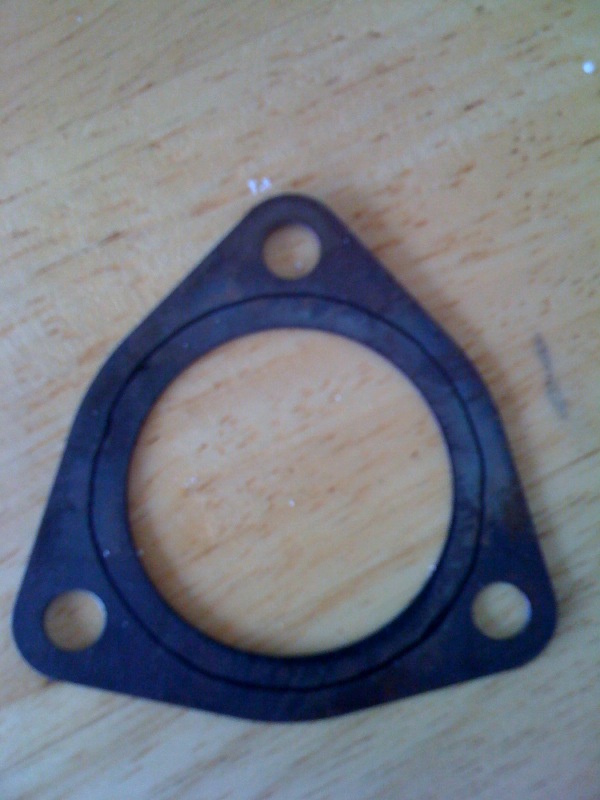

nice numbers! Do you know which upgrade they did to your turbos? I believe they had 3 different "stages" for the upgrade. I got the 76 Comp, 67 Turb.
For reference this is the stock 18g turbo gasket that came with the Greddy TT kit. After I got my turbos back from Forced performance I had to take a significant amount of material away from the gasket to match the turbine housing. I also will have to modify my downpipe.
that picture in your post, thats exactly like the difference in size for the greddy 18g and greddys 20g

oops, sorry rr didn't catch that earlier.
I was going to try and use a 20g gasket but the bolt spacing is different. I think the ID of the turbine outlet measured 61-62mm, just the right size for a 2.5" to 3" reducer for my downpipes.
