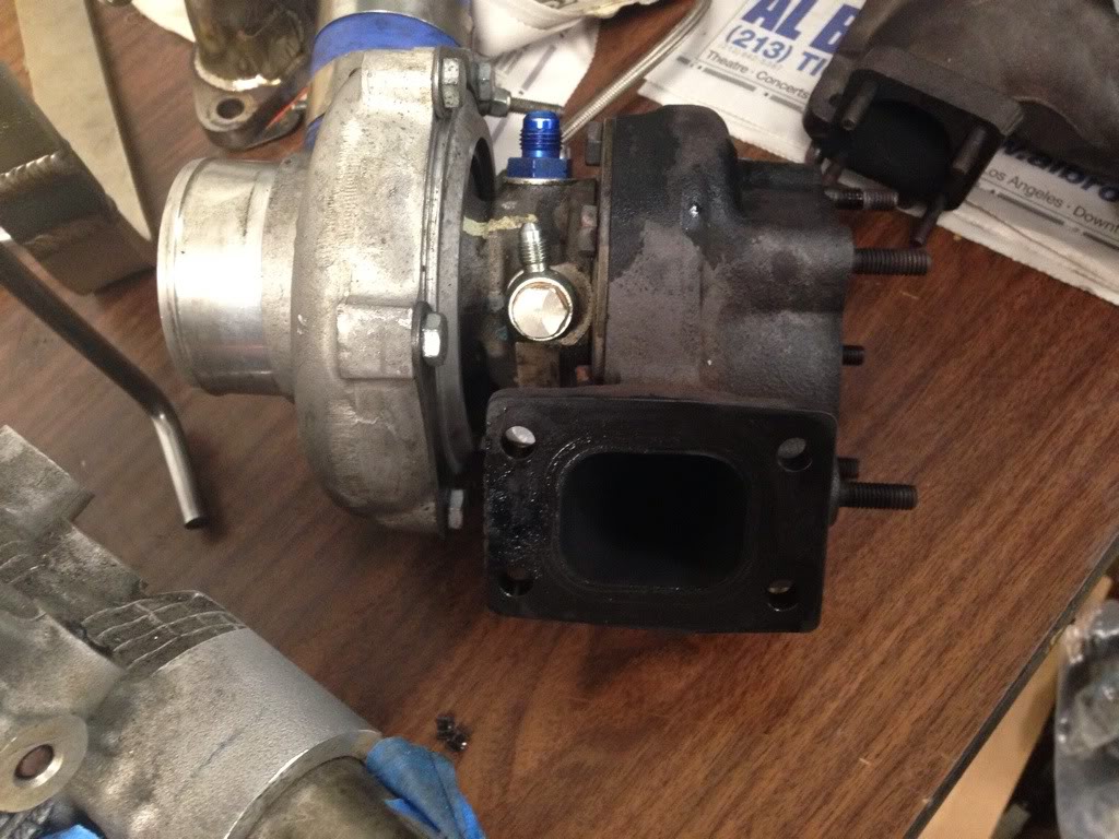

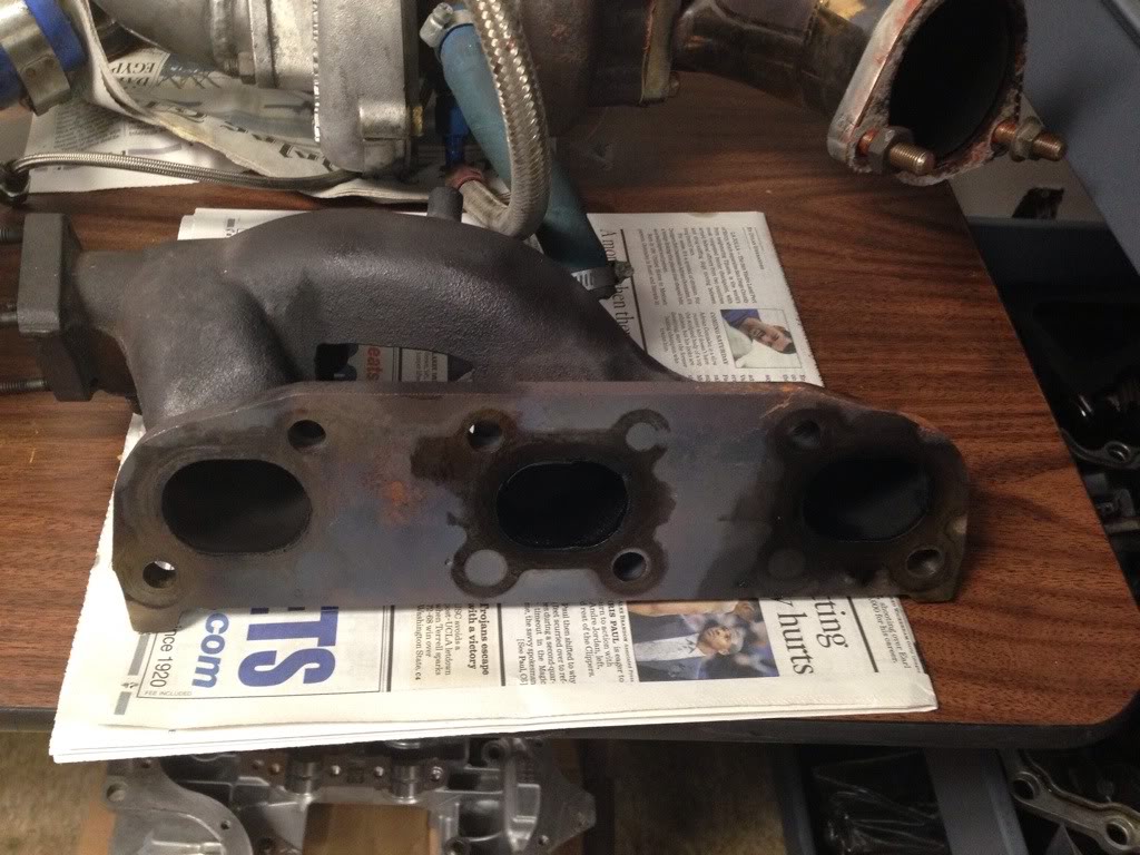

It is definitely coming from the motor and not the turbo.
I'm not sure on the specifics of where he found the oil but he is removing piston #2 and #4 this week to check the piston rings. If they look ok we are probably going to take apart the heads.
