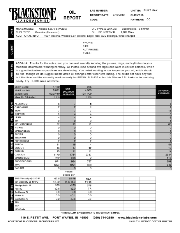

Sup all, attached is my oil analysis for those interested in checking it out. I was not able to find a single post with an oil analisys of a built vq35 so hope this helps, any input will be appreciated.
The aluminum might be a little high, I am just not sure if that is normal for a built motor: Wiseco pistons, eagle rods, acl bearing, stock heads. Anyone know anything about this? Can it be because the engine is still being broken in? (although it has 4-5k miles already)
The high silicone might be due to the fact I have a rear mounted turbo setup, so I am going to upgrade to a better quality filter.

Hey guys, I did my 2nd oil analysis. I was anxiously waiting for this one as I did alot of racing at the track as well as a good amount of highway runs. Everything looks great.

The higher the moly the worse it is? I still have not mastered reading these reports, I go by their comments lol.
btw guys although the report says it, forgot to mention I am using Rotella T6 synthetic oil.

The molybdenum is a lubricant present in very high quantity in Motul oils. It's neither good nor bad, just an additive. I cannot speak to Mobil's decision to covertly change base stock in most of their formulas except for a few... All I know is that our sticky oil thread shows Mobil 1 0W40 and Rotella T-syn with better than average results compared to all the rest and my own UOA support that, so...

Wanted to post my latest oil report: I dont know if I should be worried about the chrome, I dont know what I should do different to prevent premature ring wear, any suggestions? I read that high chrom can also mean poor air filtering, which I have to admit, having a rear mount turbo setup, its hard to keep that filter clean (K&N) and I dont do it often enough.
