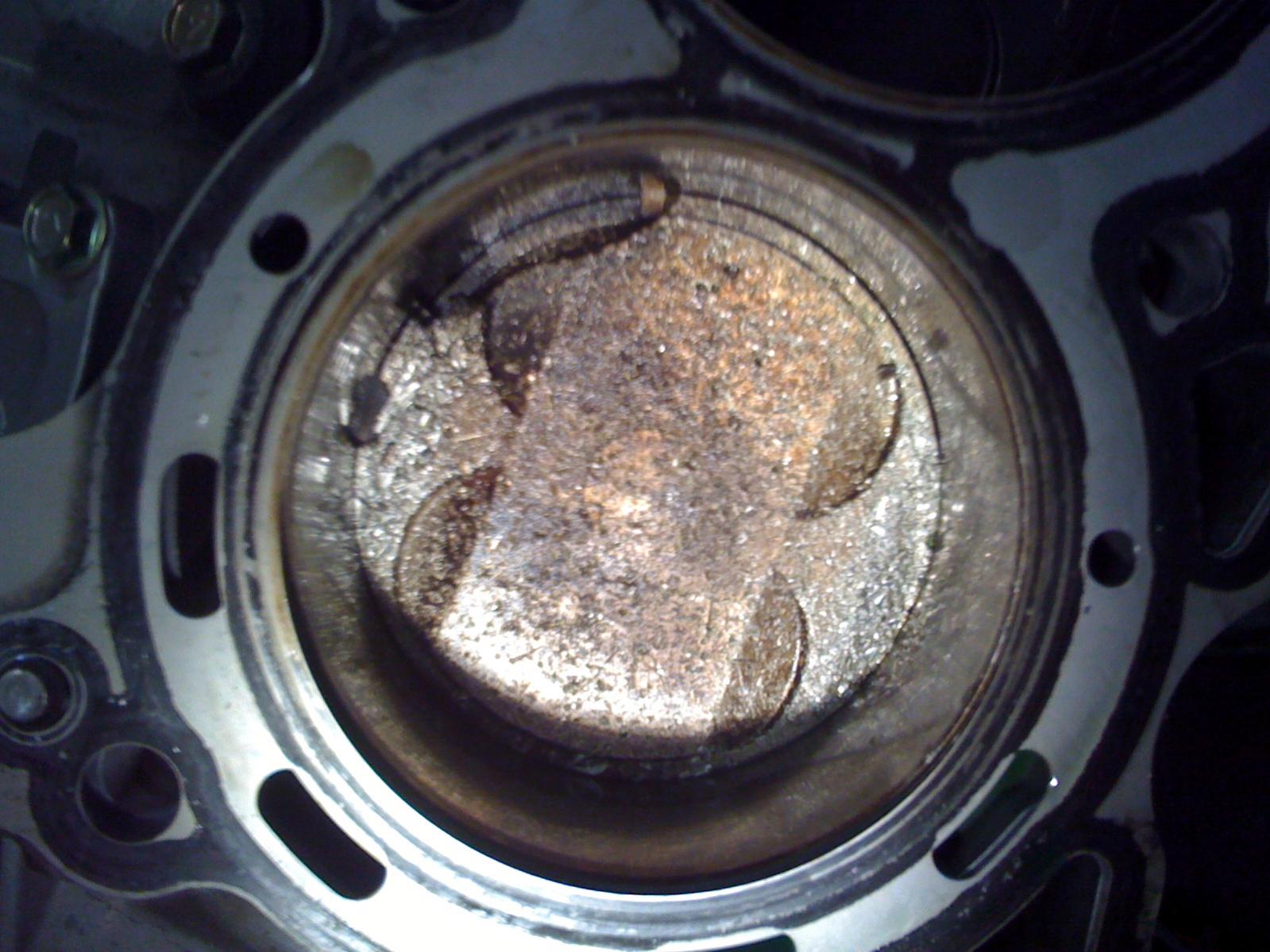

Originally Posted by Chris@FsP
Why? Because your blower, your rod bolts, and valvetrain weren't designed to spin that fast.
Correct. See attached pic of NA at 7500RPM.
Attached Thumbnails The "why should I not spin to 7500rpm?" thread.-aug08-004.jpg

Scotts300: From the pic it looks like you broke the ring land on the piston. I have yet to see this happen due to over revving but I HAVE seen it happen a lot due to knock. Are you sure overrevving was the problem?
