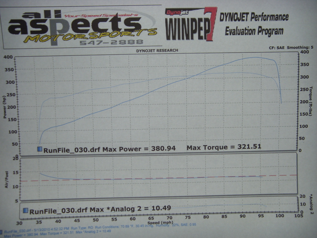

well guys here it is... i have worked hard on the car and only one month before i leave for sd im finished! i have done all the work myself except the tunning which was done at all aspect motorsports in va. here is the list of mods done:
9.5/1 weisco pistons
eagle rods
acl bearings
stock heads( should have port and polished!!)
rc 550's
kentix pelum
act clutch
vortech v2 w/ 2.87 pulley
strup headers and test pipes
borla exhaust
3.9 final drive
cusco a arms
k-sport coilovers
tork wheels
and i need a lsd!! that is the next mode...
oh and the tune is on crappy 91 b/c thats the highest cali has!!!!!!!
Attached Thumbnails Finally tuned... and now done!!!-dyno.jpg   Finally tuned... and now done!!!-st830663.jpg

cool..tune looks pretty good, what ems are you using?what does that dyno read a stock z at? seems low for the pulley and setup on a dynojet? how do you like the 3.9 final drive with the vortech?
Old May 13, 2010 | 04:50 PM
ZACKPLETT's Avatar
ZACKPLETT
Posts: 59
From: san diego, ca
car has 57k. motor has 2k. i got a utec ems. i thought it was kinda low also but it is on 91 octane! i went once b4 when i was still running 93 and i hit 400 w/ the belt slipping at 6k rpm. so what ever! the 3.9 is probley the best mod i have done to the car! its a huge difference w/ it. im telling u its a whole new car with it. i cant wait to get my lsd in there....

Looks good!! Those numbers are also SAE corrected at like 5% take that out and you up around 400whp on 91 octane...

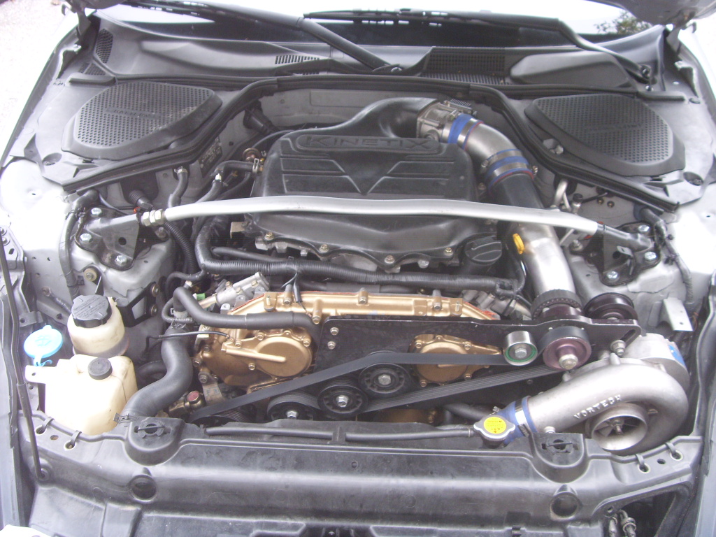

pick under the hood 4 everybody

From: DMV
Congrats on doing that all yourself.
Built at that power level should equal tons of dependable mileage out of that setup.
Well done.

For Vortech/10lbs boost/low compression looks about right HP/TQ wise. Tune is really nice looking...great job.
