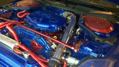

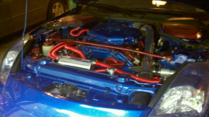

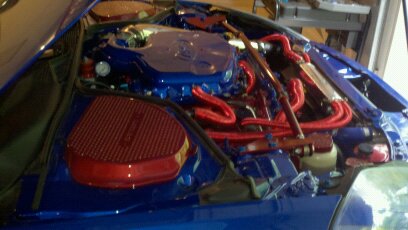

Originally Posted by cux350z
any pics of your engine bay?
Some of your parts in your sig look tempting
Cass007.... ver 5.0-1304709693237.jpg Cass007.... ver 5.0-1304709725316.jpg Cass007.... ver 5.0-1304709735705.jpg
