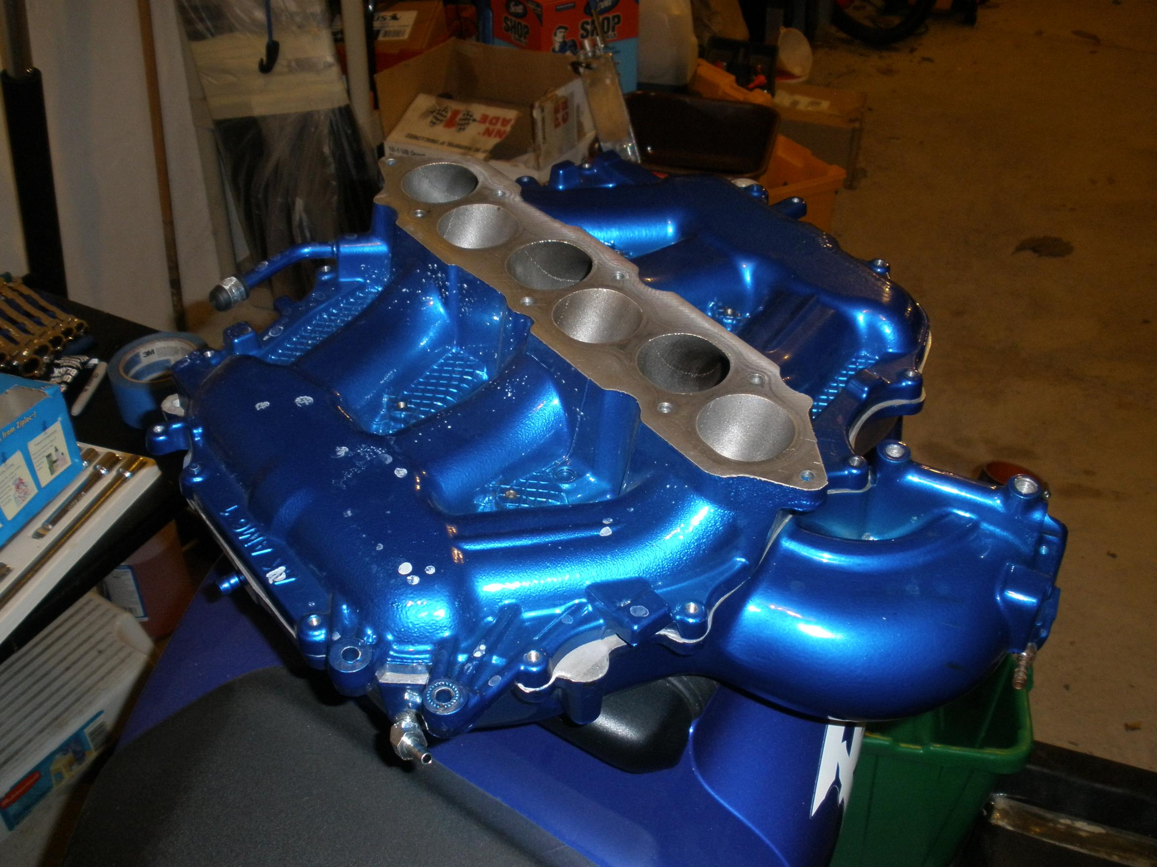

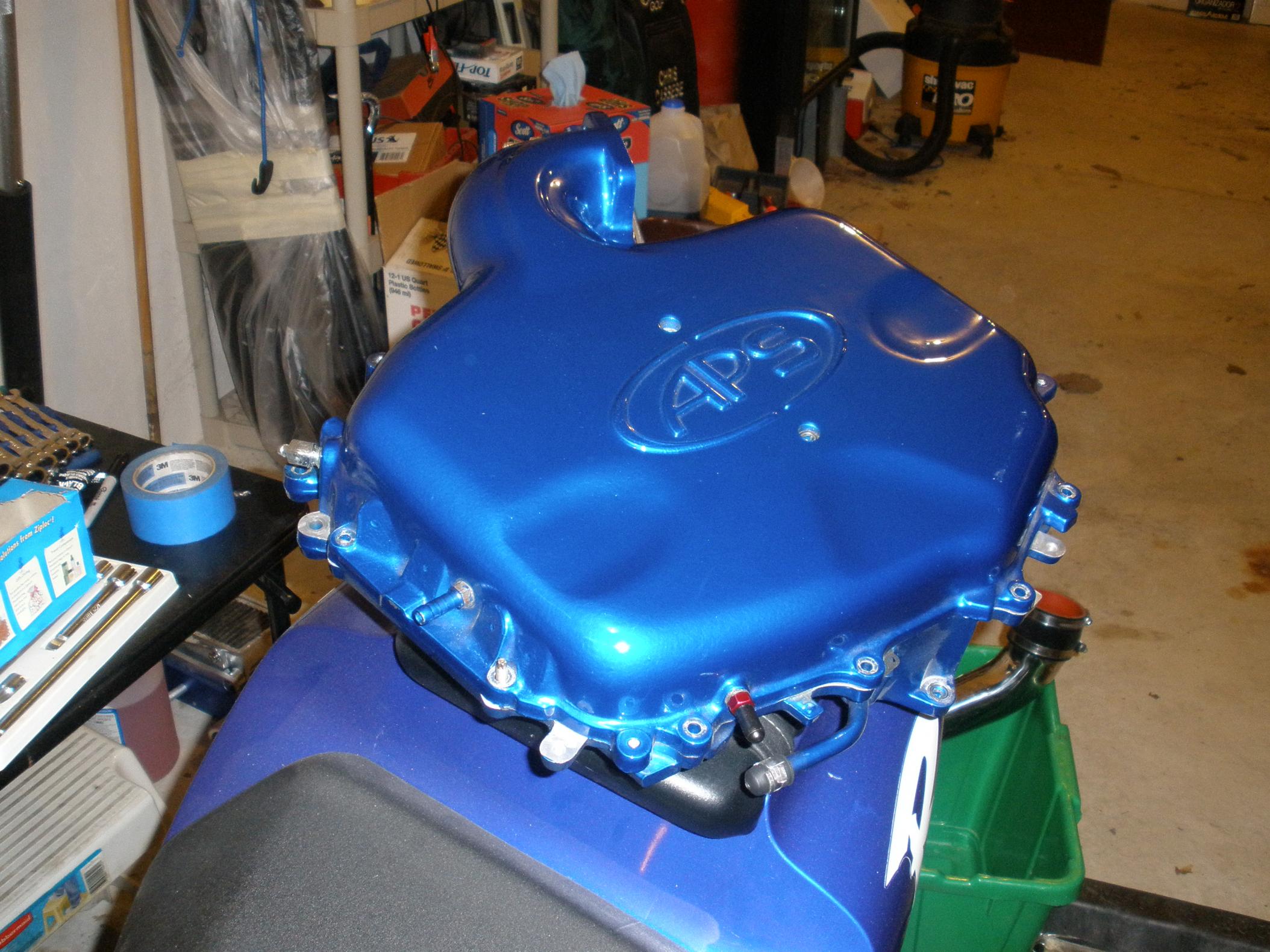

For IslandZavage:
Cass007.... ver 5.0-p5091431.jpg Cass007.... ver 5.0-p5091432.jpg Cass007.... ver 5.0-p5091433.jpg
There is a scuff mark on the timing cover (pic one top center), not sure from what, but the mark could not be seen with the plenum on. I had no idea it was there till I looked at the picture.

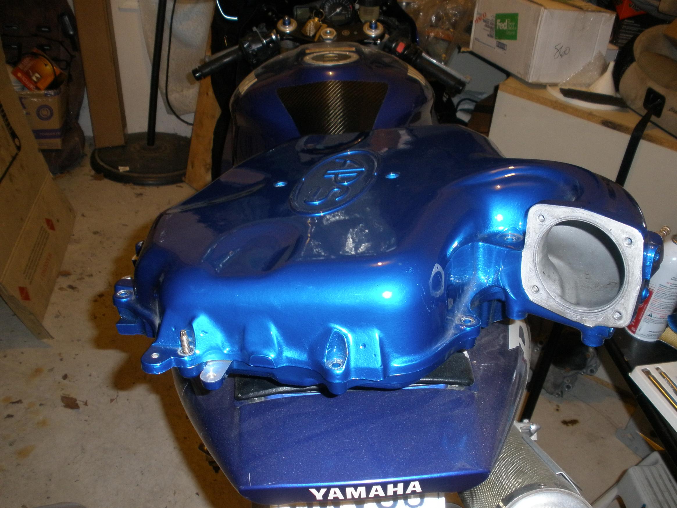

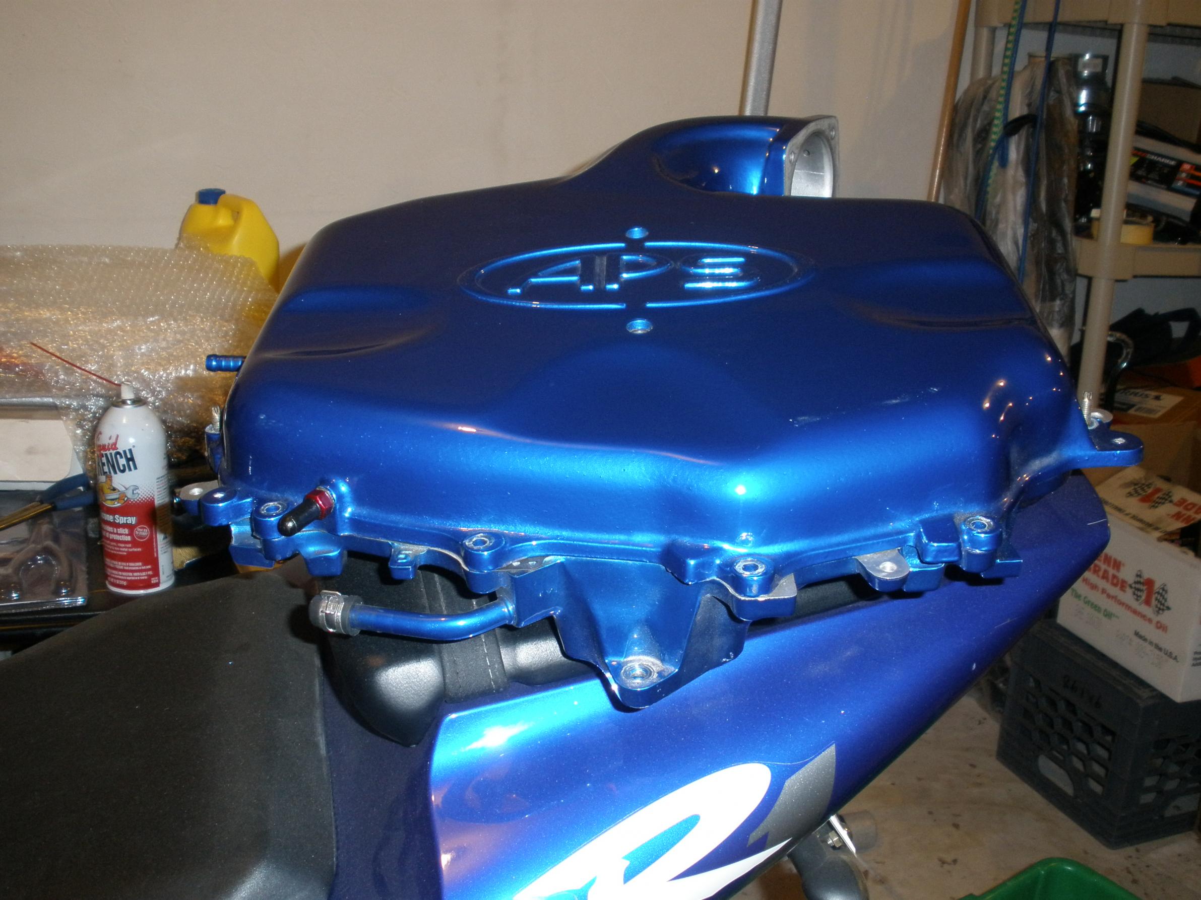

The white spots on the underside are just water marks, they wipe right off.
Cass007.... ver 5.0-p5091434.jpg Cass007.... ver 5.0-p5091435.jpg Cass007.... ver 5.0-p5091436.jpg Cass007.... ver 5.0-p5091437.jpg
I just went to the garage and confirmed that the mark on the front left of the top of the plenum was just dust - not a scuff mark.

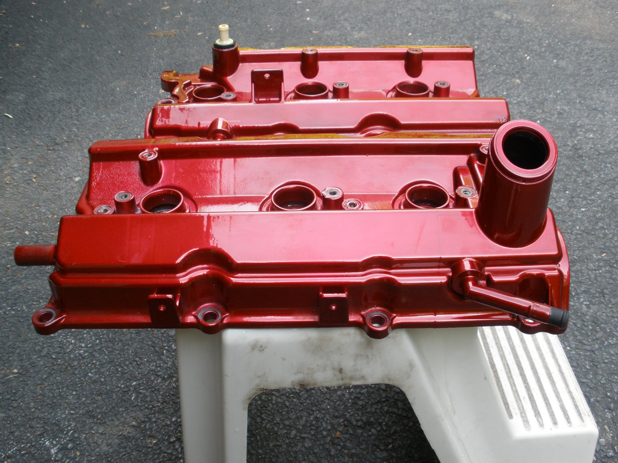

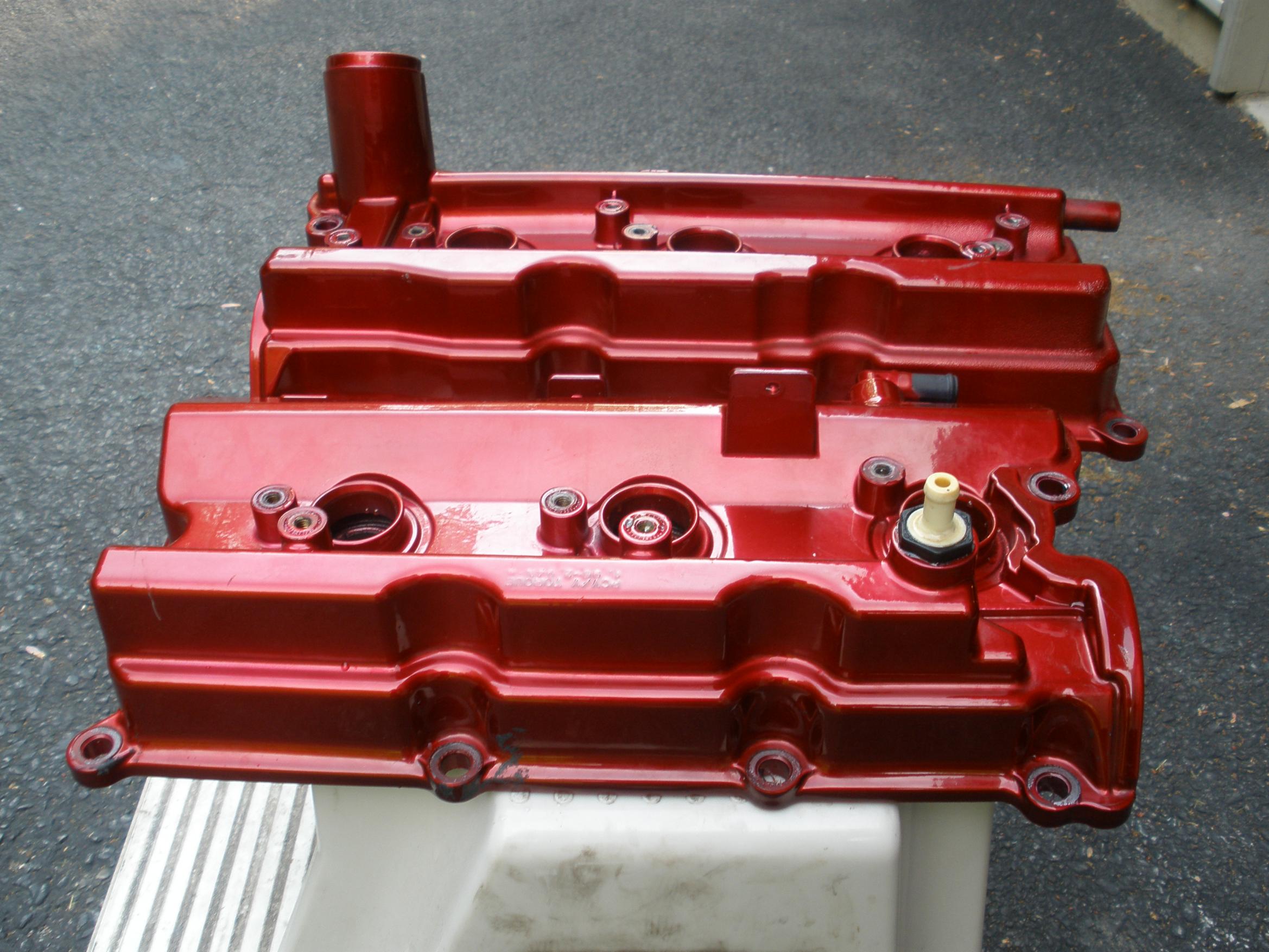

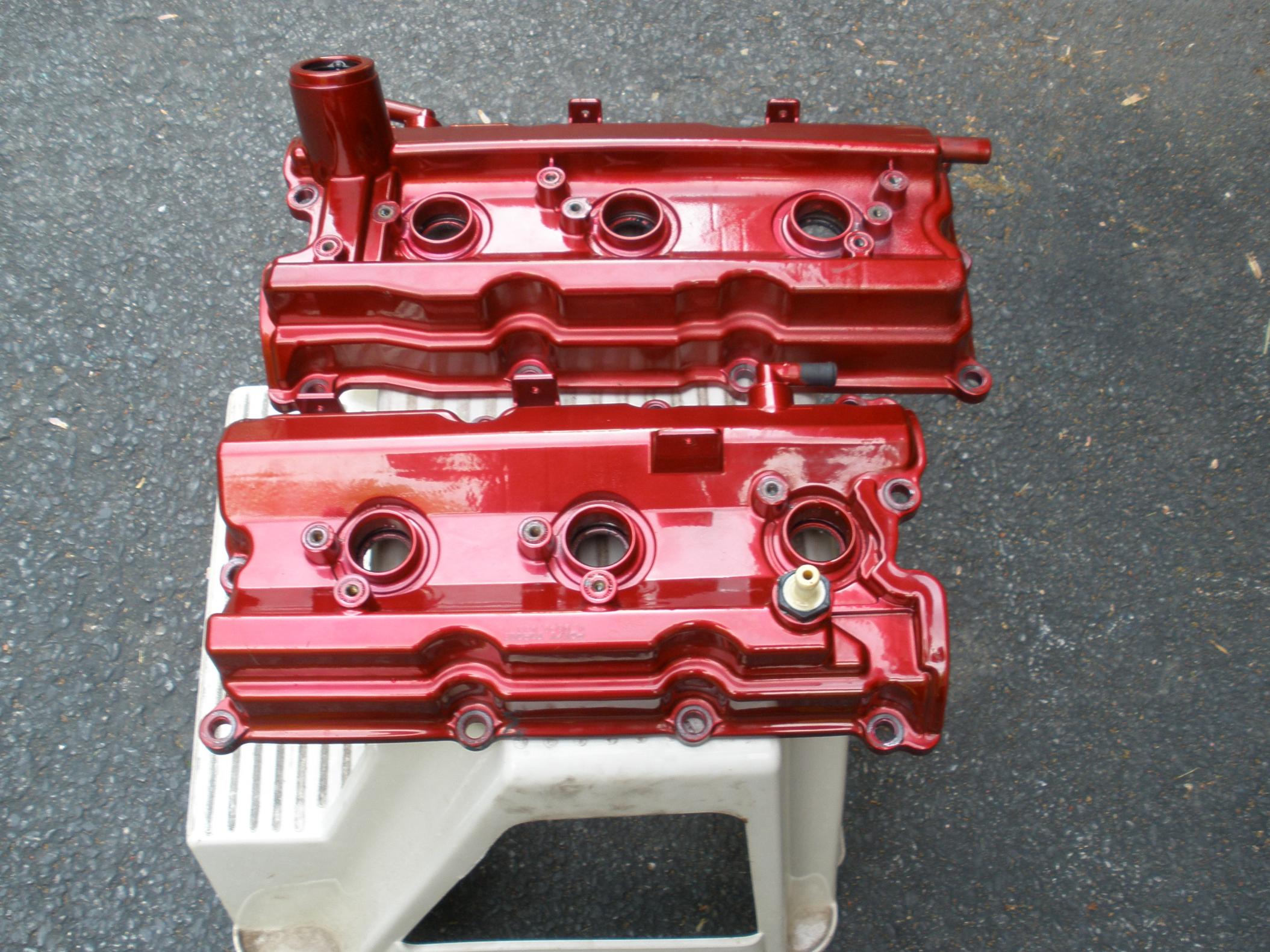

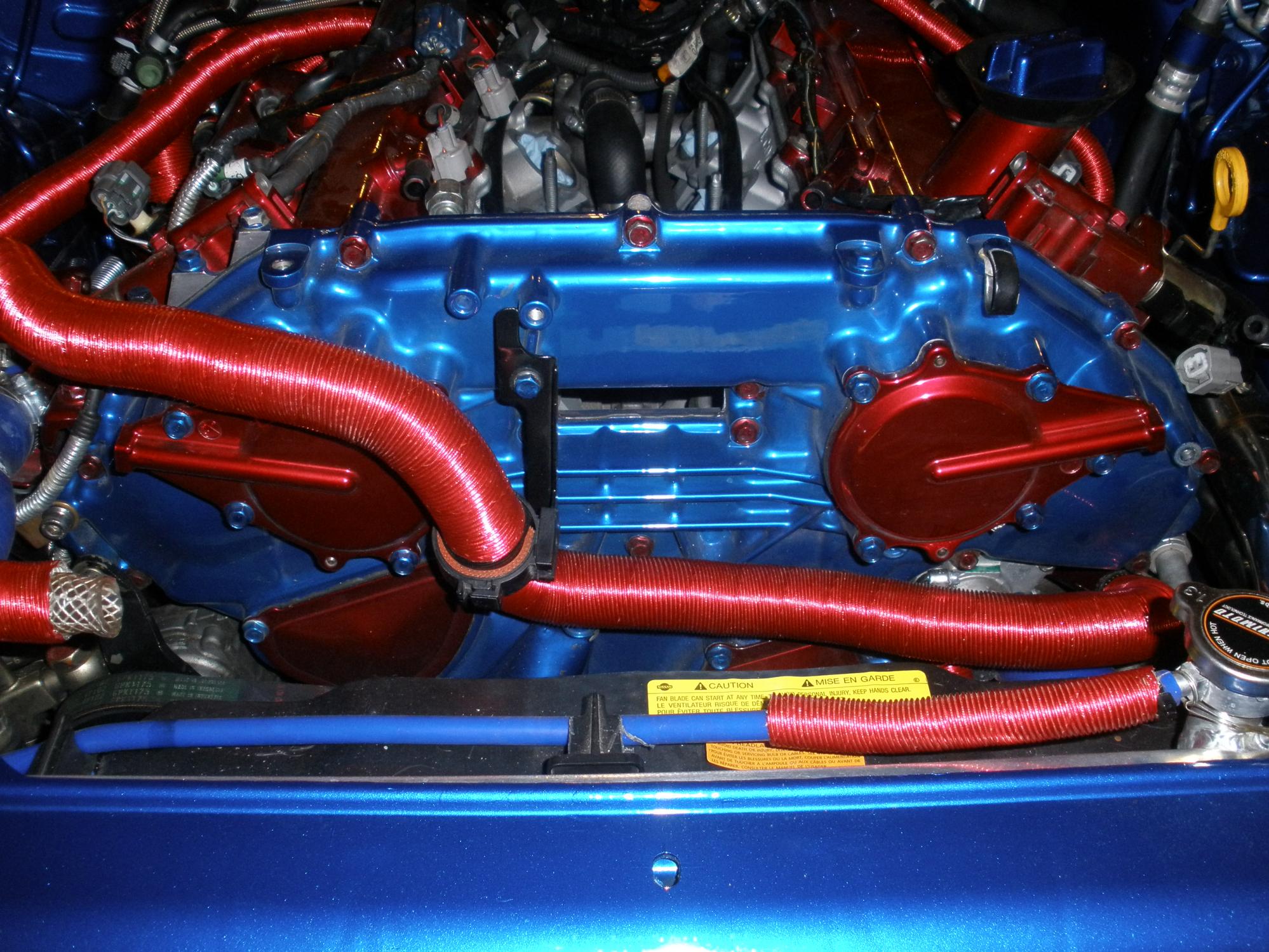

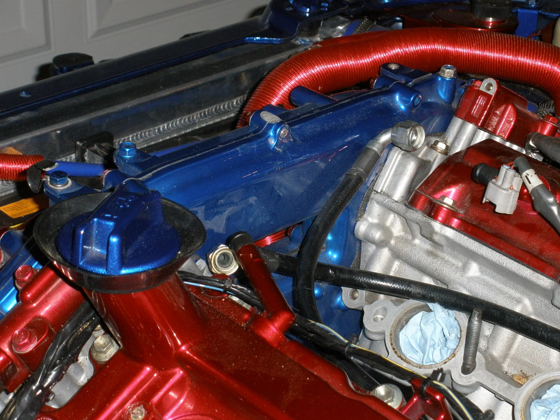

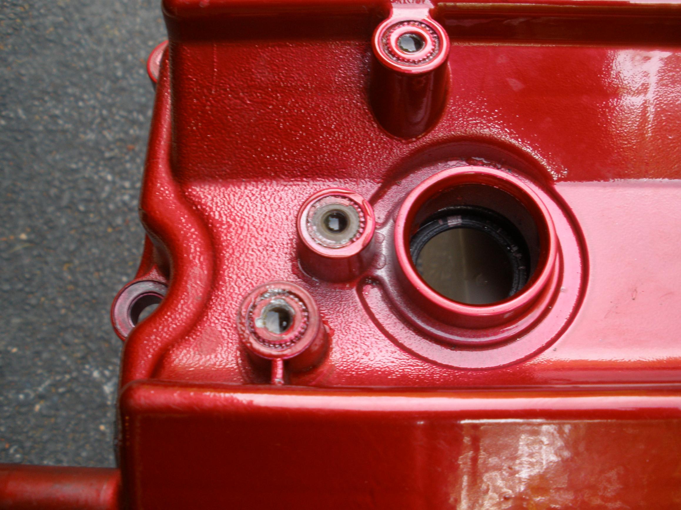

Per request of an interested party:
Cass007.... ver 5.0-p5121441.jpg Cass007.... ver 5.0-p5121442.jpg Cass007.... ver 5.0-p5121444.jpg Cass007.... ver 5.0-p5121445.jpg
You can see the is some orange peel on the drivers side rear cover... this is covered by the intake pipe going over the top of it.
