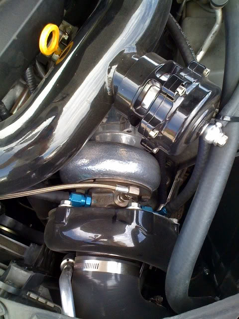

My G35's at my parents house right now so I don't have pics to show… but you should have a 90 degree coupler coming off the cold side of the turbo, connecting to a 8” - 10” inch aluminum pipe (the intake pipe and coupler would roughly be in the 5 o'clock position), and of course the intake filter should be connected to the end of it… We also had to bend the supplied A/C line a little bit to make clearance for the coupler. Sorry, if that’s not very clear, if you still need to see it installed I can snap some pics Saturday morning when I get back to the car. I’ve attached the closest picture I have on hand.

where does it go?!

i need more pics but cant find anything!
