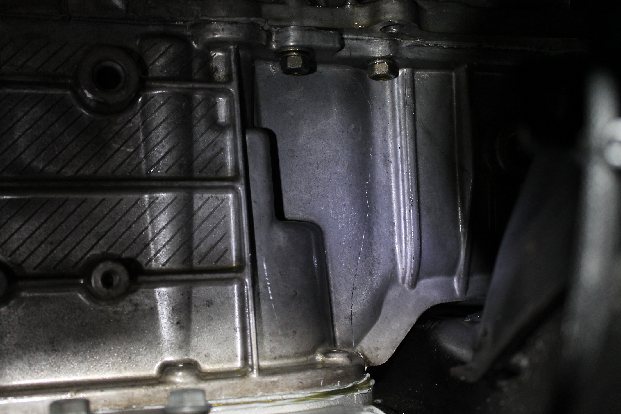

Just an update. We went 1/8 mile testing and started turning up the boost. Second pass I felt a little problem with the car and let off. Still went 5.41 @ 137 in the 1/8. Took it back to the shop and this is what we found. Cracked the block! Right under the driver's engine mount. I guess I had too much faith in using the stock engine mounting location. We will get build another block and will have to use motor plates instead.

Damn thats weird that the block and upper pan both cracked

It looks like it is a non internal crack, couldn't you just weld and reenforce it, the second picture looks like the upper oil pan, that doesn't look that bad

Wow, cracked right around the engine mounts. Beats rods flying everywhere, at least here you have a clear solution.
