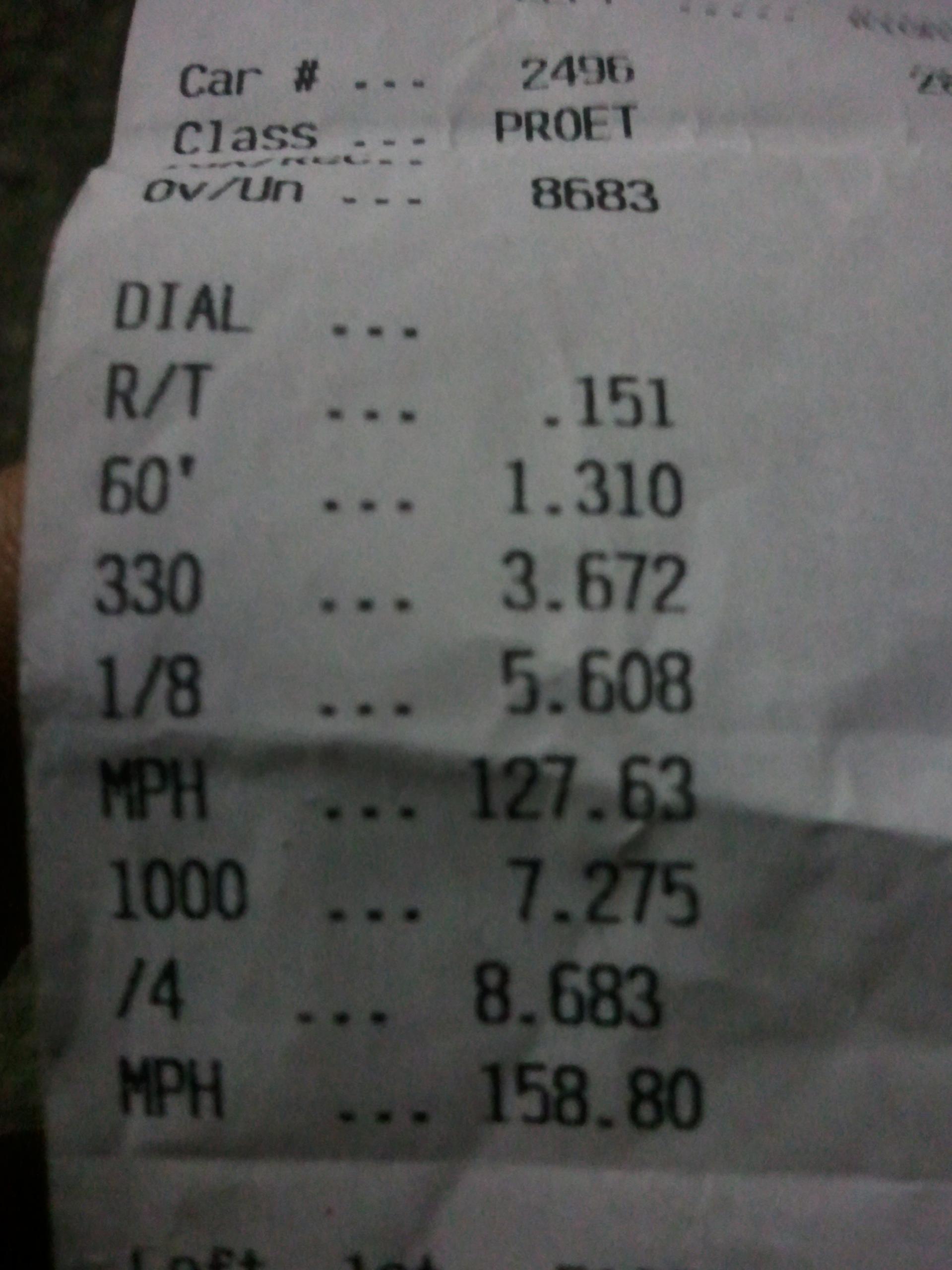

Finally got some time to do some testing. We had to change the suspension setup and add weight to make it 3150lbs. Going from an SR20 with a 5 speed to a VQ with a powerglide only added 100lbs to the car. This pass was at 25#s. The next pass broke the trans on the line. We plan to race at the event in West Palm Beach next weekend. So hopefully we can get some vids.

Nice run. I keep forgetting this isn't a Z... but sick motor. Are you using a stock Z diff?

158mph
LOL
Faaaaaaaaaaaaaaaaawwwwkkkin fast.
