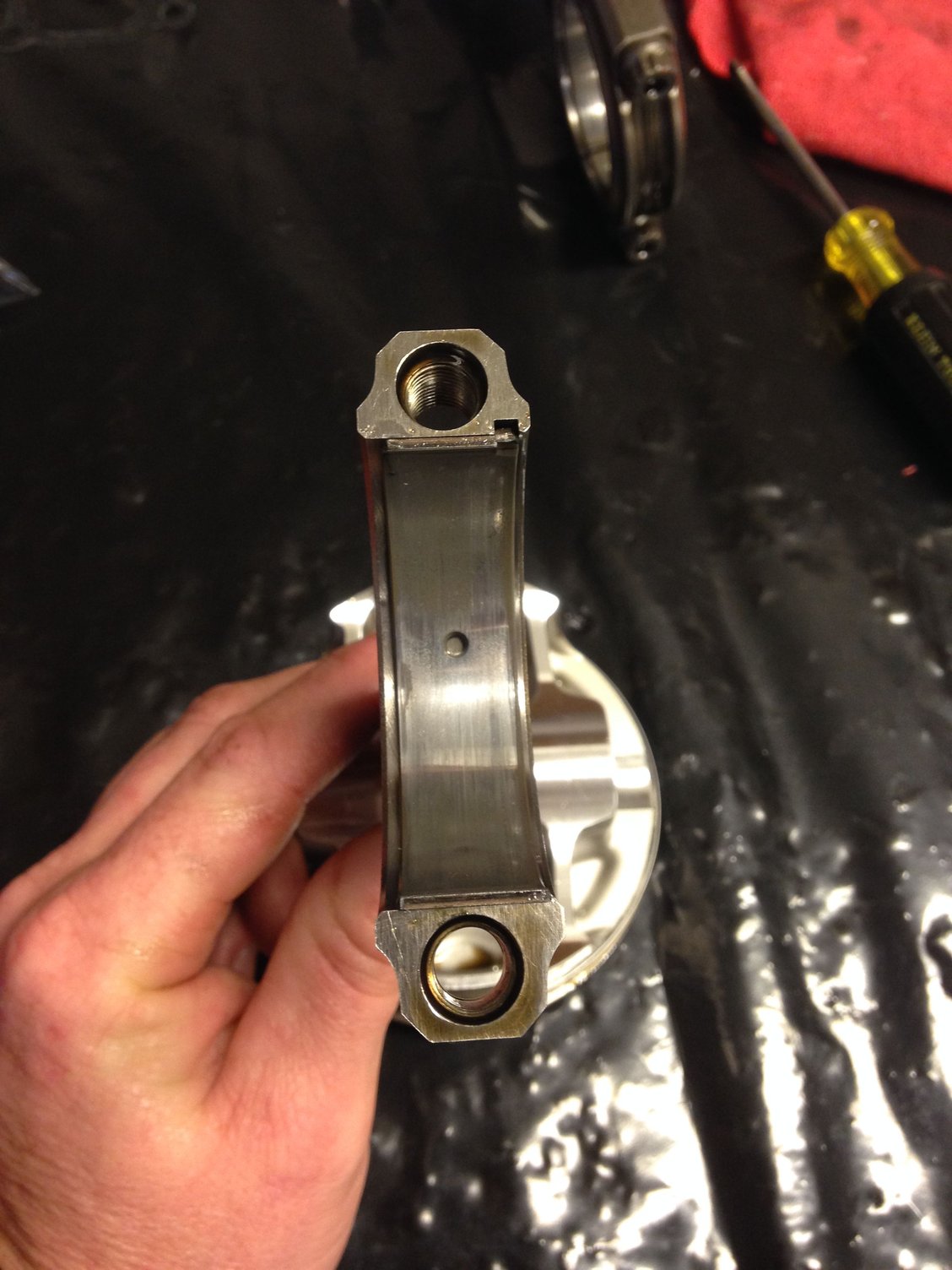

This thread still going or what? Just broke down my motor that was originally built for boost and ran into issues. Dropped off to machine shop and right now I need to make decision on clearances. My goals are to be between 700rwhp and 8. This is very confusing. I am have shops assemble the long block so I know everything is right. Thing is I'm lost on clearances. From what I found when I took apart was the fact that they were acl std bearings and seems that either clearances were to close or oil starvation. Idk. But here a pic of a rod bearing. I'm definitely wanting looser clearances this time around. Any ideas? Thxs

Iam driving on 10w50 full senthetic oil and hx acl that's .001 more clearance. Around 600 whp and no problems.
.001 more then the factory spec? That rod and main?
yes factory spec and yes rod and main.
