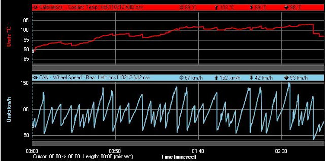

Not sure if this might be of interest, but I'm seeing below temps. Thats from start and 2.30min+
(in my mind it's not great temps...)
That's on track.
