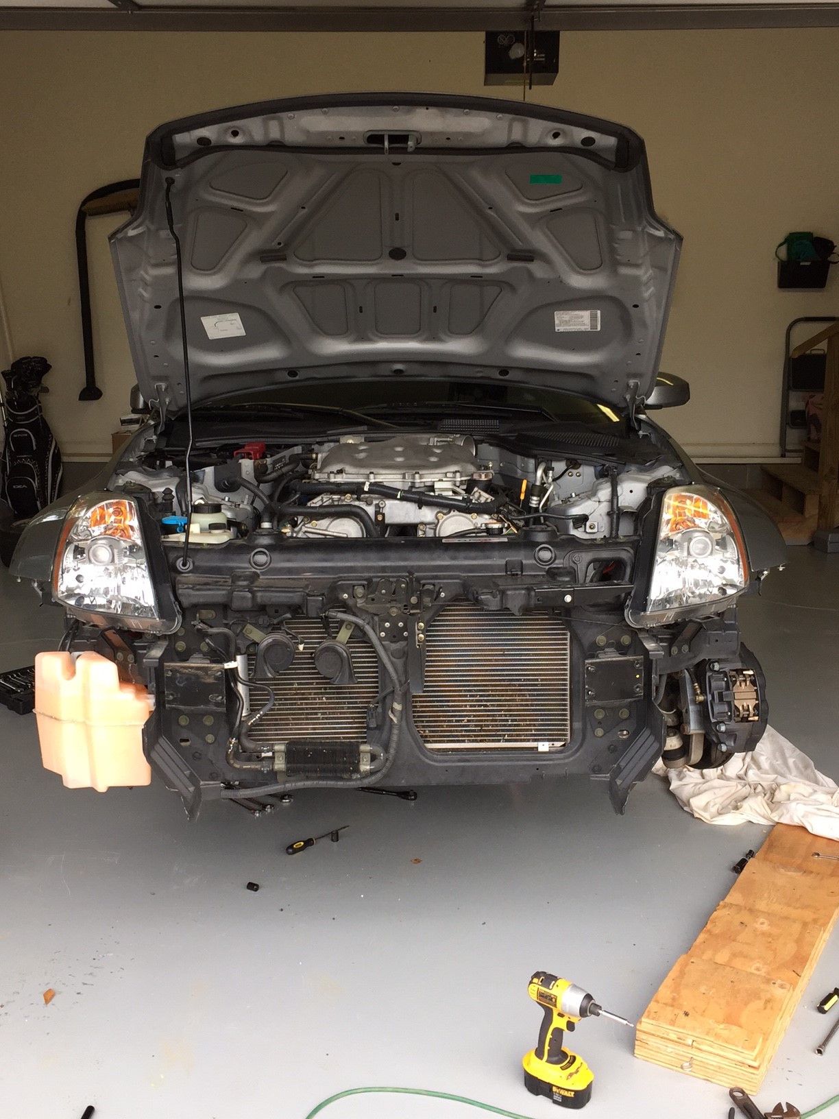

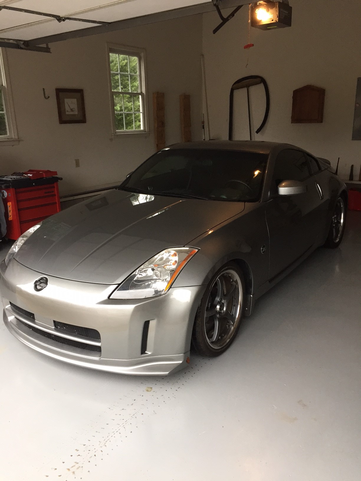

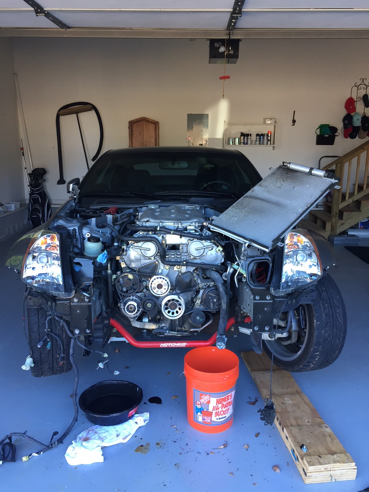

well, I have finally pulled the trigger on this project. I changed jobs and moved 3x in the last 3 years so its been put off time and time again. This weekend i decided its time to get going. Started by just removal of all the easy stuff. Gonna get a few helping hands and a engine puller and get the engine pulled in the next couple of weeks. I have attached a few pics of my progress.

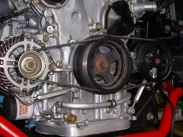

here is the photo you requested. I cant attach images to private messages so ill put it here.
Old Dec 8, 2014 | 04:43 PM
  #59
phunk2's Avatar
phunk2
Joined: Mar 2013
Posts: 329
From: chicago
Note that the VQ engine uses BSPT threads, not NPT. So you need a 1/8 BSPT adapter for the oil pressure port. if you want to add 2 more ports like I did, you need a 1/8 BSPT tap.
