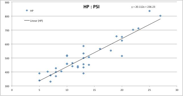

Sorry, late to the party...can I still chime in?
Originally Posted by supraturboman
5Psi willnot get you to 400whp.
True statement...I love me some numbers so I made this scatter plot...boost psi to whp...
400whp is roughly 8.25psi
To the masses: If you have a good boost : whp numbers please PM me with these and I will add them to the curve.

Nice chart, thats good to know. I will be pulling the engine and tranny at the same time, then installing the kit and putting them back in as one piece again. Do you think I'll have any issues with clearance that way?
