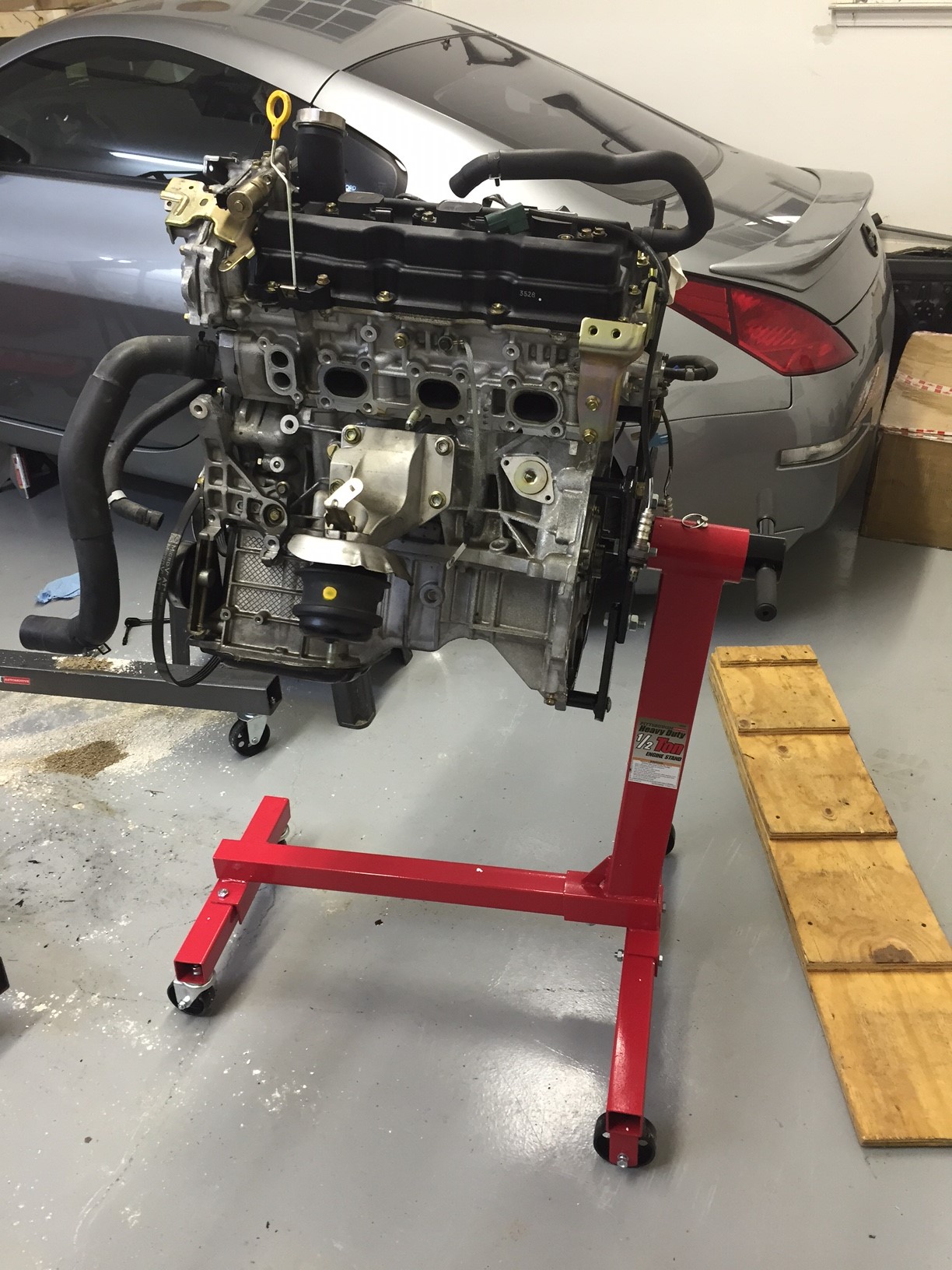

got the engine on the stand. so far so good. As far as the power steering fitting, Im about to send my stuff off to the welder, how did you guys re position this thing to be after you cut and weld it? Can you post some pics?
I put mine in a vice and bent it back about 15 to 20 degrees...I'll see if I can get a few pictures...

that would be great. thanks

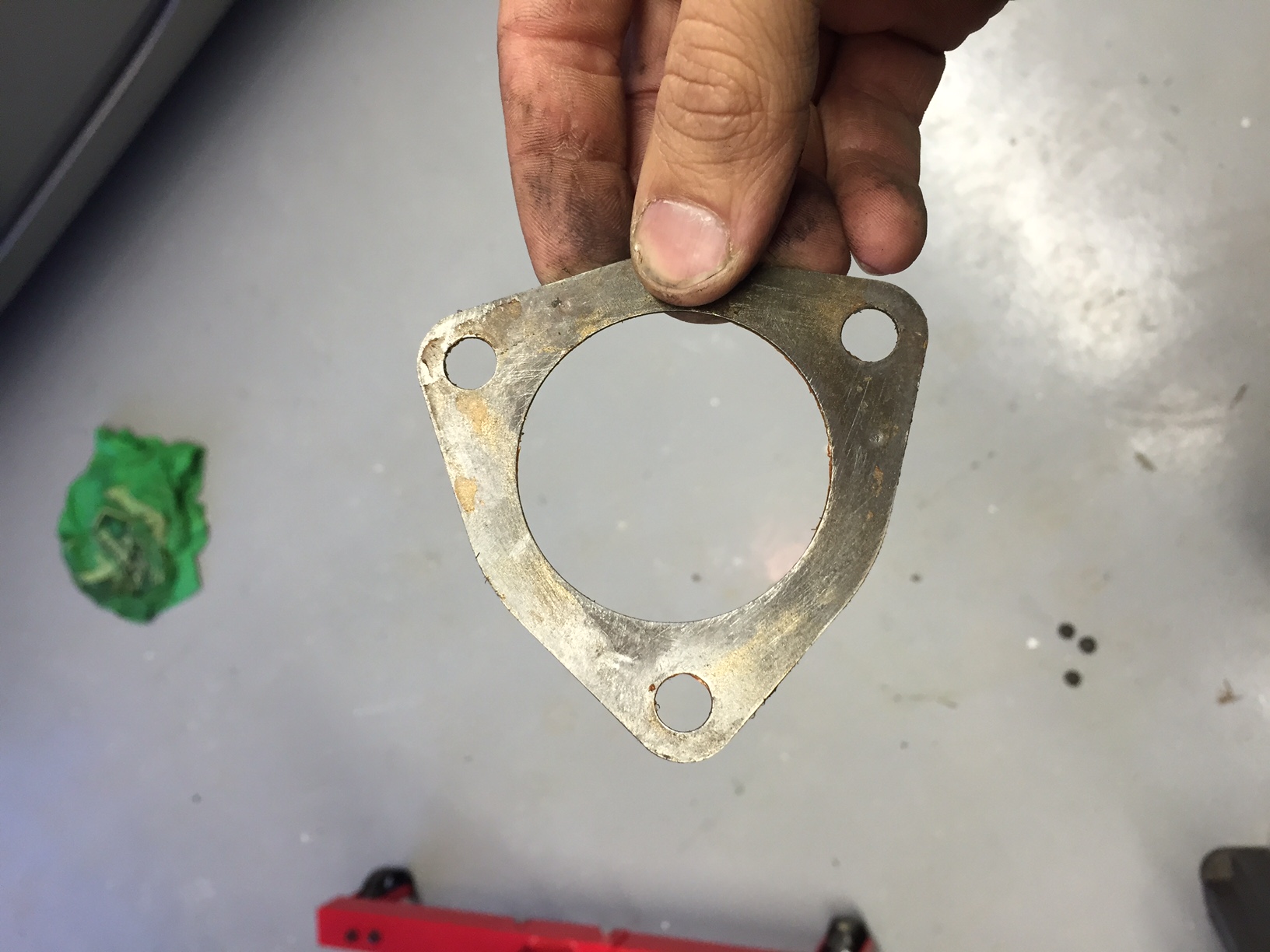

does anyone know where I can get one of these gaskets? its 2" (50mm ) diameter opening. It goes on the turbo where the down pipe bolts up.

Those are mostly proprietary to Greddy, never seen anyone else use them. The good news is they will out last your car. Just scrub them off with scotchbrite and reuse them.
so I have to get them from greddy direct? damn...$20 a piece. I see what your saying, they are tough. I cleaned up the other ones I have. They look like new!
Kamak sells gasket kits for MHI/greddy turbos ($9.50):
http://shopping.kinugawaturbo.com/gasketkis.aspx
They also sell all kinds of upgrade stuff, better thrust bearings (similar to Holset), billet bolt-in compressors, etc.

damn wish you could have posted that earlier. got it from greddy...$20 plus $16 to ship!

They are just stainless shims, they have no stopper beads or anything like that... nothing wears out. A cleaning is all they need, I have reused them several times over for years, never had a leak.
sweet. I was missing one so I really didnt have a choice. Pisses me off these companies that charge as much for shipping as the part costs.
