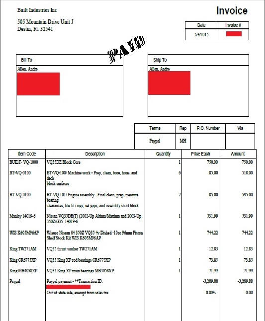

Its been a long time. Sorry for the late update. So this will be a long one, grab a beer.
PCS moves suck and take a lot of time away from modding but I made up the time lost with the big changes happening now since im finally settles here in big ole Texas!. Finally have my Z and my wife's car here as well as gotten our housing taken care of, and my tools will be here with my household goods next week Monday.
I digress. Before I left Hawaii I swapped my Quaife + 4.08 geared LSD with a Stock 3.54 VLSD from my friend, Kingbaby, who is a moderator here in the forums. I believe me chasing for more power and being able to put to the ground more effectively is important, this is why I gave up on the 4.08's. As far as I can tell, he loves it being the HR na fanatic as he is!
OK, some things I bought are an upgraded Methanol nozzle from Coolingmist, CM7 which delivers 600cc's of meth @ 200psi. And since am able to tune myself, I took away 3-4% of fuel to compensate for the added meth an added 2 more degrees ignition timing from 4200rpm to redline.
I also bought a PMAS air flow sensor for easier tuning. Maf was pegged at 5.09v right before 5400rpm, so this was much needed.
I also bought the Kinetix Veocity Manifold, has not been installed as of yet because....
Yup, Im getting my bottom end built. Michael Huml from Built Industries in Florida is taking care of the order, Only doing the bottom end for now. Wiesco 8.8 Pistons, Manley Rods, etc. Invoice below. Also going to upgrade my blower to a Si trim from the Sci I have now. Go big or go home ehh?
Attached Thumbnails My Vortech Build/Progression Thread-built-industres-invoice-for-built-shortblock.jpg

--UPDATE--
Soo after a long talk with 2bad240 here and other friends on Facebook, Ive decided to change my compression ratio on my shortblock build from a 8.8 CR to 11.1. With the extra compression, I won't need the extra boost. Revving to 7k rpm with a CR of 11.1 would give me a Dynamic Compression ratio of 19.5.1 to 20.5.1 at redline at 14-15psi. For a 8.8 or lower CR, it would take about 21psi to equal the same Dynamic compression ratio at redline on a SC setup. 15psi would probably be well over 500whp on a 1050cfm blower like my SCi with a 2.87 pulley (which is the power level I want reliably). So this being pared up with my OBX Longtubes I will install when the block gets here, My already efficient Meth injection kit and the Kinetix Velocity manifold, I believe this will be an effective flowing and power producing setup that will run hard, Keep cool and have great knock resistance.
Emailed Built industries in Florida and told me it wasnt a problem, I would just need to pay the difference with the shipping charges to return the 8.8 Wiesco's I ordered and to ship the new 11.1 CP pistions. Also said my lead time on the block would probably be increased an extra week from the 5 week build time he originally gave me due to this.
