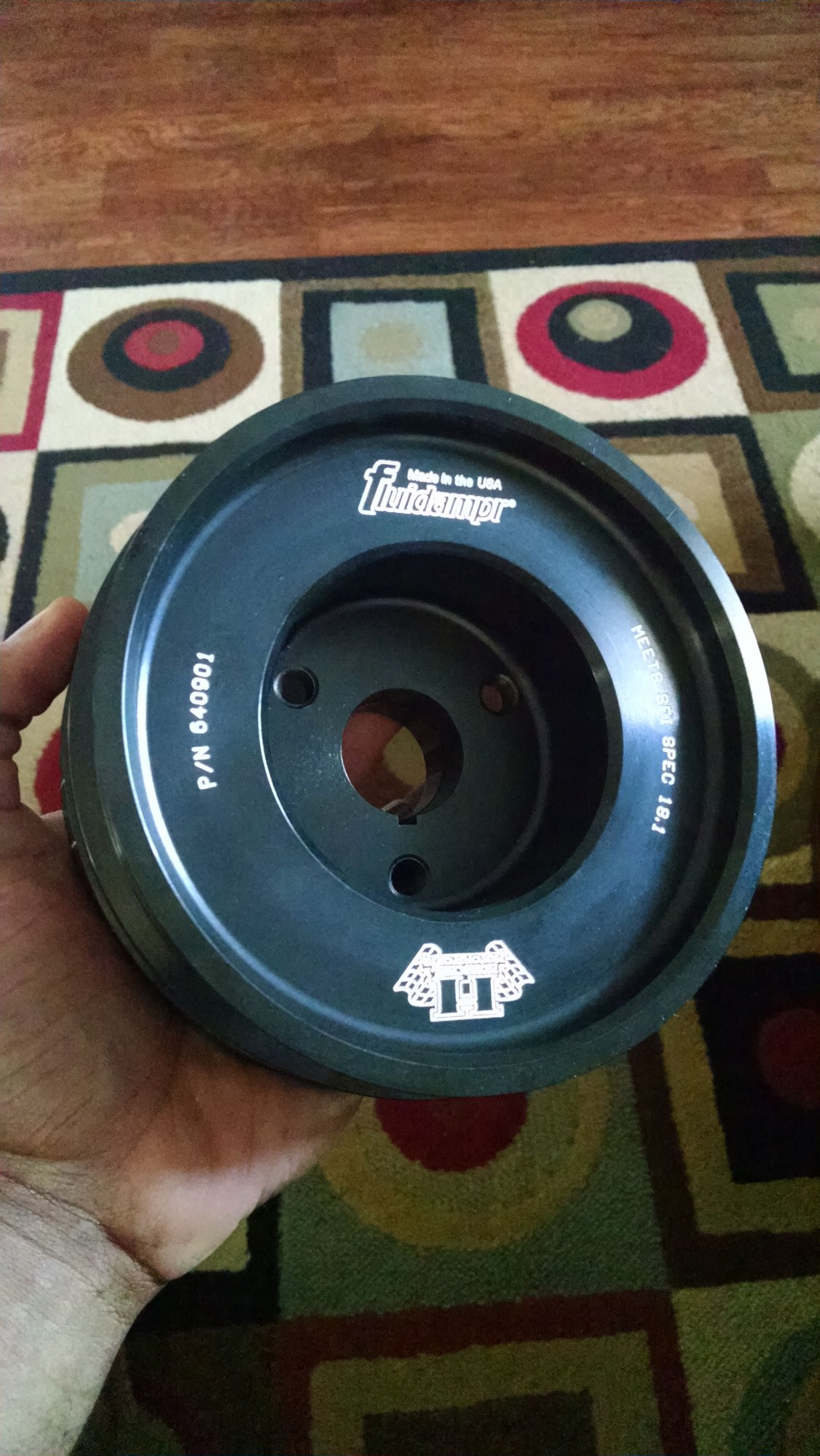

Fluidampr came in today. This big guy is pretty heavy! Will install this weekend and retune later on this month or early next.

Knocked out my Fluidampr Install today. Here are some comparison pics.
Ended up using the same belt I was using with the 3.12 pulley and Stillen Crank before, belt is a little more tight this time. Noticeable things I have seen is less vibration from the motor in the car and smoother idle, my idle before was jumpy. Ride is smoother. Didn't go WOT cause I was rushing home to help the wife. I will schedule a retune soon maybe next week or the week after.

Sounds like a great move to me! The Fluidampr self tunes itself to each vibration frequency from the motor. Its good insurance on your motor especially if you are making more power from FI which intensifies the torsional vibration under load and WOT.
