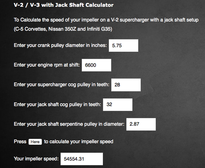

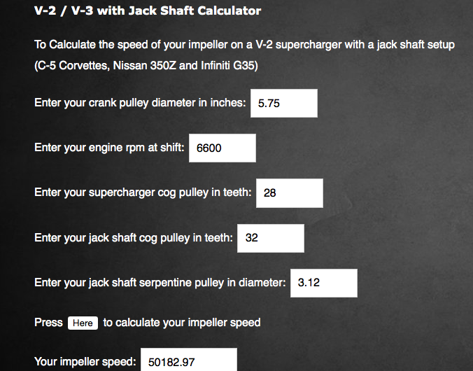

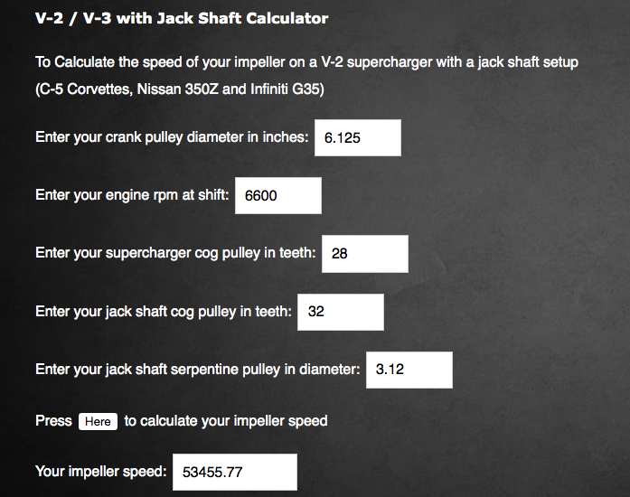

You should get rid of the light weight pulley ASAP.
I rev my Blower to 62,355rpm
I think you used the wrong calculator, your numbers are off.
I'm assuming you have a stock rev limiter? 6600rpm
I've shown different configurations below.
Originally Posted by NAbuilderZ33
Soo, I've been contemplating stepping up a pulley size from the 3.12 to the 2.87 for more Power. Ive come to the conclusion that although the 2.87 will give me even more power, the safer alternative to spin the blower faster would be an upgraded Crank pulley. I just bought a Fluidampr Street Crank Pulley with an outer diameter of 6.125 inches compared to the stock crank that is 5.75 inches. Upon using the calculater on the Vortech Site, I will be spinning the blower @ 46644 max with the Fluiddampr and 3.12 from the 43788 I am spinning now with my Stillen standard lightweight crank pulley and same pulley. Plus I will have the added benefit of having more safety due to the harmonic balancing the Fluidampr will produce at high rpm where I need it the most. It is 10.3 lbs, but I dont think the weight will be an issue when in boost.

You would gain power by raising your rev limiter to 7100rpm. And even more important you would gain tons of Drivability, makig it much easyer to stay off the rev limiter.

You are absolutely right i was using the 2nd calculator (V-2-V3 Calc). Thank you sir. The reason i dont rev to 7100 is because i was advised that I had to upgrade my oil pump. So i kept the 6600 redline due to this.
Yea, Ive been meaning to get the Stillen Light Crank removed but I sold my OEM one and was saving and got the Fluidampr, which is on its way now.
