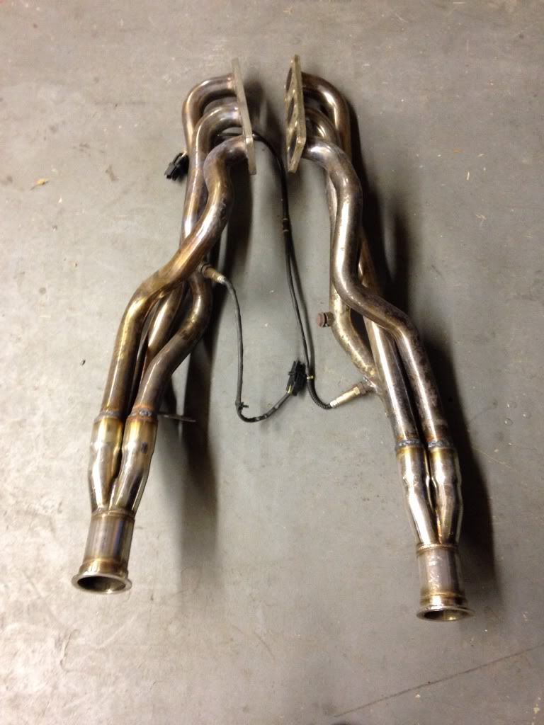

My exhaust setup had a weak spot which is the OEM HR headers i installed in combination with the Art Pipes. I have an old set of OBX-R Long tubes that have been just sitting here at my bud's house I uninstalled before boosting, The collectors are pretty much junk, but ive seen exhaust shops and read online people making custom collectors and venturi rings on a cheap pair before, Soo that would be a cheaper alternative to this. Still n the air if I will use them or not.
I did that before

My only complaint I wish I hadn't went with the v band. They are actually bigger than a bolt together collector flange. I knocked the clamp off a few times.

Originally Posted by 2bad240
I did that before
Very nice, Ray!
And thanks for the advice, i wont go the Vband clamp route. Im also gonna use header wrap to help keep the radiant heat from escaping the longtubes to heatsoak the motor.

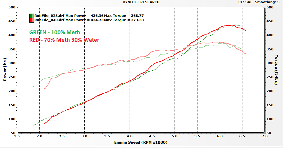

I'm also going to change my mixture with my Injection kit instead of straight 100% Meth, I'm going 30/70 Water-Meth as water will help increase the cooling further in the combustion chambers and slow the burn speed of the flame during the power stroke.
Just keep in mind a 30/70 mix by volume is more than 30% water! Methanol is tricky stuff to mix with.
Thanks, Resmarted. I am aware. I haven't mixed it yet cause im still on duty, was gonna do it tonight or tomorrow morning. Might end up using less water then, maybe 20/80 water-meth mix.
It's weird how mixing fluids works... especially methanol. The problem isn't so much what initially the mix is, so much as having a consistent mix down the road lol. So just try to leave a bit of margin in afr for that. A little rich (point or two extra) will be fine. Don't worry about "leaving room" in the timing though; if your next mix has more water, you'll actually want a bit more timing.
Overall though, as long as you don't rely on the water meth too much it really won't matter much.

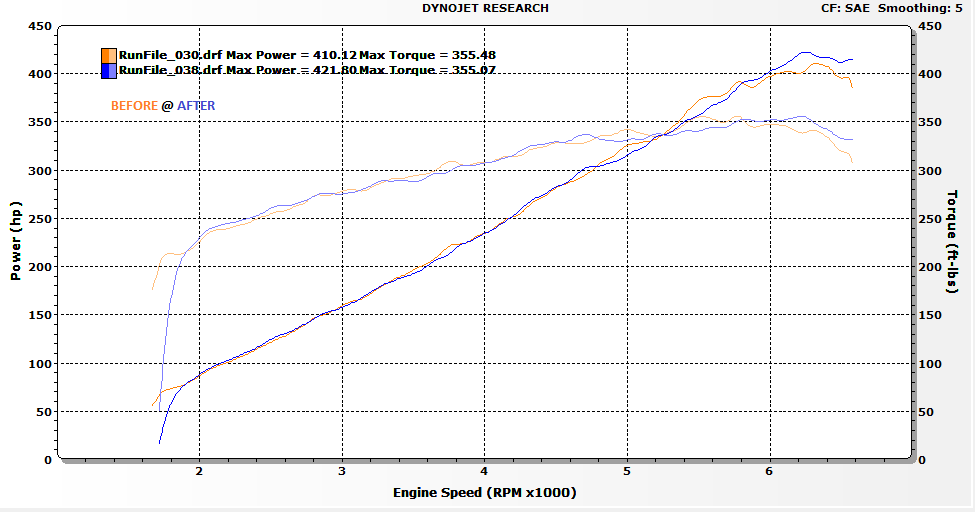

Soo a bit disappointing yesterday, Weak part of my build during Dynoday yesterday was the clutch, The Z1 "Mild Performance" Clutch is only rated at 350 wheel torque and it started to slip on me during the meth injection tune past 375tq.
With the Pump only tune we put down a conservative 421whp-355tq. 11.3 AFR.
With the Meth map, my numbers were relatively the same 435tq-373tq, 12.2 AFR, No knock! However on the dyno sheet, after about 3500 rpm, my gains in the powerband were from 5-20whp and tq with a sacrificed peak HP due to the slipping clutch, So we had to retard a bit of timing to keep the car within the limits of the clutch. This time around, my mixture was 70 percent Methanol and 30 percent distilled water by volume.
This is all I will be doing for now till I move to Texas. I made sure I asked a lot of questions to understand why Seth did what he did to the maps and challenged myself understanding further that what I did know beforehand. In the mean time, I will be getting used to the Osiris Tuner Software, practicing data logging a monitoring the cars performance.
