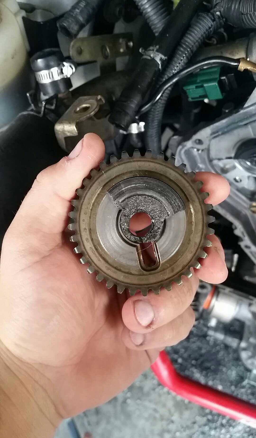

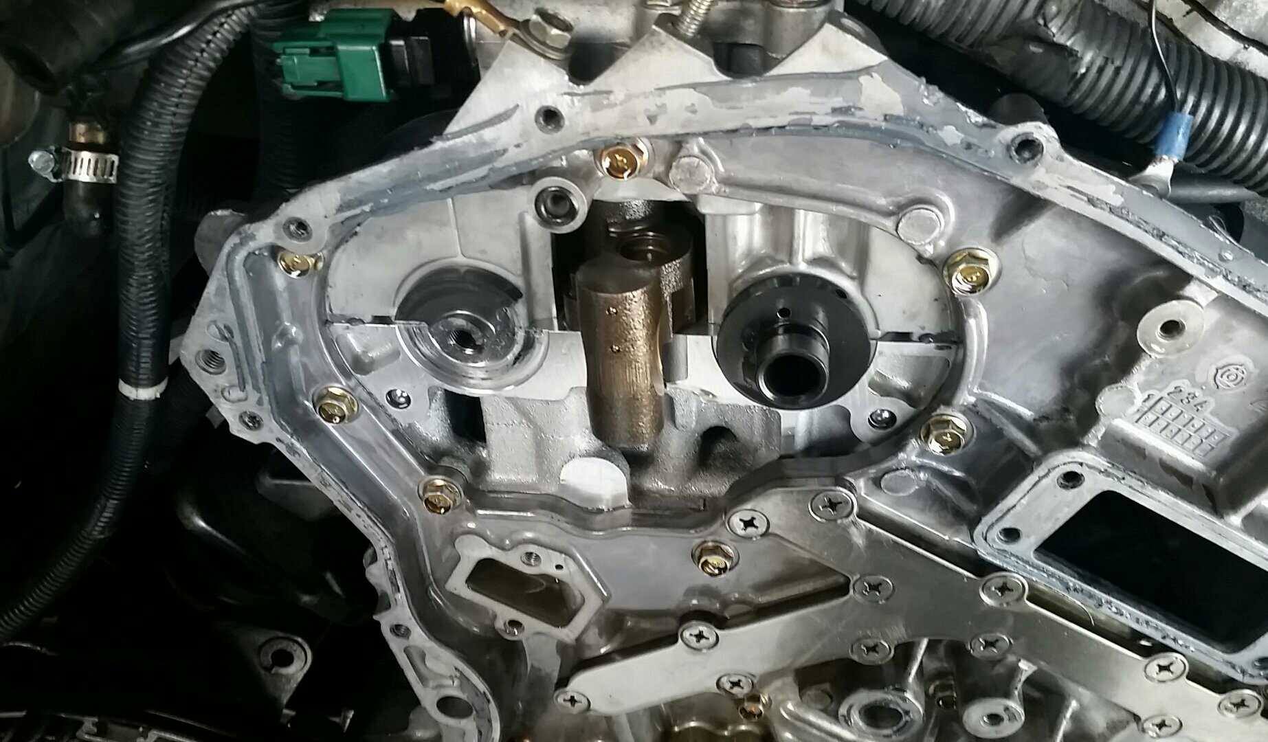

Motor may be F'd, Not sure what happened, but may have bent valves, messed up pistons sky is the limit.
Damn that's savage.
Well hopefully the head took the brunt of the beating. Inspect the cylinders and if there isn't too much scarring just re use the short block. There is a chance that some debris got into the lower end, but considering the engine didn't see any load, it could be salvage-able. A little blow by never killed anyone. Might hurt power a tiny bit, but could still last quite a while and give you good fun in the mean time.
I think it would be worth trying again with just another OEM head, maybe just stock cams all around, bolted up to the rest of the motor you have now provided you don't have a hole in a piston. Vq35de heads are actually pretty cheap.
What were the symptoms you had? Engine wouldn't run unless you put it to wot? And it stopped cranking over?
Thanks for sharing with us. Keep your chin up, chances are you might not be in as deep as you think.

So when I first started the car it fired up right away but I had to shut it down since I smelled antifreeze and it was smoking so I shut it off to investigate. Started it back up it started up right away again but still smoked so I shut it down again and realized it was the coolant I spilled on the headers. So I tired fired it up again to let it warm up and try to break in the cams but it was a little hesitant this time, but it fired up and I let it run at 2k for 30-45 seconds with the laptop hooked up and noticed the big big difference between the two banks A/F Ratio so I shut it down. Untill I could do a little digging to ensure everything was hooked up correctly.
After I verified it was hooked up I tried to start it with now luck until is held the throttle wide open. I tired this a few times I finally said F it and looked at the cams and crank to look their postions that's when I noticed that bank 2 (Driver side?) was off so decided to pull the front timing cover and found the carnage.....
So I just used my crappy crappy camera to take some videos of my #1 bank (Passenger Side?) to see if I could see if I had any marks but I didn't see anything.
This one looks bad, like its seen a lot of detonation but I think that's just the camera need to find a better one to redo it.
They all seem to have some signs of detonation I'm just hoping its the camera and not actuall detonation since the motor has less than 500 miles on it non of which have been hard. Its only seen 5k a few times.
