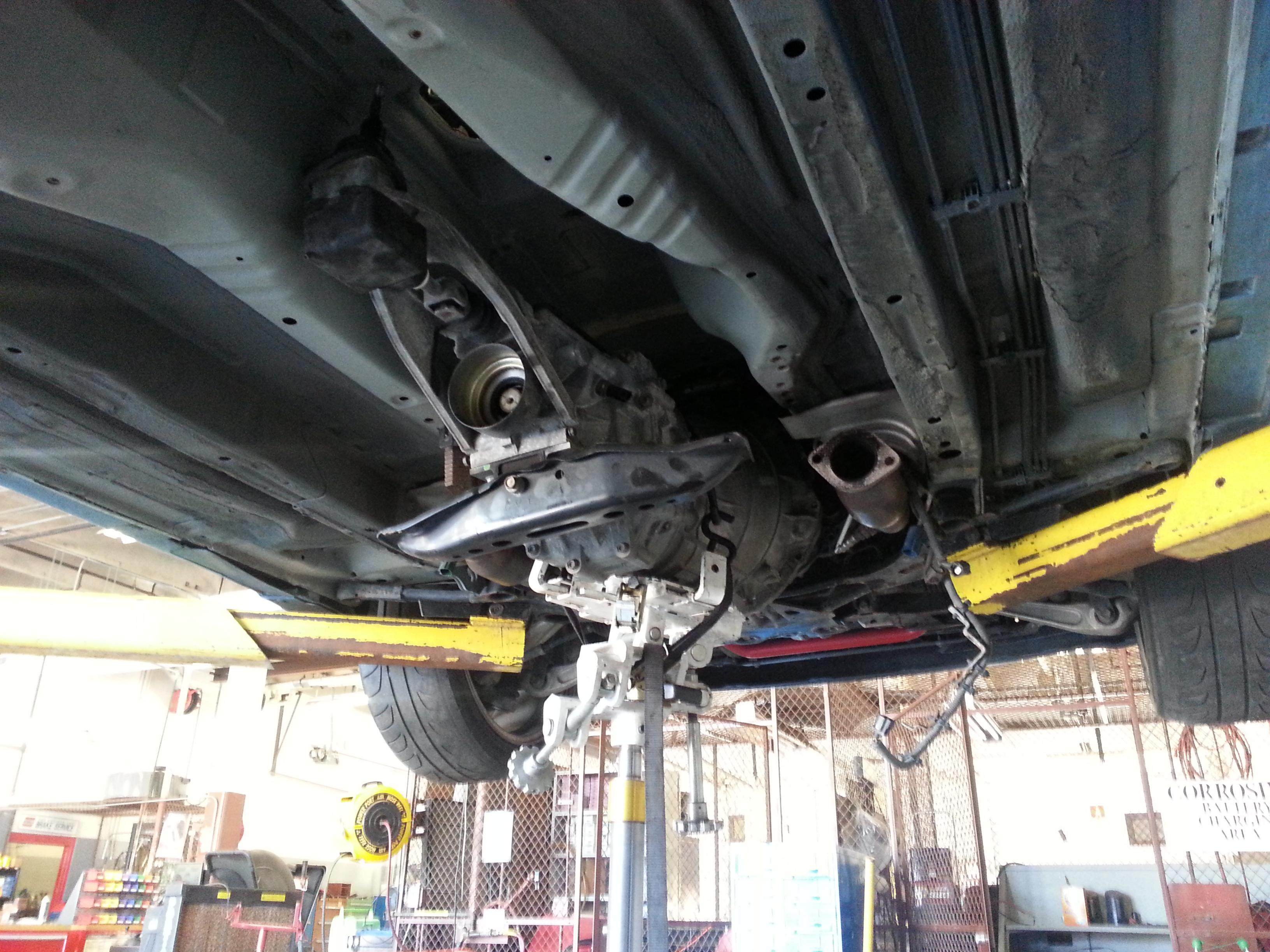

Today I removed my transmission and managed to install my JWT Flywheel. I'm doing all the work here on the base and they close down the shop at 4PM so i only get from 8AM-4PM to work on it.

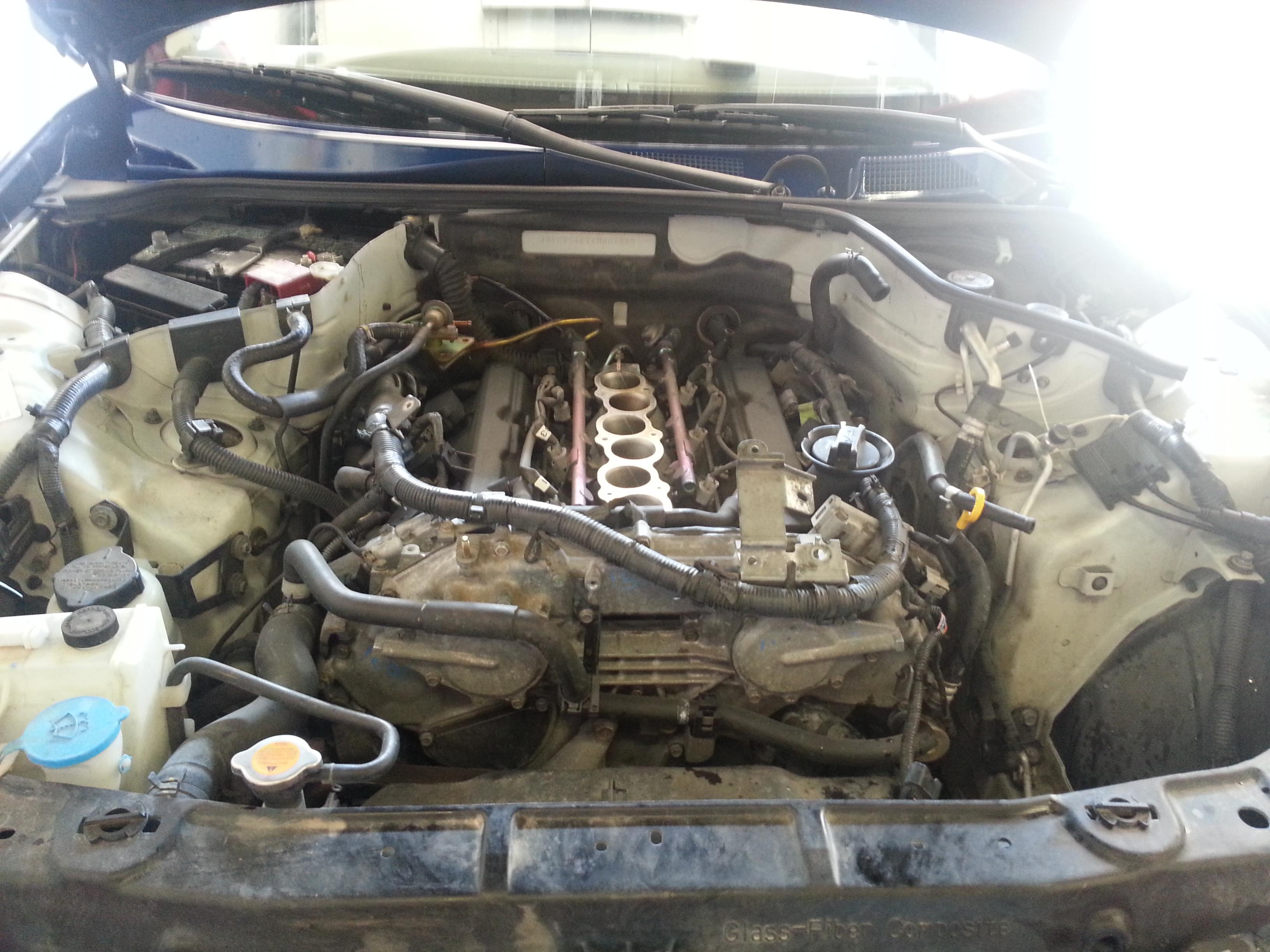

Just a quick peak underneath the car.
Got the transmission removed.

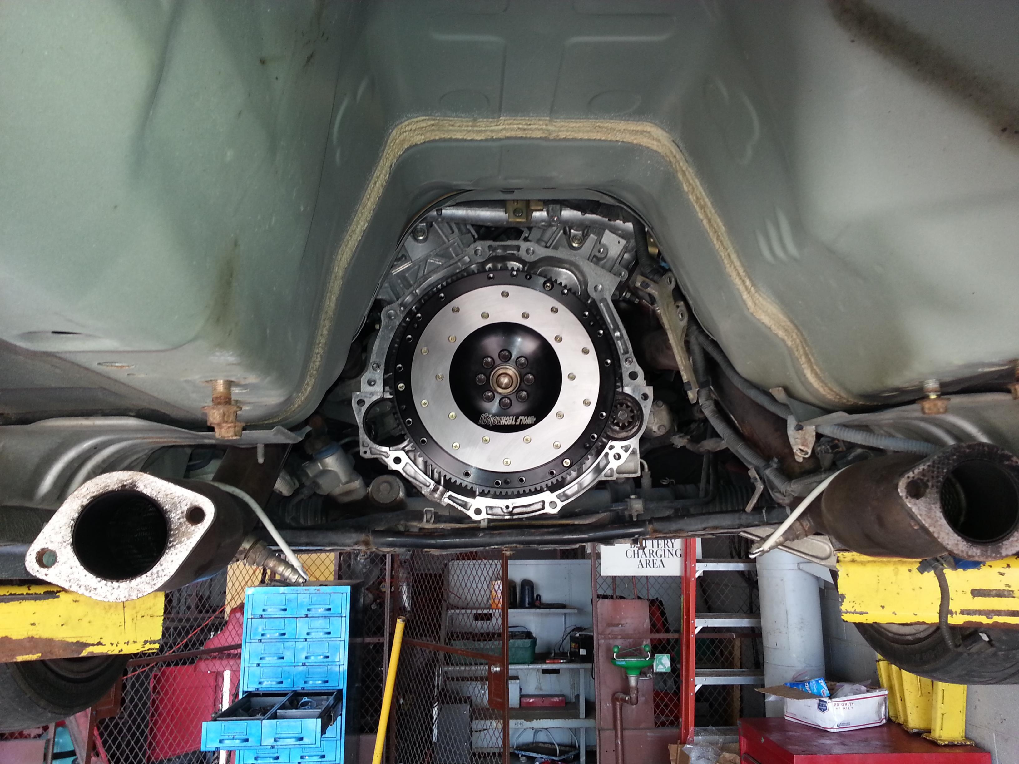

This is where i managed to get to. Had to start to clean up.
Tomorrow going to try to button up the clutch/flywheel install then start working on the FRS if time permits.

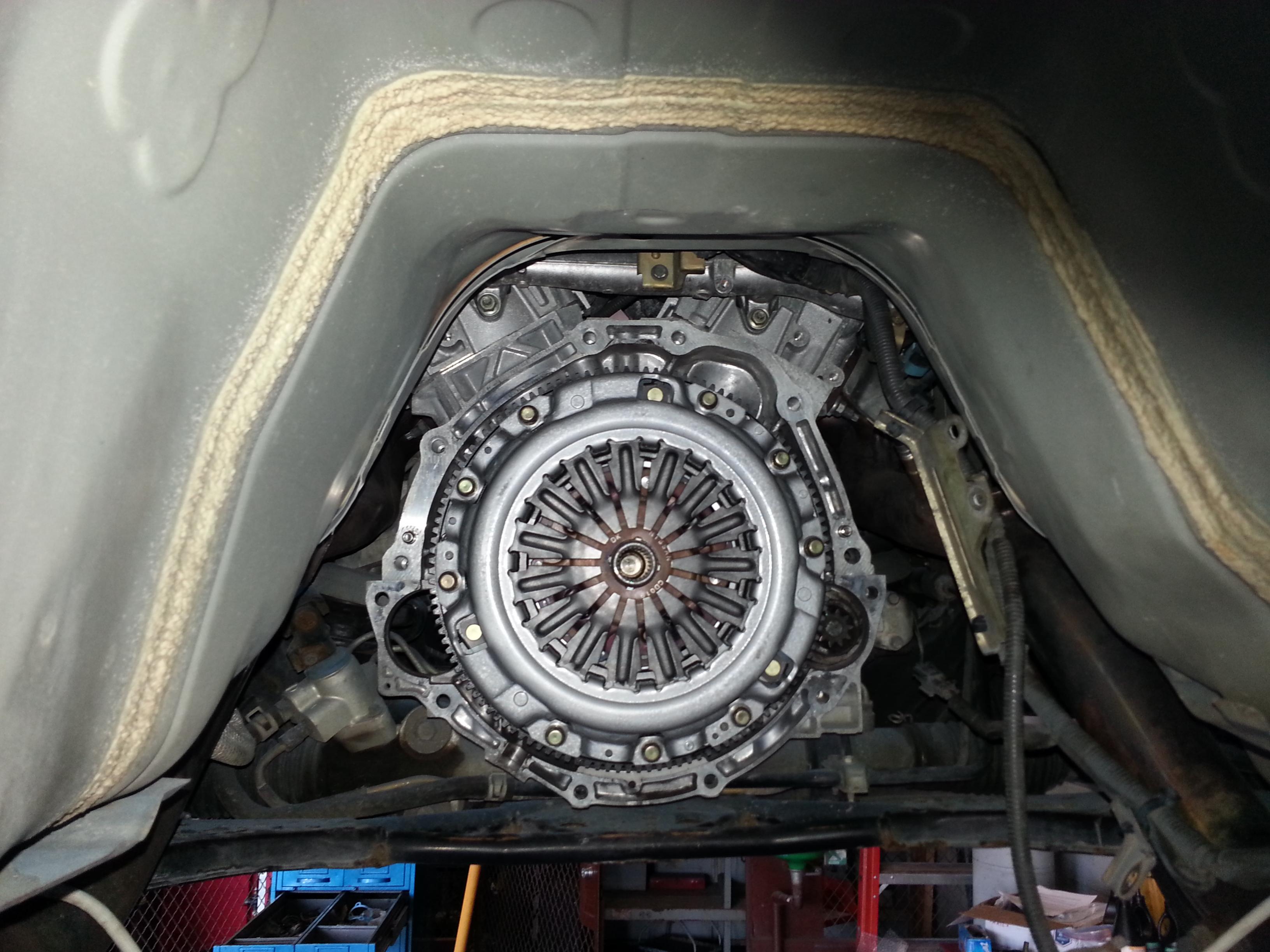

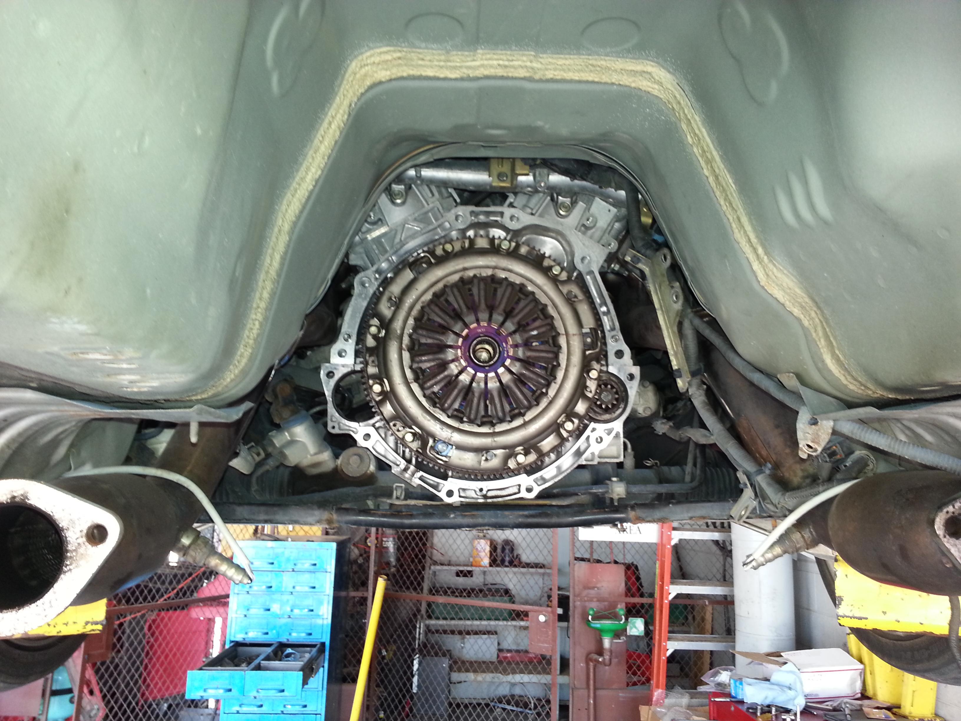

So today finished installing the clutch and and reinstalled the exhaust. The funny thing is, the clutch is easier to push in then it was with the old one.

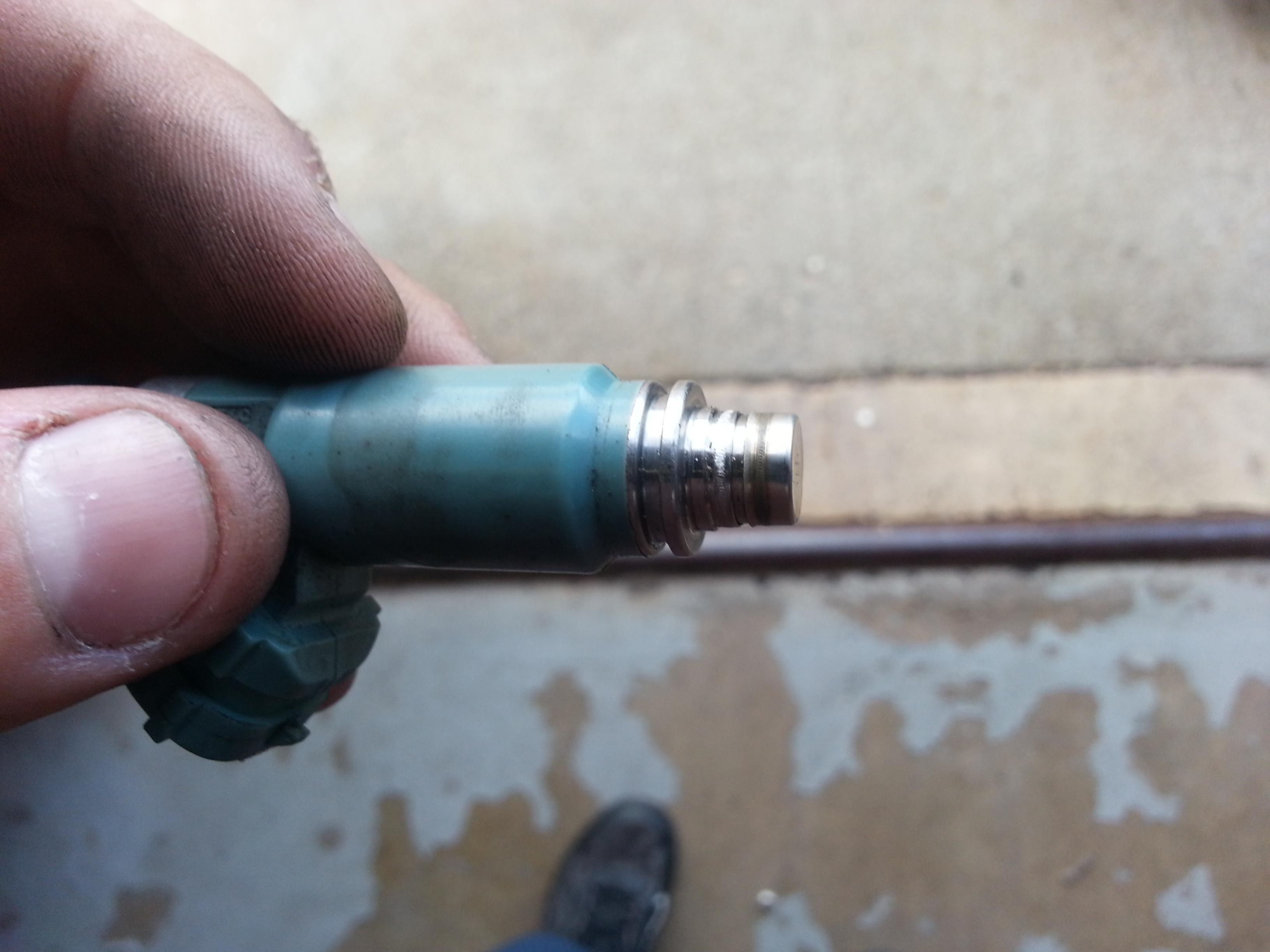

For the most part i've been lucky with the parts. So I just ended up using the bottom O ring off of the stock fuel injectors on the new to me DW 440'S. I hope these are big enough for 400 whp on pump gas. I also got the fuel send portion of my frs complied with. Got my new fuel pump in the basket and the holes drilled for the cjm correction kit.

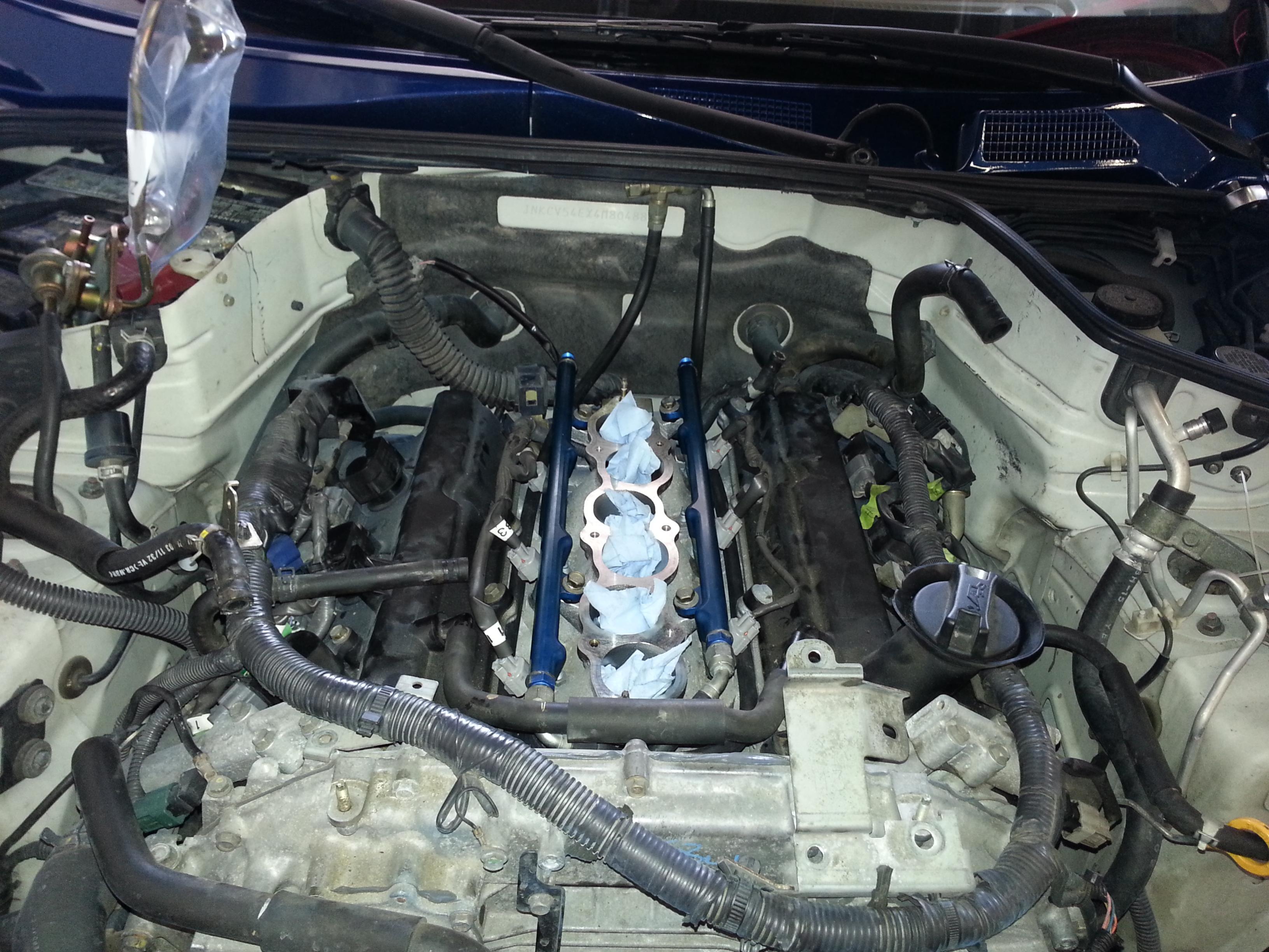

Here is the Fuel Injector delima i ran into.
There is no O-Ring on the bottom, so i just used my stock one's and i'm hoping for the best

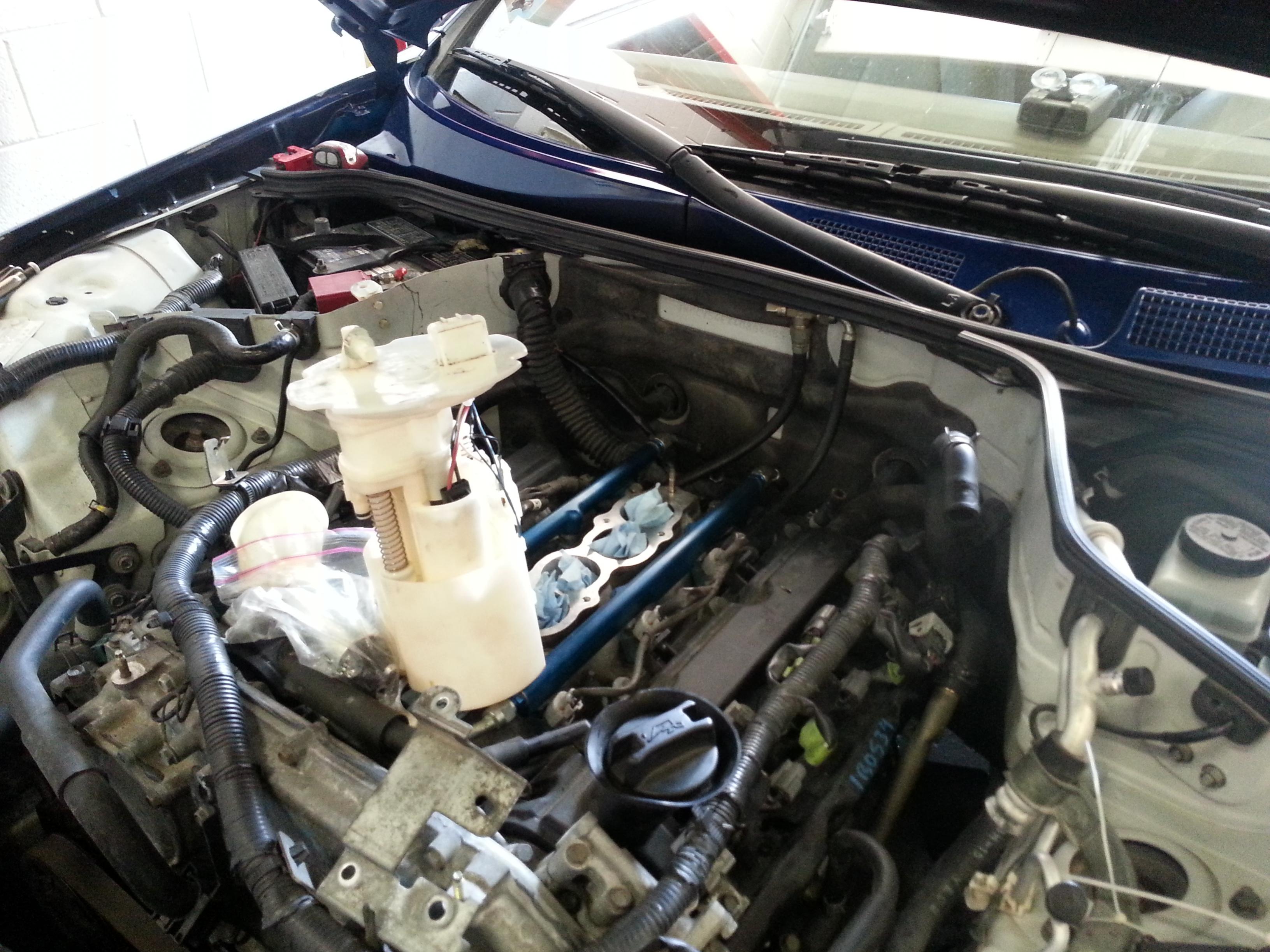

Got the fuel injectors and Fuel Rail installed with the Fuel return routed to where the Fuel Pressure Regulator is going to be.

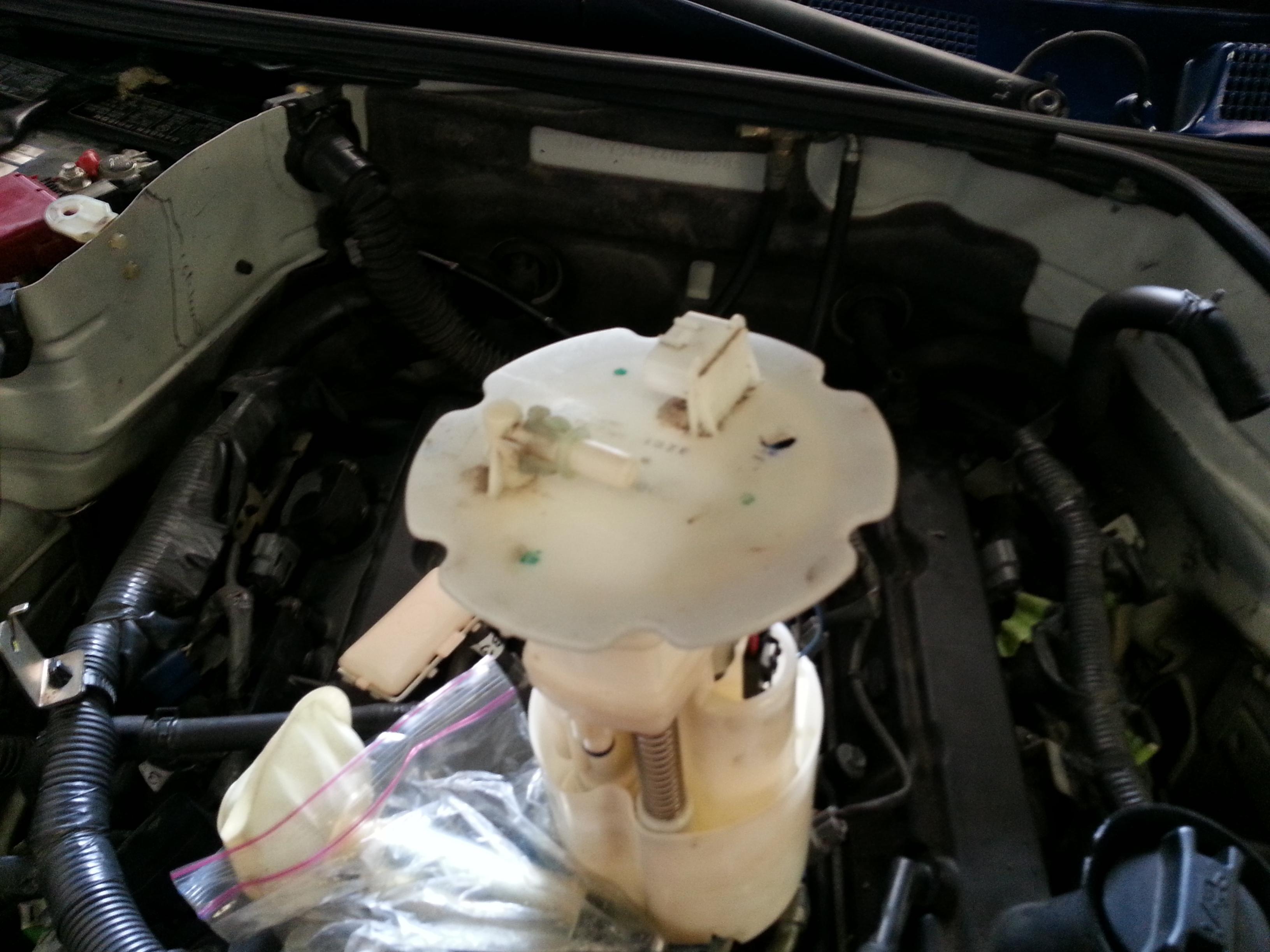

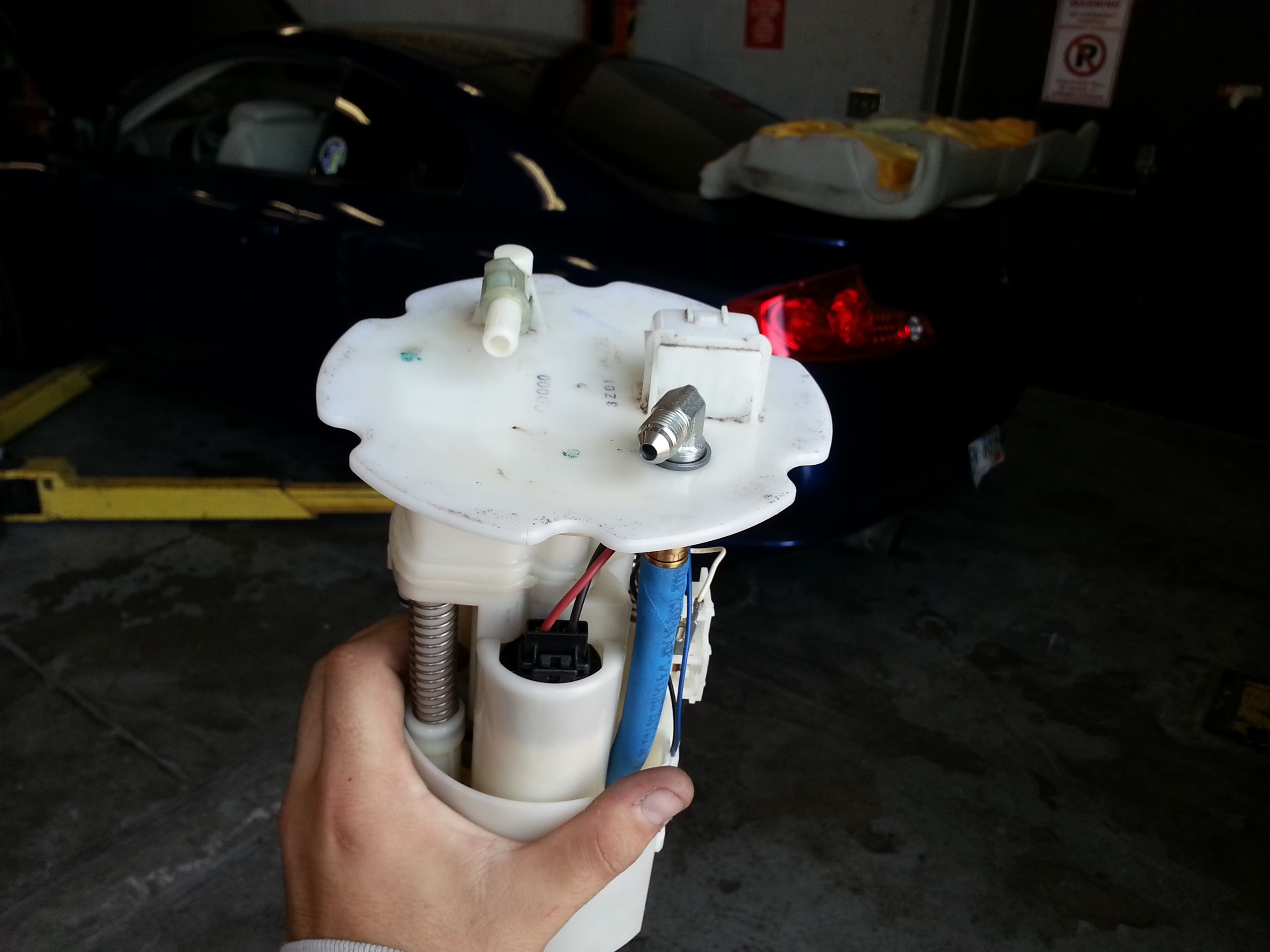

End of the day, got the Fuel Send portion of the FRS completed. Fuel Basket setting on the Engine waiting on the Fuel Corrections kits which was left at the house FML!

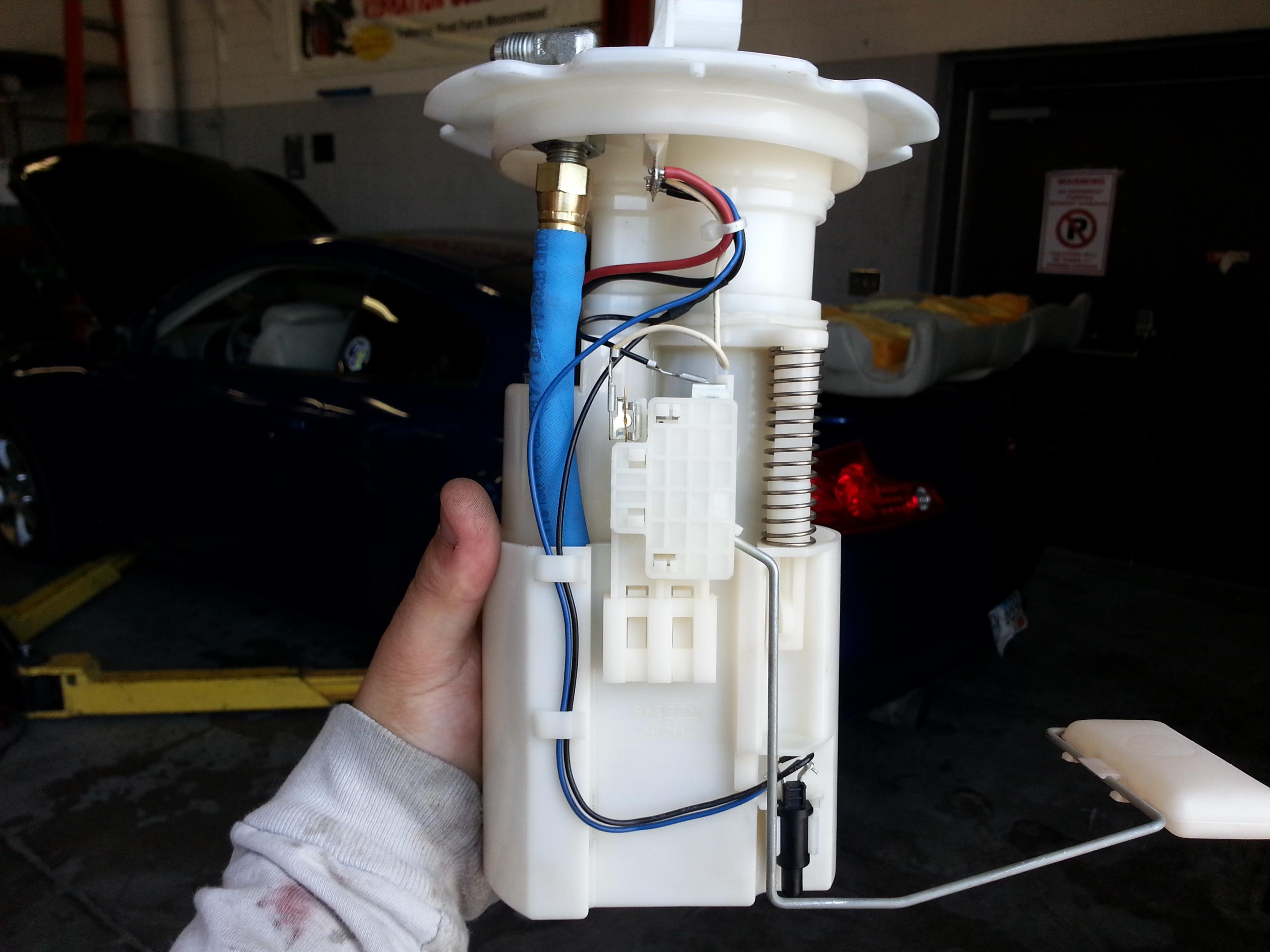

Well today was just a disappointing as yesterday. All that i got accomplished was Fuel Corrections Kit and Fuel Pump Installed in Fuel basket and the Basket reinstalled back into the car, Fuel Pressure Regulator Mounted and hooked up, Fuel Return Lines hooked up and semi routed and added a new one of kind spoiler to the car.
Fuel Basket with Corrections kit and Pump installed
Fuel Basket installed back into the car
Fuel Pressure Regulator Mounted and Hooked up

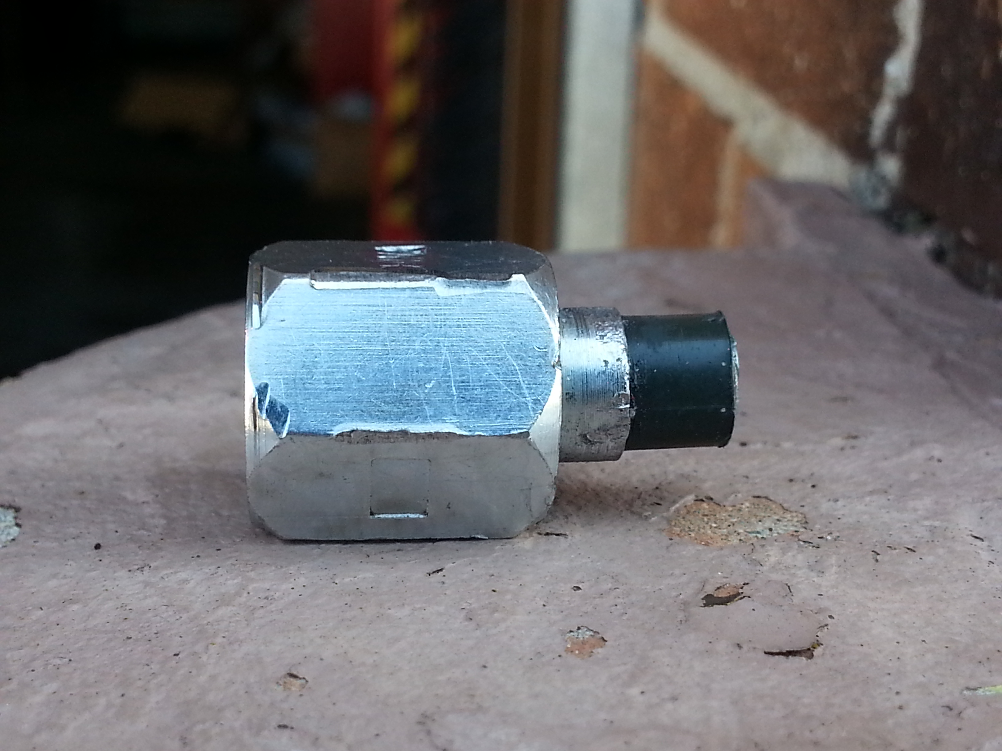

First 5/16" to -5 AN fitting This one started leaking behind the fitting.
So i had to remove this one and attach a second one which worked great until i moved it for clearance issues then i came off the Hardline now need to find another one. Third times a charm right???

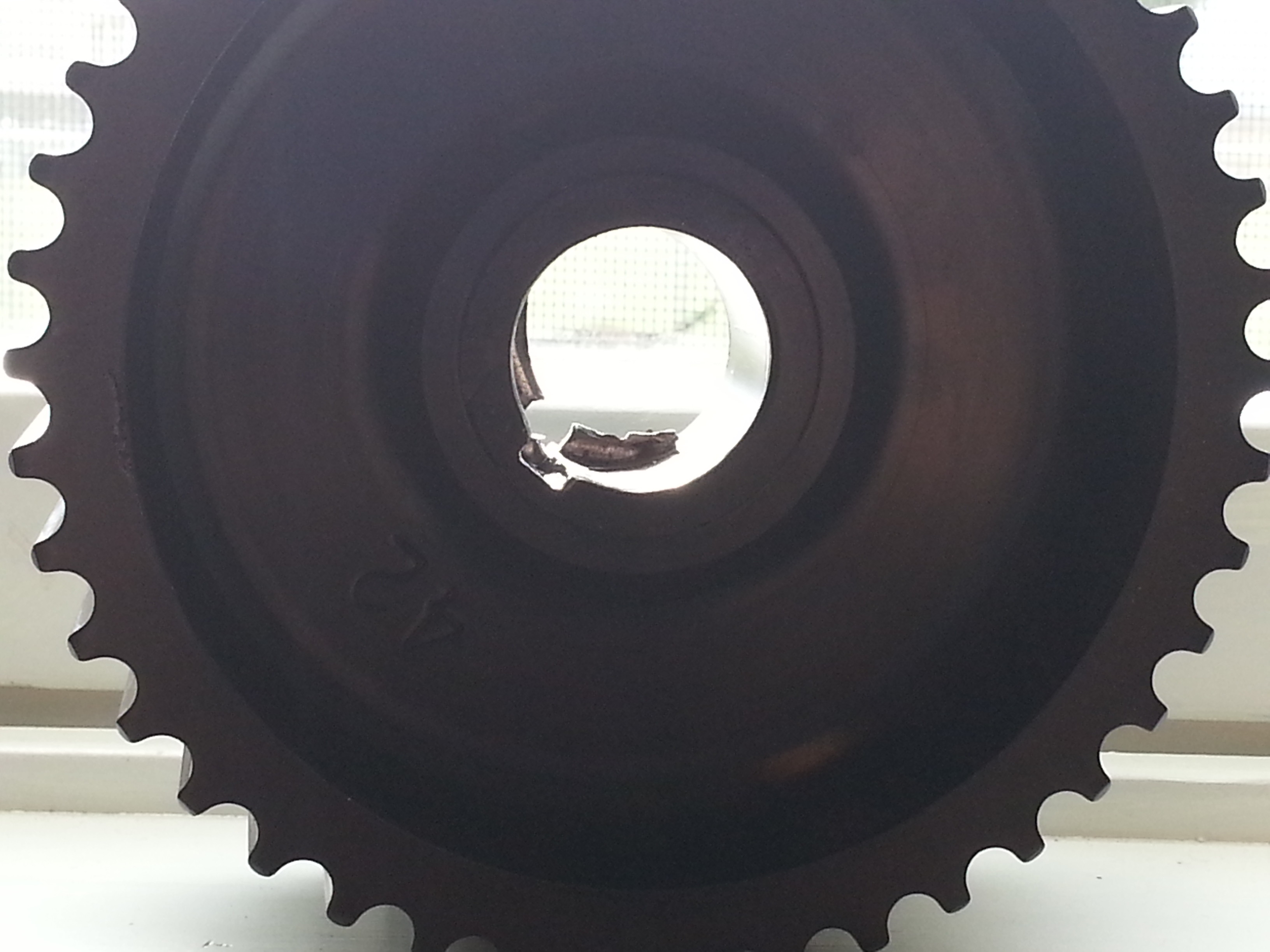

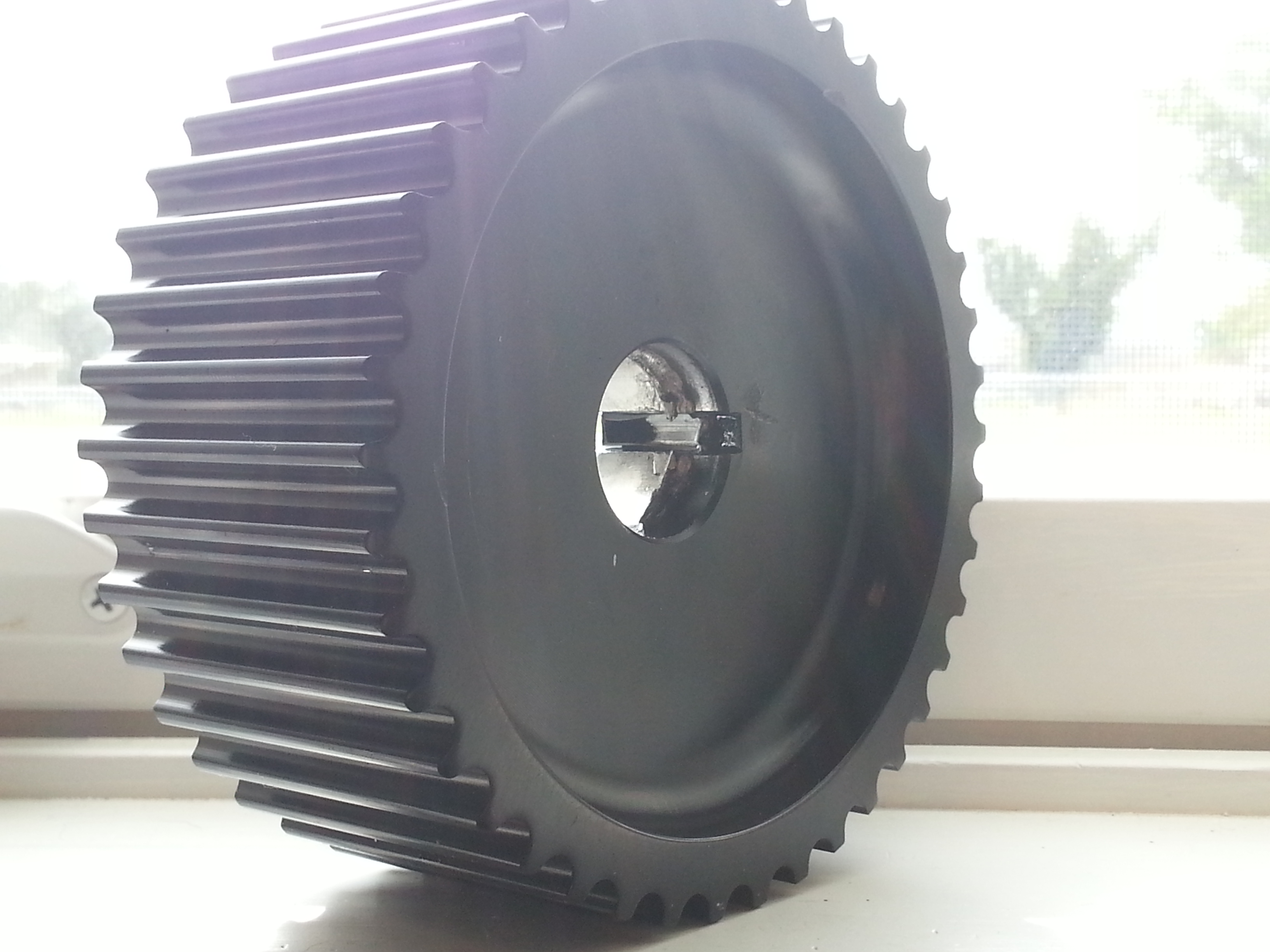

Well today start off very good, got the fuel system all figured out and got the car running. Once i had that all squared away i started working on my supercharger. I bought 42 and 24 teeth pulleys to replace the stock 38-27's. I tried to get the 27 tooth off and couldn't so i pressed on and took the 38 off and went to put the 42 on but it was stuck so i put it in a press to put it on "HUGE MISTAKE" it moved a little bit but not enough so i went to a local machine shop to have them removed the 27 and put the 24 on and try to take the 42 off and reseat it. Long story short i put the 42 on backwards and when they tried to put it on and it caught and messed it up more.
I believe if i had a CNC machine here localy they could fix it since its not "that" bad.

Well with the help of a dremel, File, and a over set to 350* I saved my 42 tooth cog pulley. So starting tomorrow i should be able to start working on her again.
