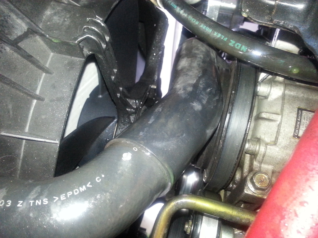

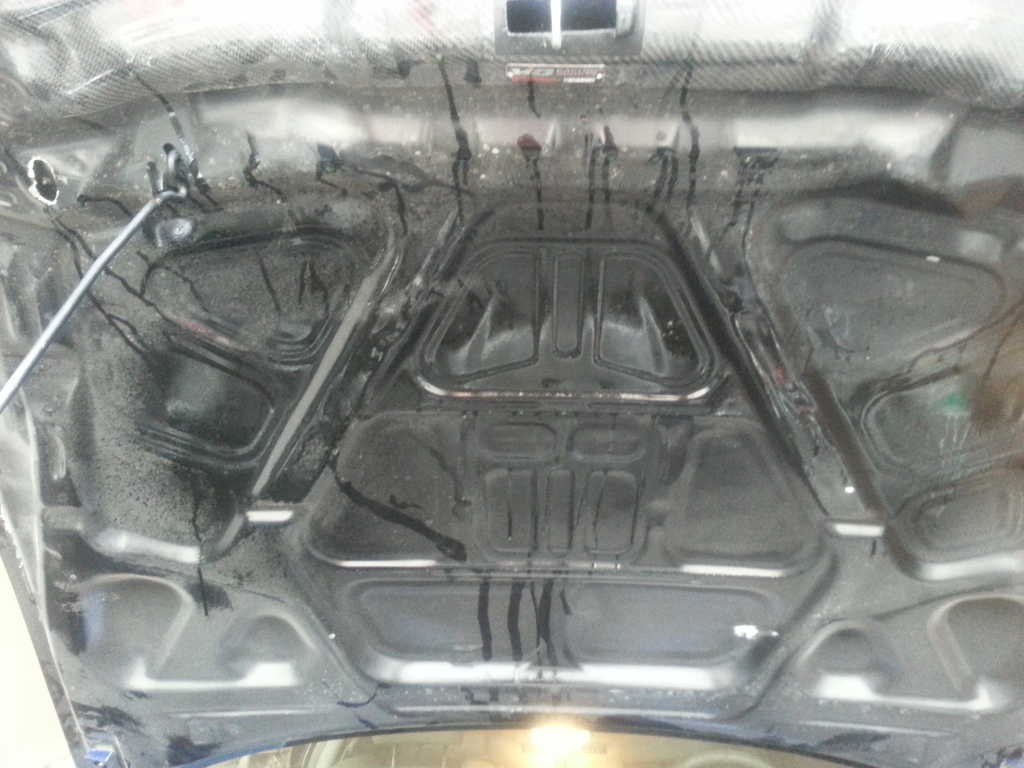

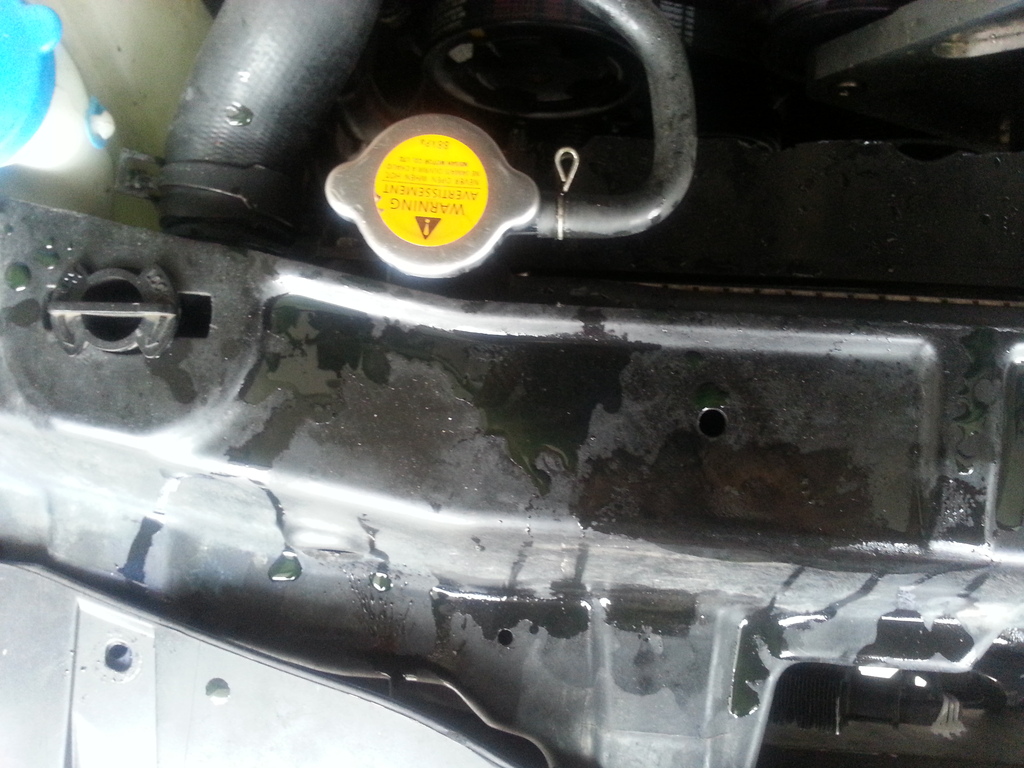

Well is truly showing me how much she loves me...

As you can see my lower radiator hose is/was rubbing my A/C compressor and ate up my hose. Good thing I was on base and was able to limp it home.

same thing happened to me when i put the bottom radiator hose in upside-down. Yes There is a top and bottom for that hose, and if its on the wrong way, the curve touches the pulley.

Thats what i think I did.
