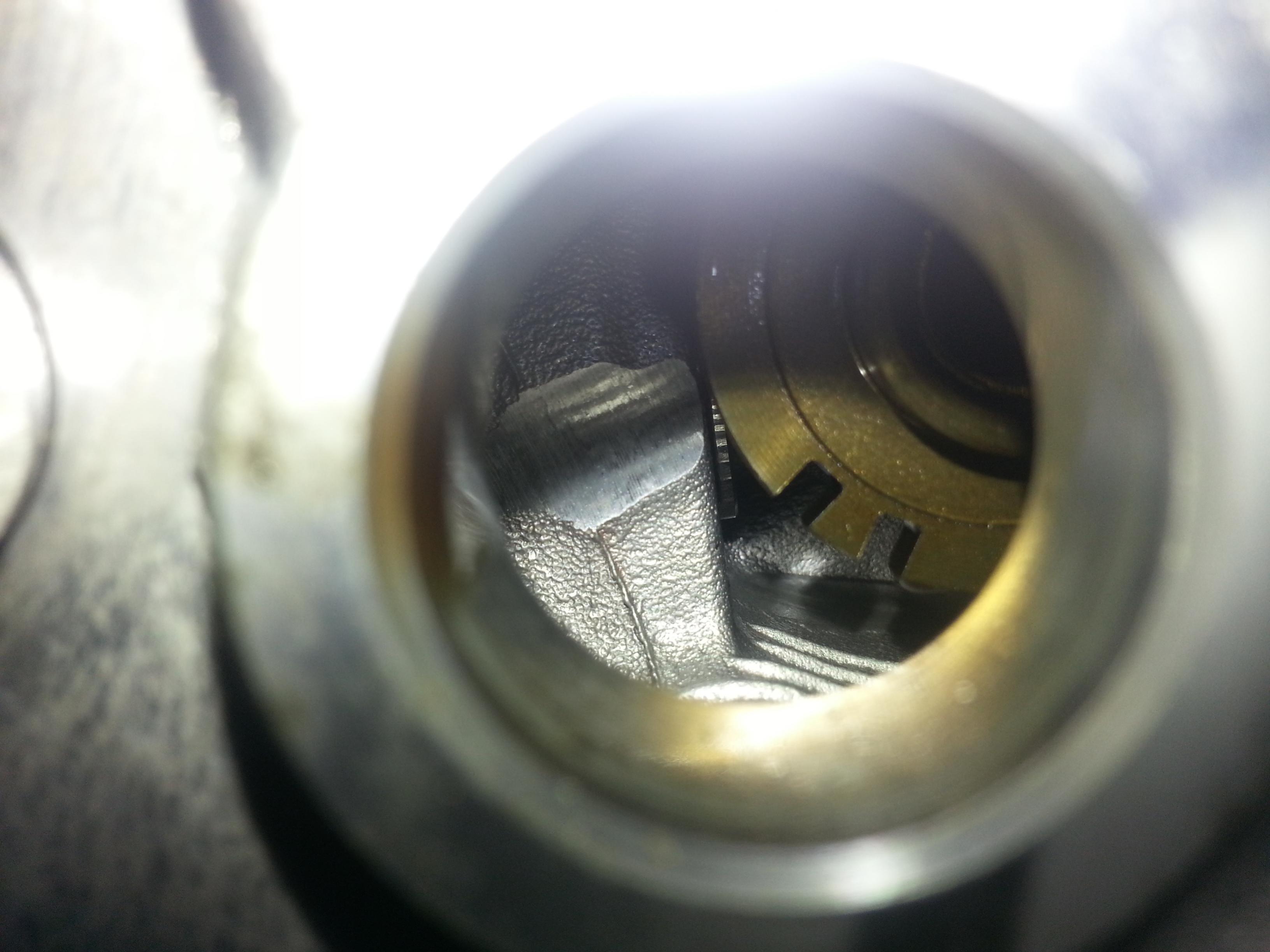

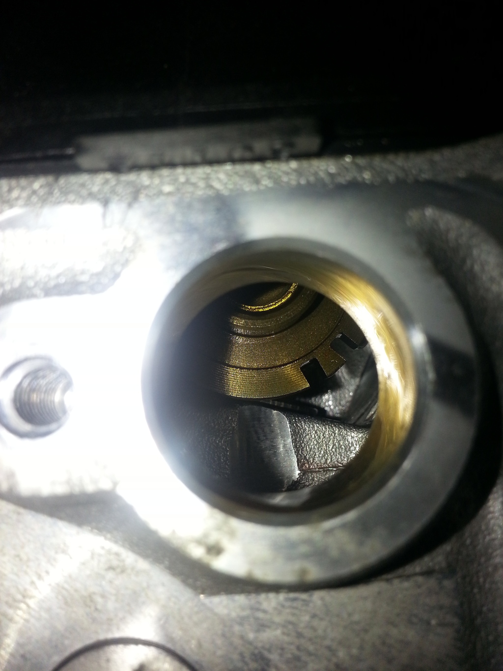

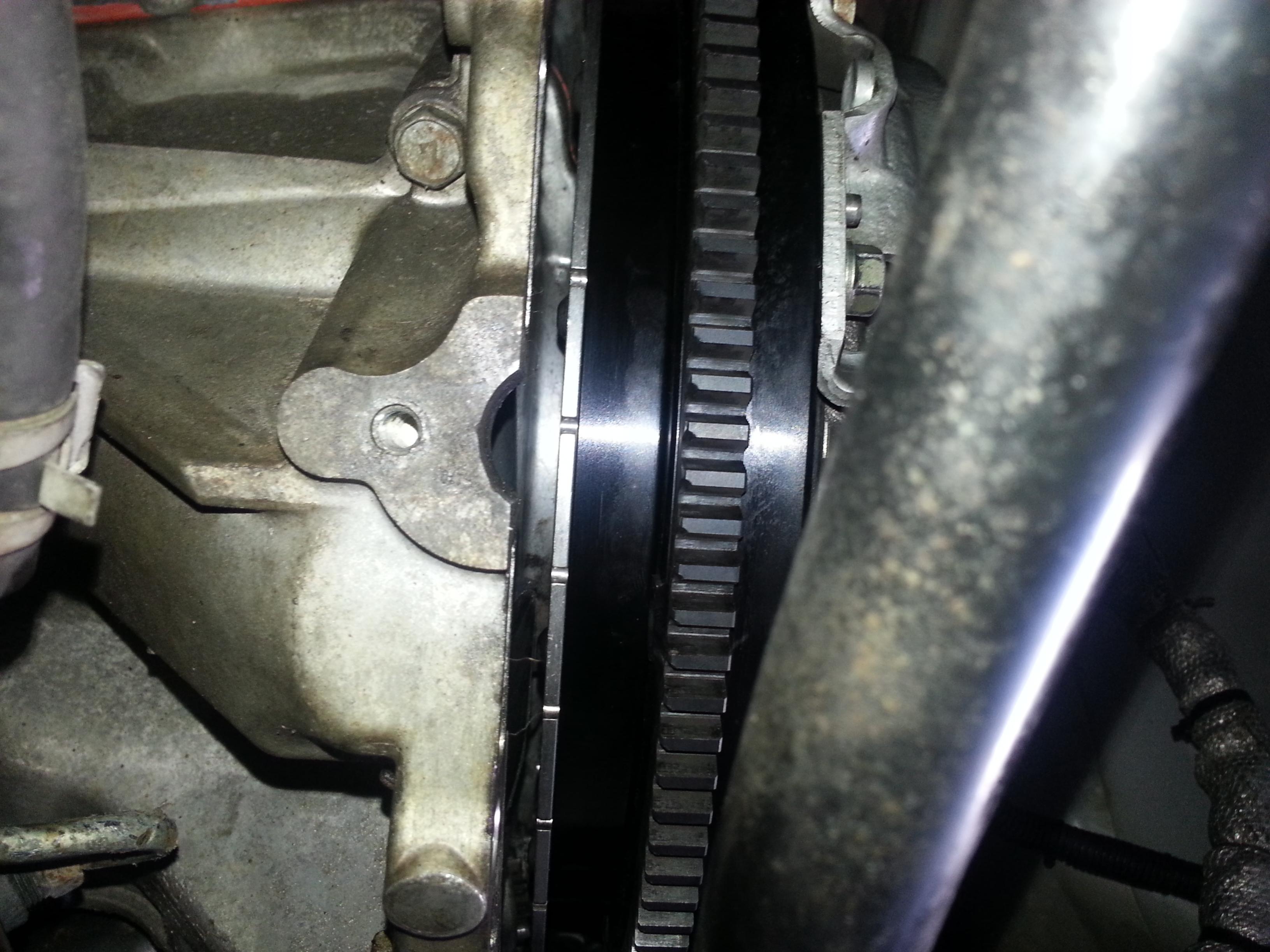

So after talking with Soho motorsports and doing a little testing it appears that the motor is in time but the flywheel isn't. The car is running 30* timing at idle where it should only be running 15* or so they had me remove timing in uprev and see if the car responded and It did so that was a good sign so they had me look at Jim Wolf Technology's website and they have a pdf file on what the cams and flywheel are supposed to look like so I did it and the fly wheel don't match.
Here is what they are supposed to look like
http://www.jimwolftechnology.com/wol...tion_check.pdf
This is mine
Bank 1
Bank 2
Flywheel
So looks like I'm going to be taking the car to the hobby shop and removing the transmission this weekend. **** doing that in the garage!!!
I'm hoping this fixes my problems then I also need to remove a ton of timing from my entire map.

the flywheel is keyed for front (altima) or rear (350z). they should be clearly marked so hard to mess up
Old Apr 30, 2015 | 05:52 PM
  #293
Conway_160's Avatar
Conway_160
Joined: Dec 2012
Posts: 2,593
Likes: 357
From: Pan Handle
I, know that's why im so confused but better safe than sorry. When I put it together I used the marks on the flywheel and crank. But then again I thought I timed the car correctly the first time and I was wrong on that one as well.

Well today sucked! I was hoping to find the root of all my problems but really I discovered I installed the flywheel correctly and that these new headers make putting the transmission in a F'ing nightmare!
Bank 1
Bank 2
Flywheel
So tomorrow I get to reassemble everything and see what happens, also I bled my clutch with a vacuum pump and I still only have 3-4" of area that feels like I have pressure "Never should have remove the rubber line!!!!"
