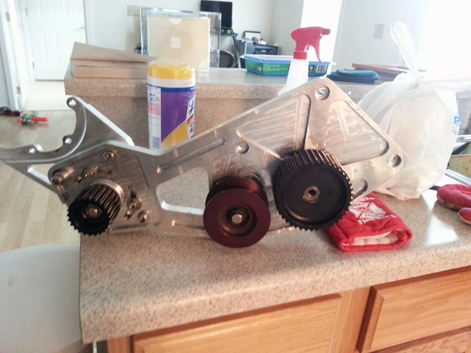

Well with the help of a dremel, File, and a over set to 350* I saved my 42 tooth cog pulley. So starting tomorrow i should be able to start working on her again.

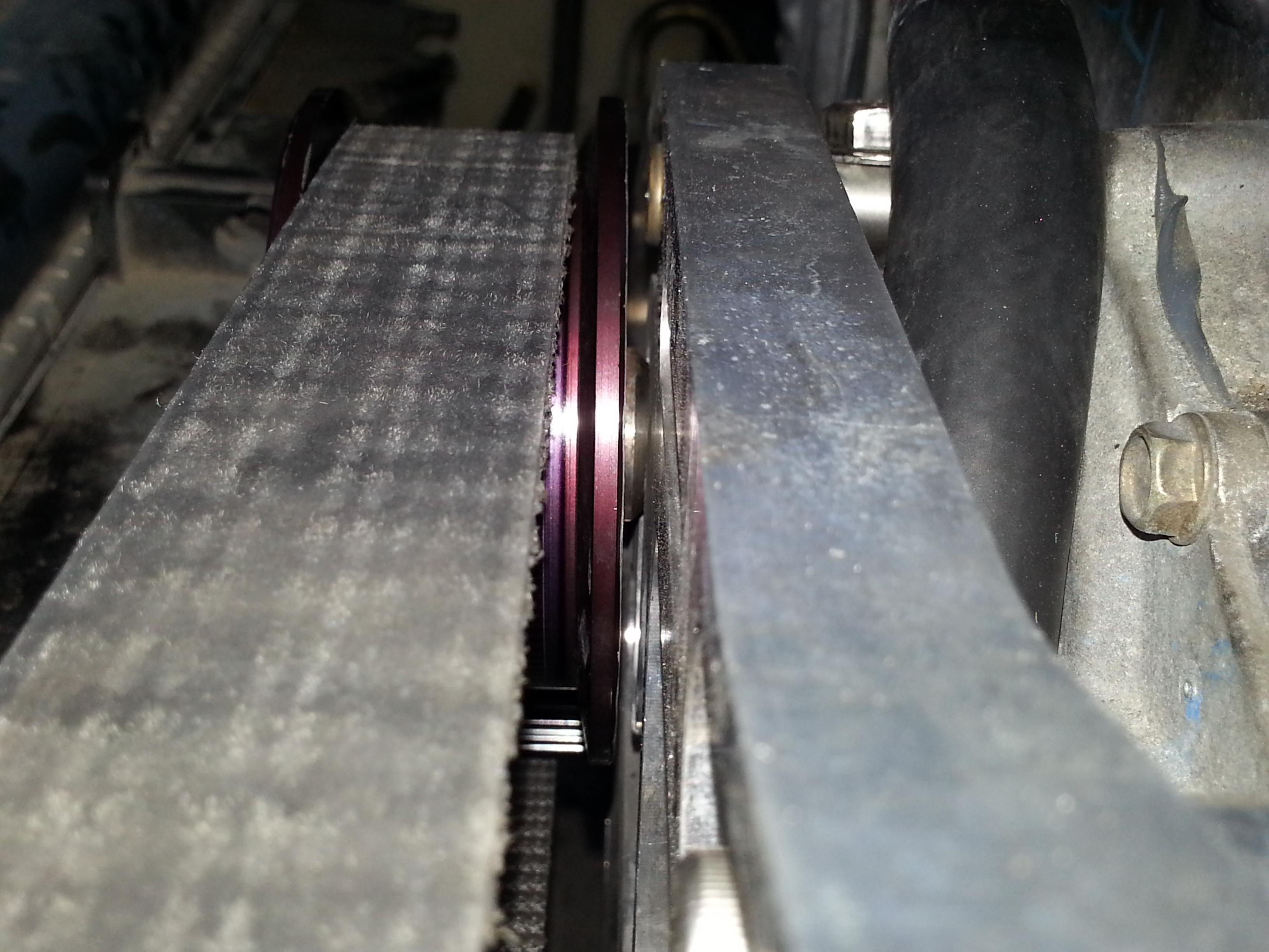

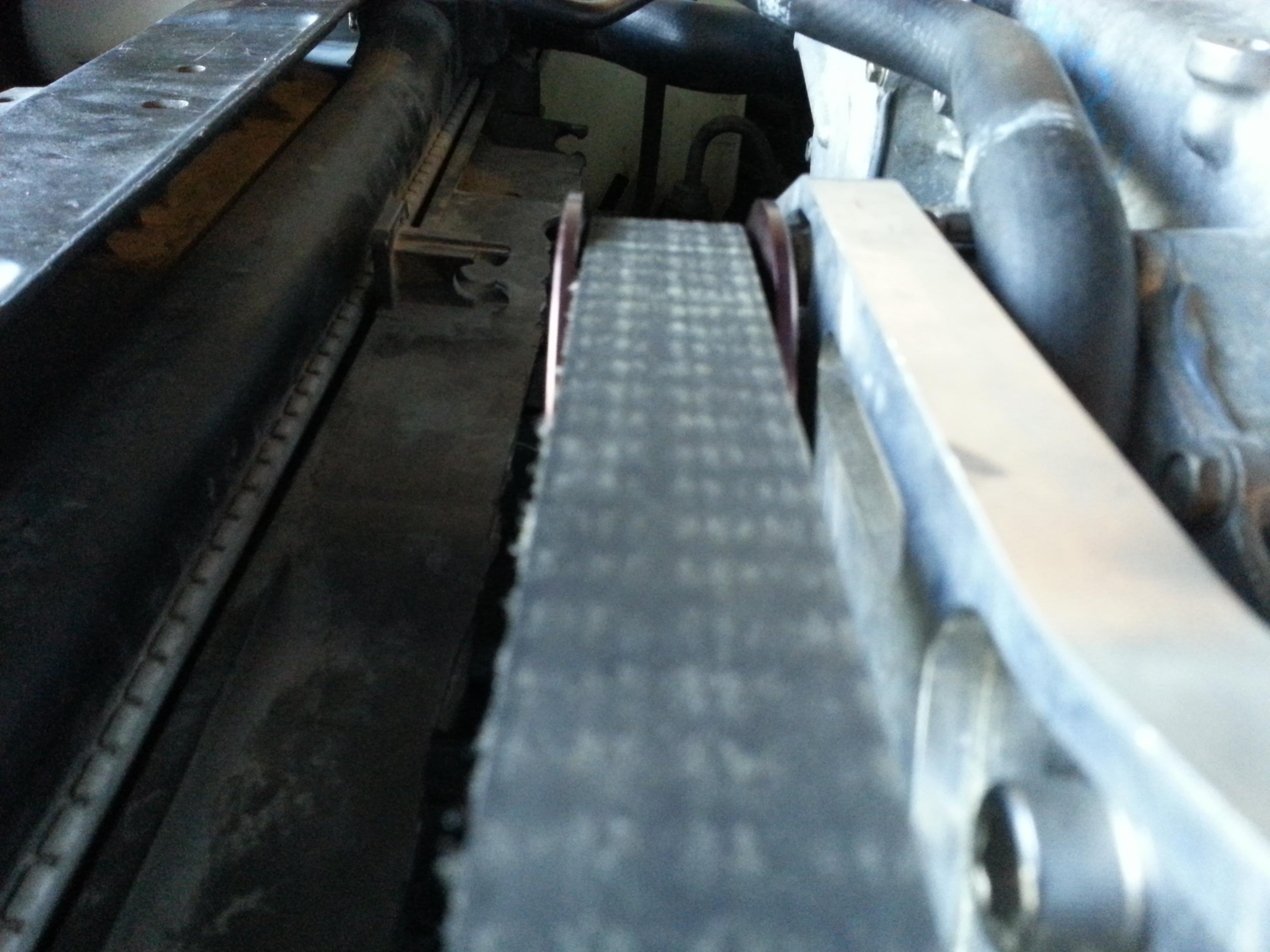

Well the car runs and drives..need to button up the intercooler mounting and the stupid power steering cooler...Biggest issue im having is the belt is not riding in the middle of the pulleys and rubbing on the idler pulley wich is pissing me off!
