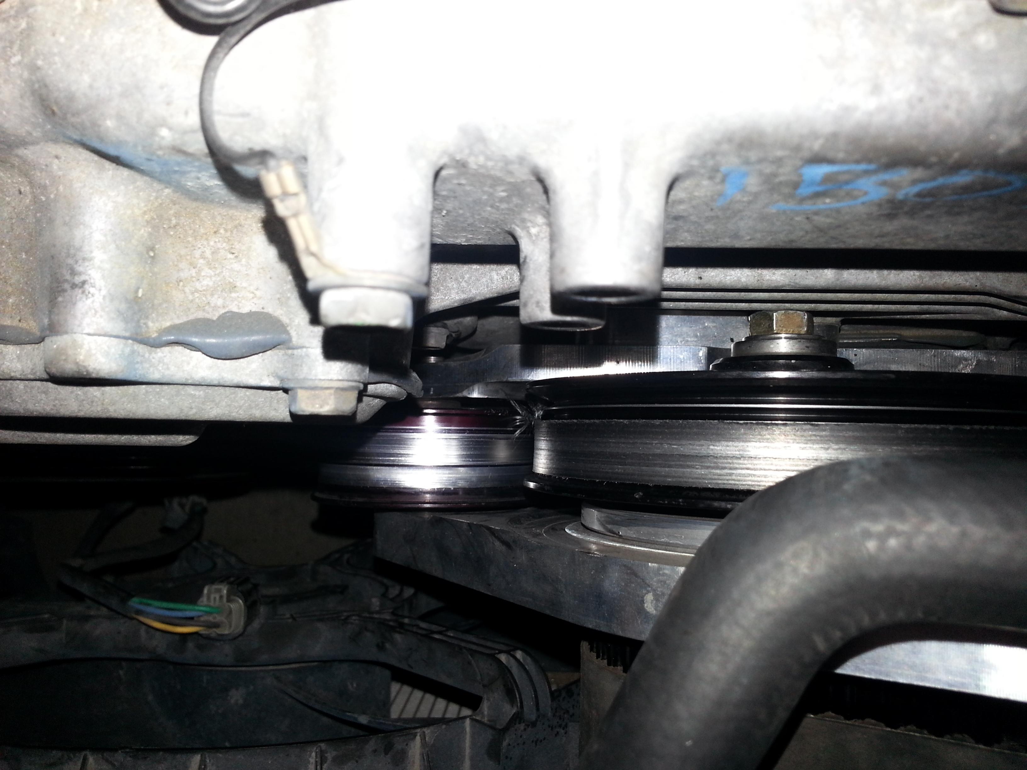

From: Pan Handle

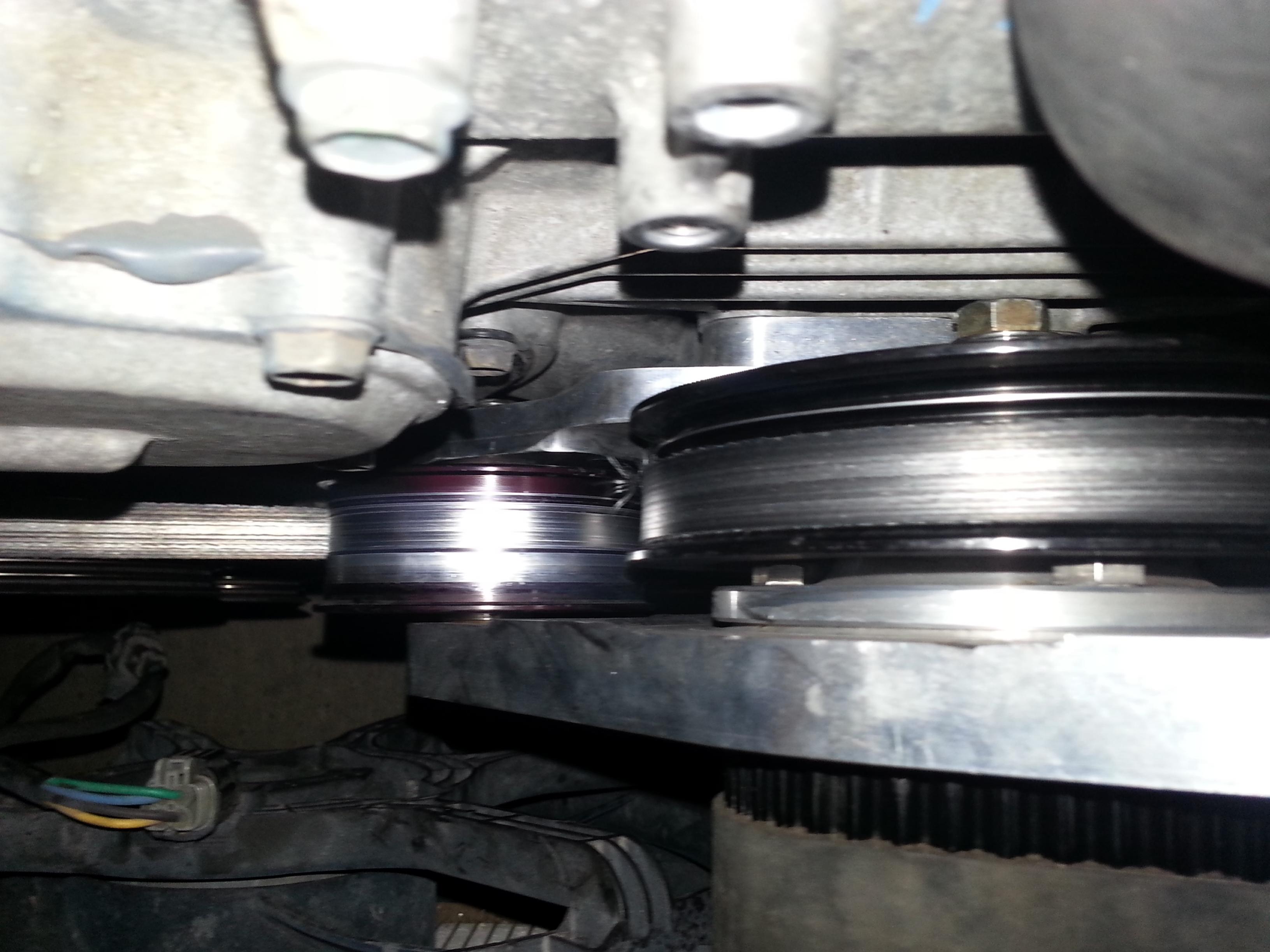

Well now im eating serpentine belts...will have to call monday and see if procharger will look at my bracket and pulleys to see if they are messed up.
Old Sep 6, 2014 | 07:58 PM
  #45
jdm-v35's Avatar
jdm-v35
Joined: Oct 2007
Posts: 664
Likes: 25
From: CO
the top pulley(largest on procharger bracket) doesn't look like its pushed all the way on. Also i saw youve had difficulty changing pulleys. The secret to it I learned is to used a torch to heat the center of the pulley and since its aluminum will expand faster than the steel drive shaft. It will go on and off a lot easier when heated, and if not sometimes just needs a good tap from a hammer cushioned by a piece of wood. This also applies to vortech when I had my v2 on my old maxima.

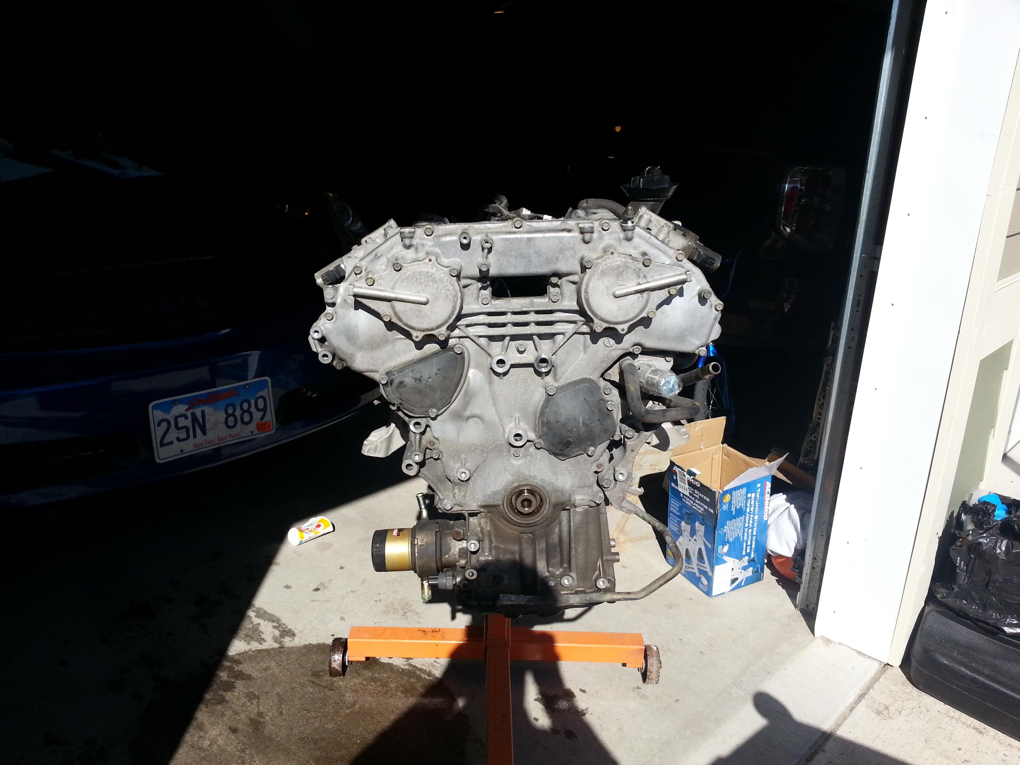

Old Sep 20, 2014 | 11:06 AM
  #53
Conway_160's Avatar
Conway_160
Joined: Dec 2012
Posts: 2,593
Likes: 357
From: Pan Handle

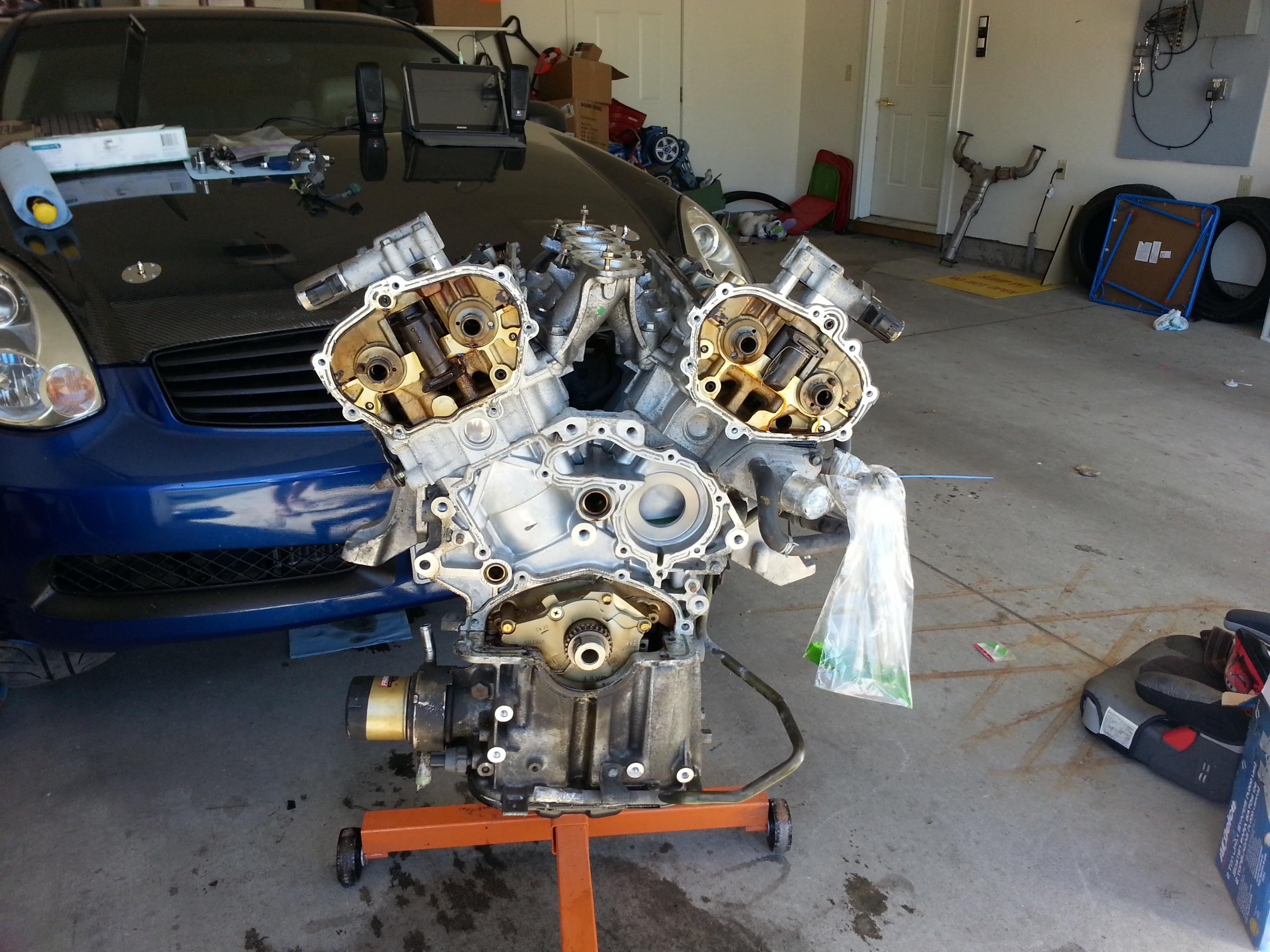

Started the tear down of my original block to see how bad the cylinder walls are.
Didnt accomplish much, just got the acessorys off and the timing cover. Will do some reading tonight would like to get the motor completely disassembled tomorrow.
Old Sep 21, 2014 | 10:58 AM
  #54
Conway_160's Avatar
Conway_160
Joined: Dec 2012
Posts: 2,593
Likes: 357
From: Pan Handle

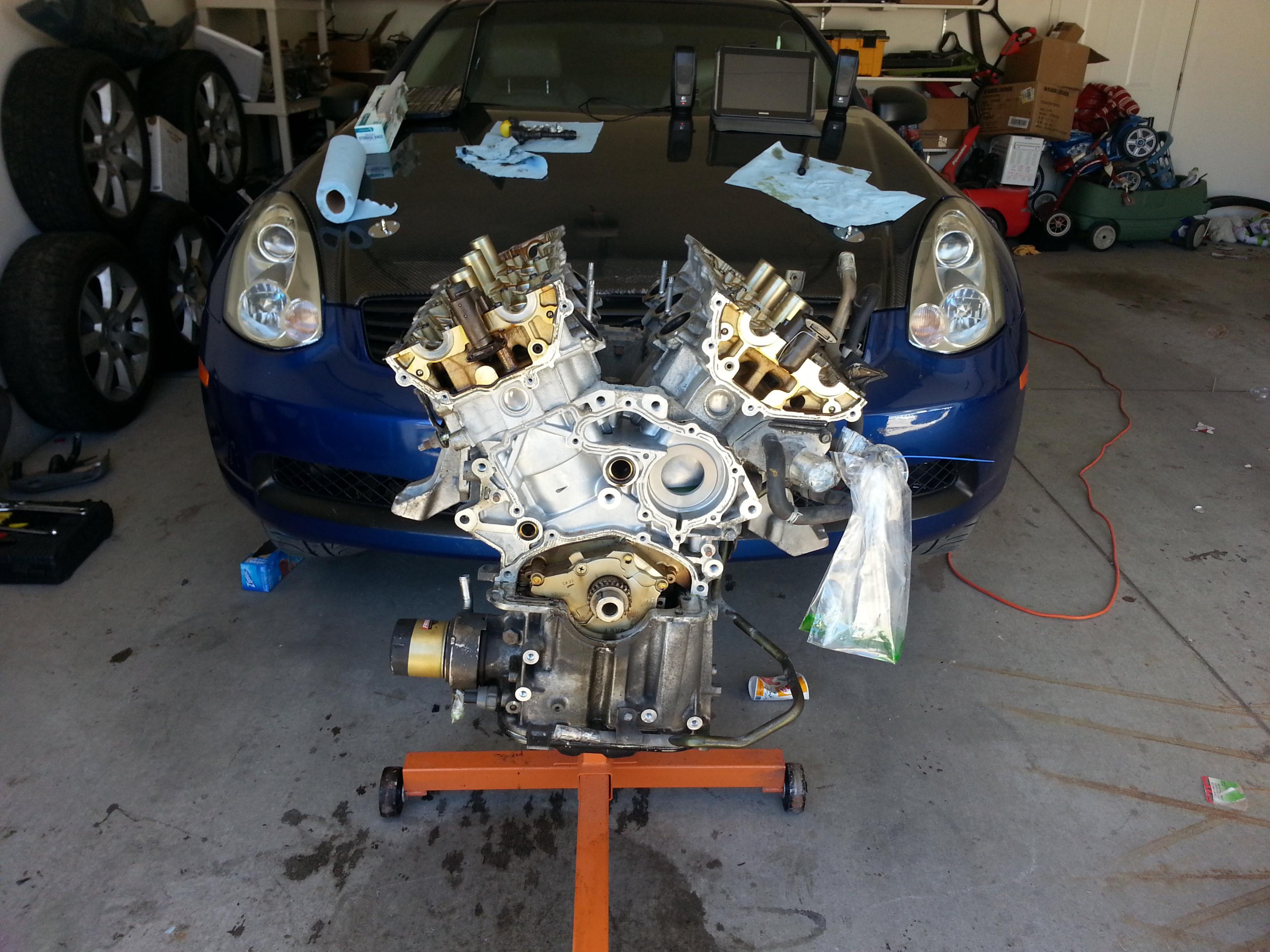

Well didn't get much more accomplished, apprently i need to add some more tools to the tool collection.
Damn Cam Shaft Bolts were a pain in the *** to get out, took two of us to break them free.

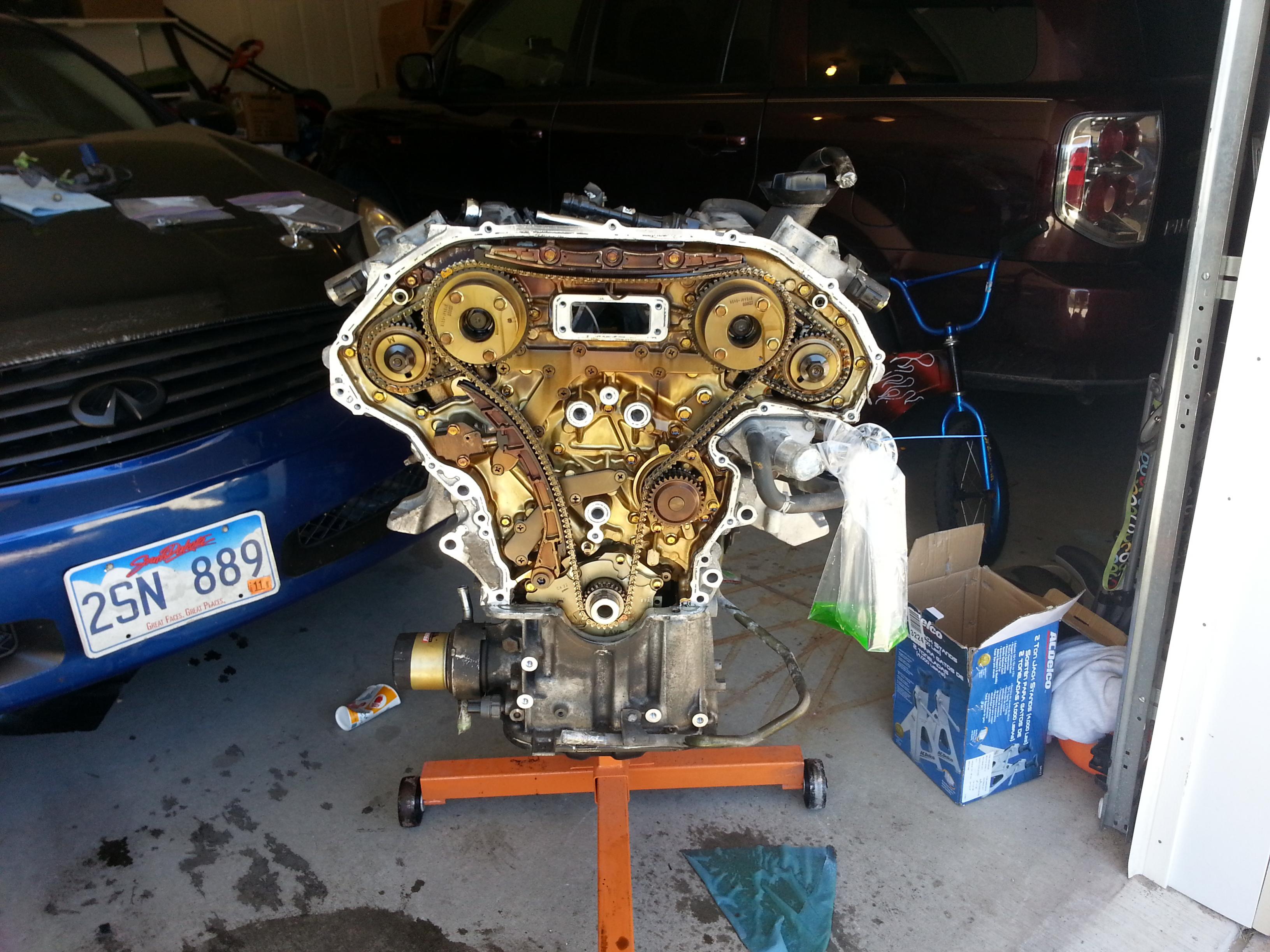

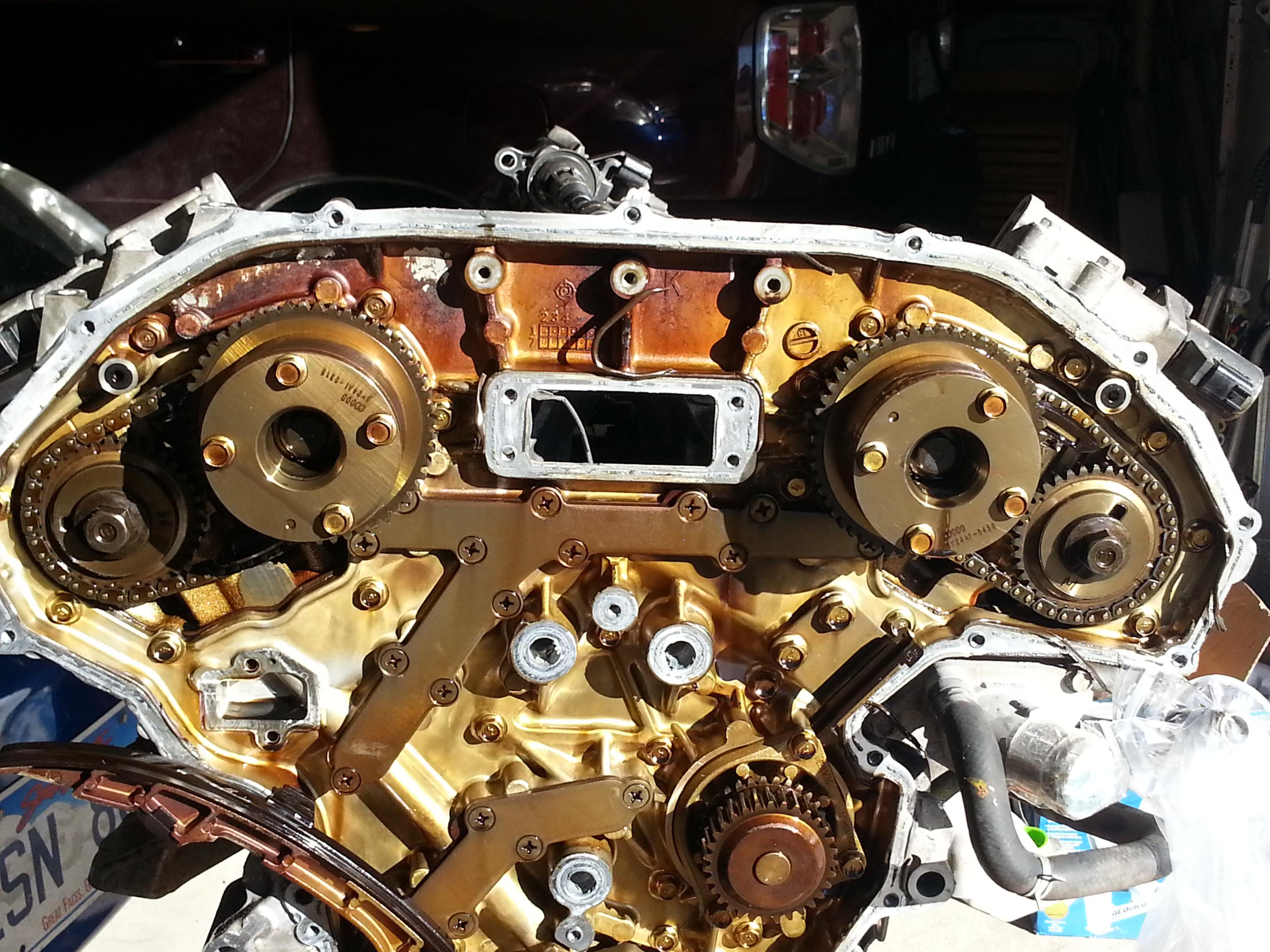

Back timing chain cover removed.
Removed the lower intake runners.
Need to go buy 10MM and 8MM allen key to get these bastards out, using my allen set and a breaker bar wasn't working.

Old Sep 21, 2014 | 06:57 PM
  #59
djamps's Avatar
djamps
Joined: Dec 2008
Posts: 4,492
Likes: 10
From: MD

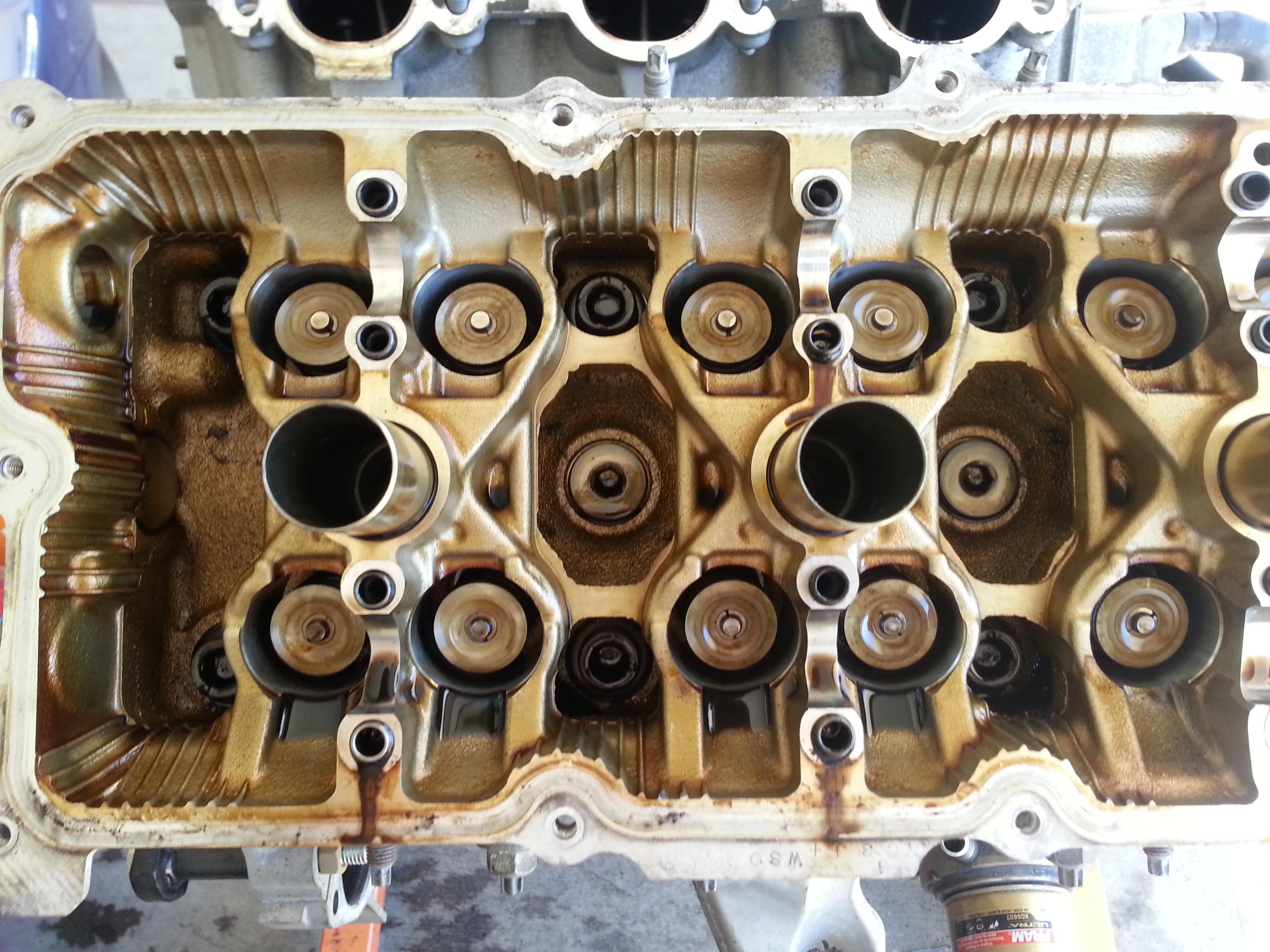

Looks kinda like the motor was an oil burner to begin with (or at least ran very low at some point in the past), the heads are quite brown. Way more than my 140k mi greddy Z's are at least.
Old Sep 21, 2014 | 06:59 PM
  #60
Conway_160's Avatar
Conway_160
Joined: Dec 2012
Posts: 2,593
Likes: 357
From: Pan Handle
This motor was a oil burner thats why it was replaced.
