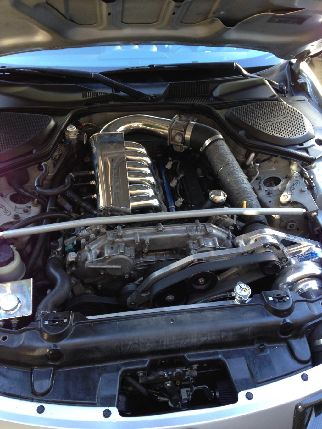

It's nothing crazy. Eagle rods. 11:1 weisco pistons. Acl bearings. Tomei 272 11.3i 11.0e cams. Tomei valve springs. Ppe longtubes. Tomei expreme ti exhaust. kinetix velocity manifold.
Old Jan 20, 2015 | 03:56 PM
  #94
2bad240's Avatar
2bad240
Joined: Jan 2011
Posts: 1,067
Likes: 43
From: new bern nc

Looks good, are you shredding belts?
Not since I started running it loose. Procharger said the reason it was shredding before is because the belt was to tight and it was stretching under the torque and shredding.
http://youtu.be/i3MajYdA99A

Thats interesting, how tight is your back belt?
Old Jan 20, 2015 | 04:42 PM
  #98
2bad240's Avatar
2bad240
Joined: Jan 2011
Posts: 1,067
Likes: 43
From: new bern nc
The serpentine belt is as tight as it can go. The back belt on the blower isnt super tight but I havnt had any issues with it at all.
