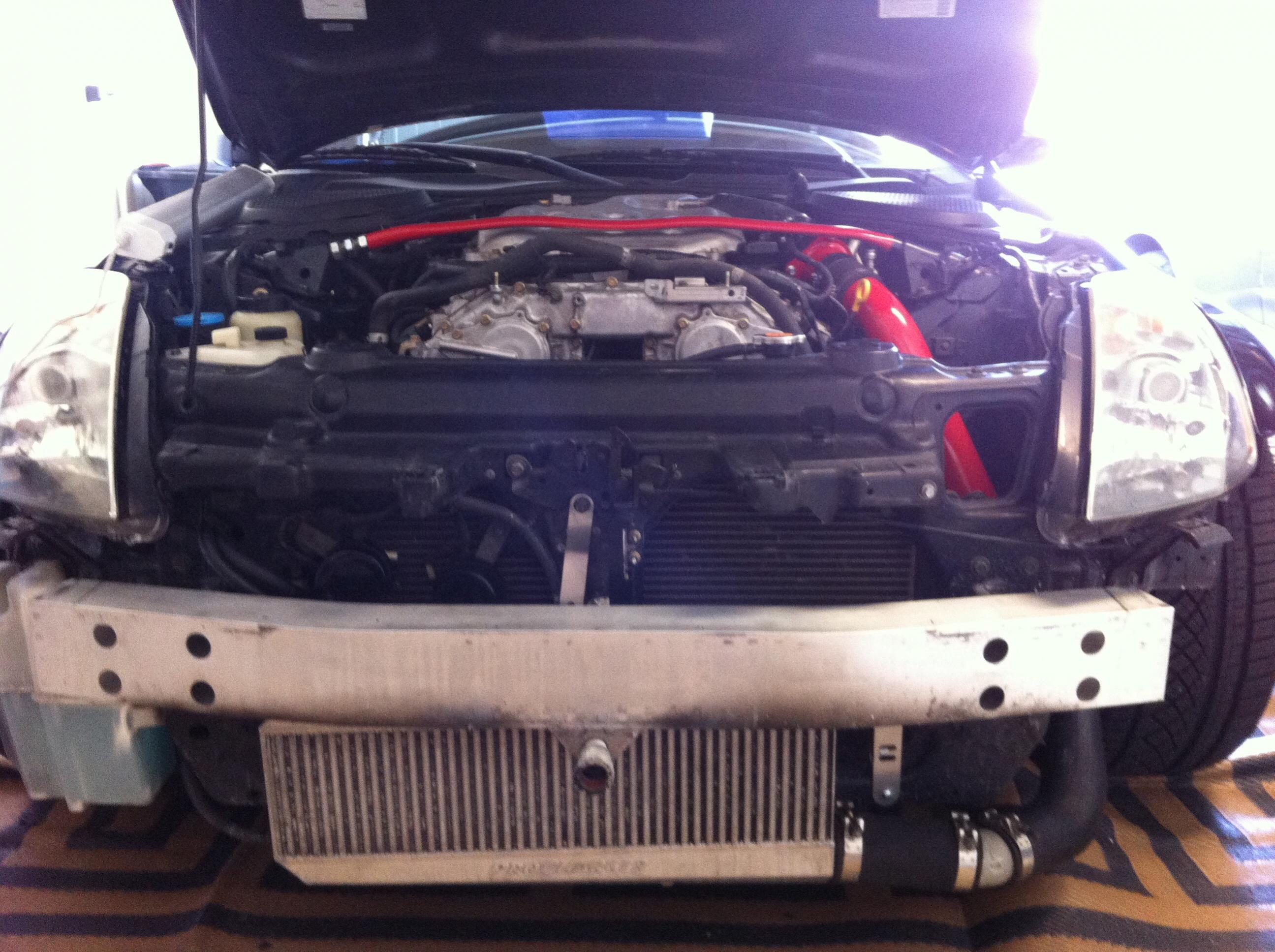

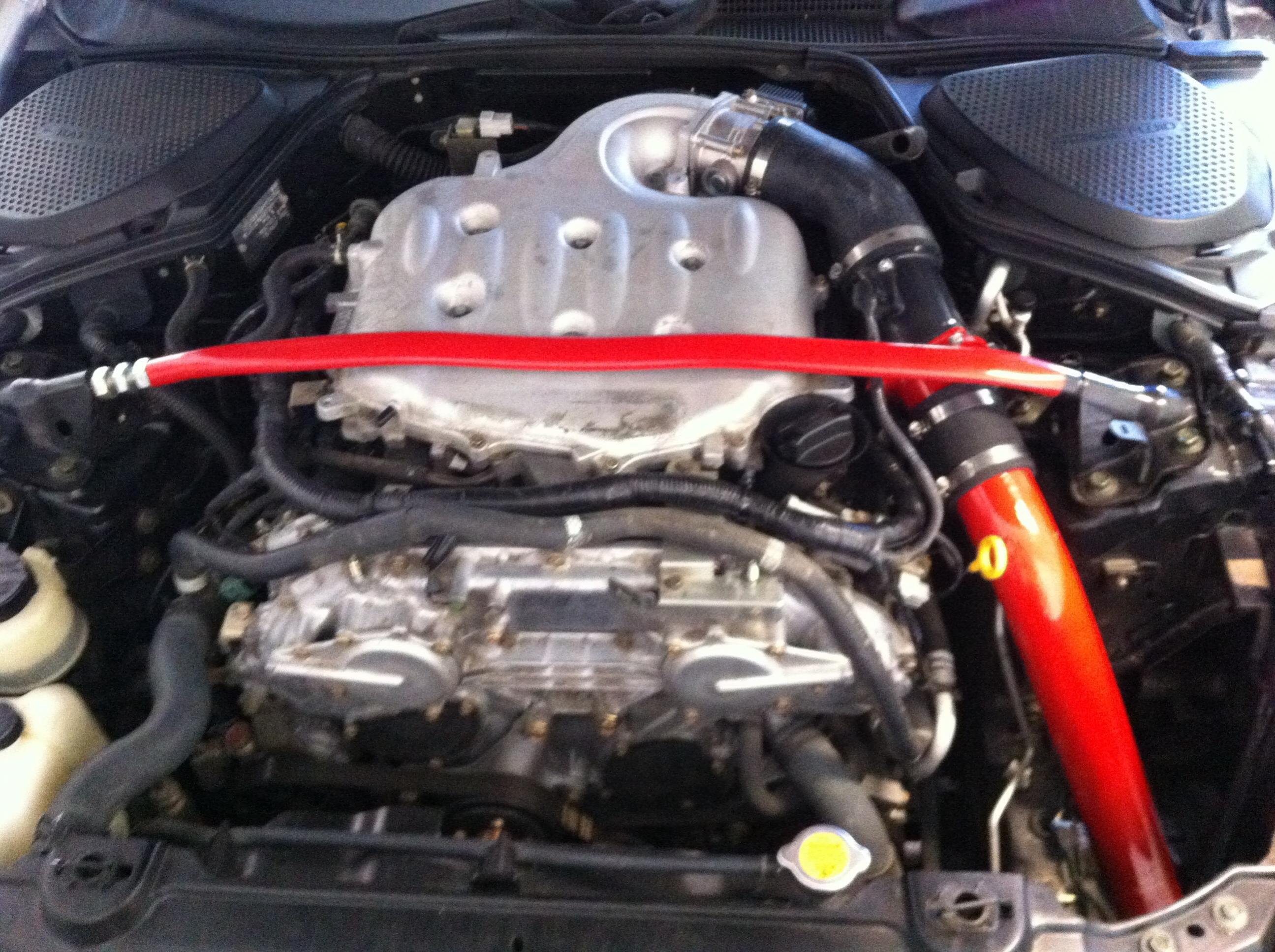

Hi guys, this install has been a nightmare because my kit was purchased used and I was missing a lot of parts that I had to order direct from procharger ( tubing, hardware, hoses). Live an learn I guess.
Anyways I started the built (piping, relocating the power steer lines, modifying sections of the car to fit the inter cooler. I'm gonna have the shop install the fuel system and brackets + blower. I need your guys help tho on additional missing parts.
Questions:
The used kit I purchase is also missing the ATI EFMU module but I have the fuel pump. If I purchase Walbro 255 LPH fuel pump kit, will I still need this EFMU?
I have a hose (see pic) right above the MAF sensor that hooked up to the old factory intake, thinking its a vacuum hose,can I cap it off?
I just don't wanna take it to the shop with missing parts? Thank guys

Because you are missing the FMU you will need something to tune with...I would look into the osiris platform - it will mesh up to what you have already. The walbro 255 will not replace any tuning device. The walbro you bought will replace the in-tank fuel pump while the procharger fuel pump mounts in the engine bay and is run in conjunction to the OEM setup.
The procharger kit (right, wrong or indifferent) uses the OEM fuel system in an OEM manner when the car is running in vacuum. Once the procharger starts marking boost the procharger/FMU adds fuel according to boost pressure. The FMU has sliders that adjust the voltage that the procharger fuel pump receives. The voltage is adjusted at 6 different intervals through the RPM range. higher voltage increases the pump pressure, lower voltage decreases pressure which either adds or takes-away fuel to the engine - either richening or leaning-out the air:fuel ratio.
I believe the hose above the MAF is the PCV hose - you cannot just cap it off, if you do this it will damage your engine. It should be fed to your intake after your filter but before the MAF. You should do some research on the PCV hose and it's purpose and function. You also may want to look into a vented catch can as a replacement to the OEM PCV system.
