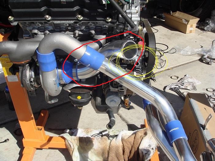

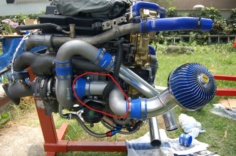

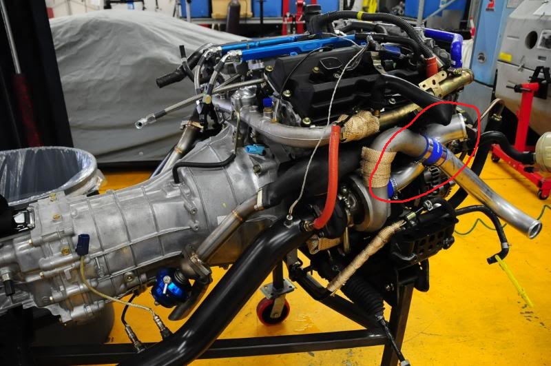

Im confused on the piping for this kit. The directions are horrible and all the pics from the threads ive been looking at are dead. I have found a few pics to go off of but they contradict each other. I have attached a few pics to show what I mean. I circled in red the pipe i have a question about. In the first pic, rrmedix has it there, on the second and third its not there? If it doesnt go there then where does it go? Does anyone have any pics of the pipes installed out of the car? thanks!

the circled pipe in the first pic is the first pipe off the drivers side turbo intake side. Goes right next to the compressor.
the circled pipe in the 2nd pic is the first pipe off the passenger side turbo intake side. goes right past the power steering suction pipe.
that makes sense, that why I was having trouble with clearance issues there. I knew something was wrong.... Thanks! I'll check out your thread...dont know how I missed that.
