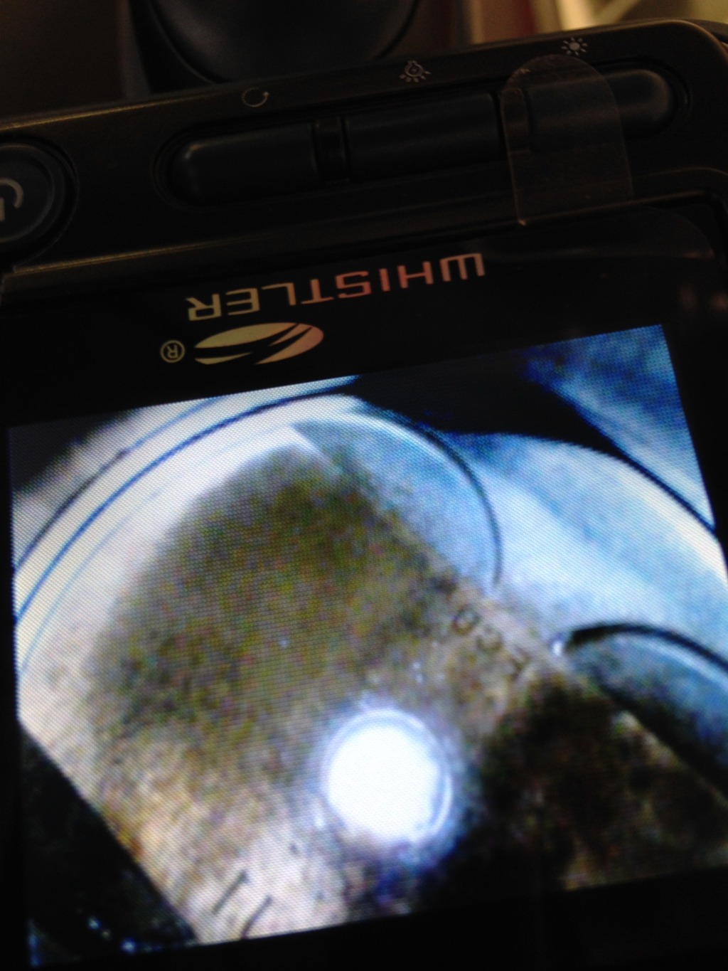

At least they didn't look like this. This was a g that got dropped off at my shop last night
