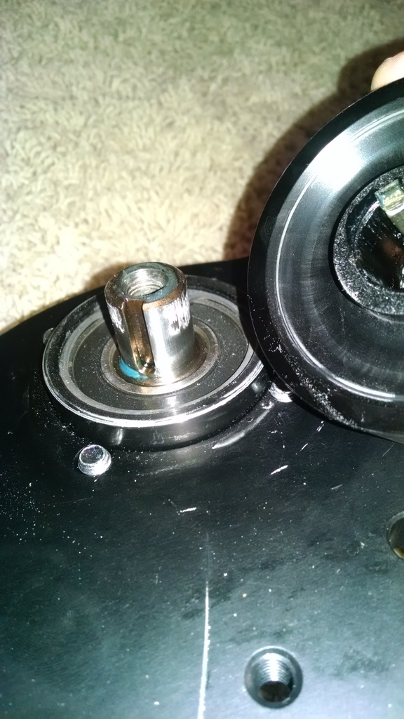

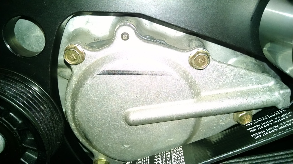

-2.87 pulley rubs the outer lip of the jackshaft. When I tightened the pulley down, the jackshaft would literally not spin. Got the tip from Timrod to basically take the lip down with a grinder/dremel so the interference is no longer there.

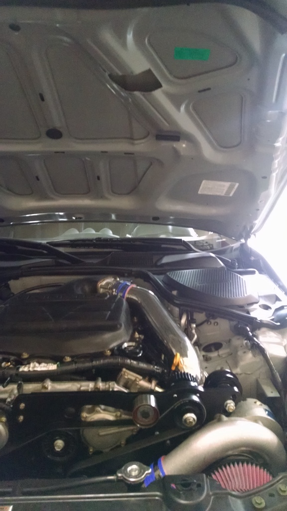

-Added an idler pulley "GTM" style and realized it hit the hood support, had to cut a portion out...disappointing, but the extra grip will be worth it.

Pic of where the 2.87 rubs on Jackshaft....

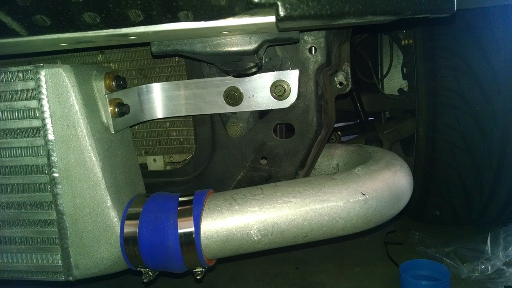

My supporting bracket for Left side of intercooler...would be so easy for Vortech to create a better option. Also, see the ill fitting pipe....will probably modify later so it sits better, but not that big a deal i guess.

Where i had to knotch my hood support to clear the extra idler pulley...

slight belt rub....grinded the cover down a tad....probably not that big a deal but I have a dremel

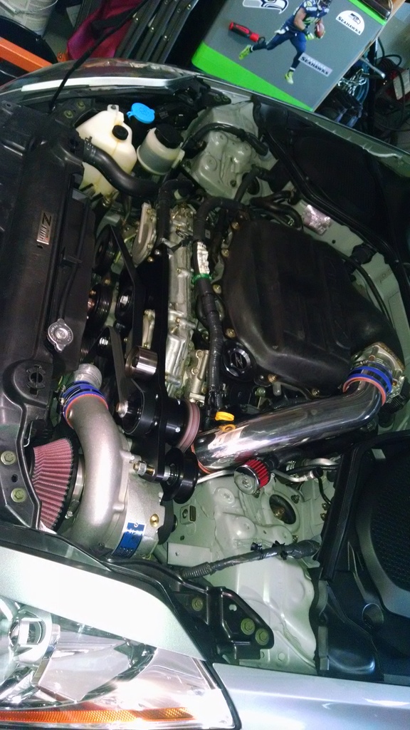

Kit installed....and Beastmode Keggarator Sighting

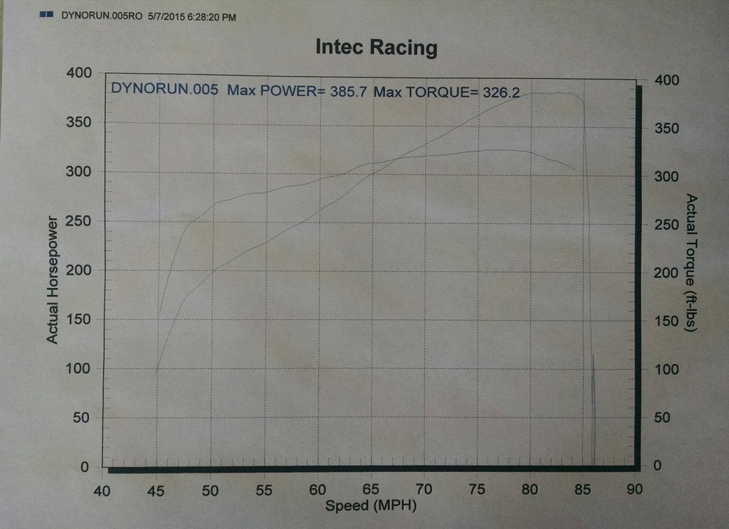

Update...hit the dyno at IntecRacing yesterday. Spent the day there and after only making 360whp with shaky power curves, we discovered the issue was the oil filler rubber was caught in the manifold...doh(no, not installed by me). After solving that issue made a 3rd gear pull. Made 385whp on a VERY conservative tune. I will be getting retuned with an even colder plug so we can add timing and increase torque. Boost seemed to peak at 9lbs, which seems low for 2.87 pulley, but not getting belt slip. Didnt hear it on the dyno, but did on the drive home some fluttering, so I am going to play with the bypass valve. Overall very happy with the car as it is.

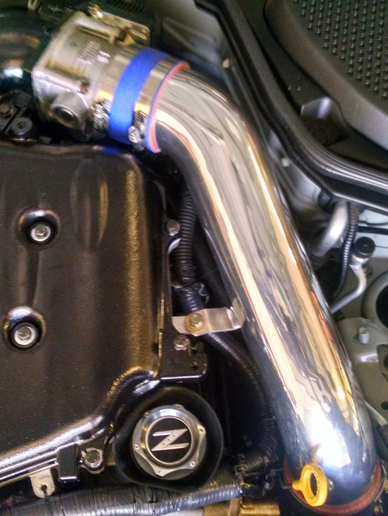

Also had the guys make a brace to keep the up pipe from getting too close to the cog pulley...

Congrats on your numbers! Your power level is a bit low for a 2.87 but there could be many factors why. Perhaps the 570cc GTR injectors were maxing out, what was the max duty cycle for them?

570cc injectors will not be maxed out @ 386 whp

Correct...there are plenty of GTR's making 500whp with stock injectors.

It's not injectors. I have the same injectors and I am making 430/370 with 3.12 pulley. But i have way more mods.

On your pulley, we did the same thing on my brothers 2.87 pulley. Garbage, absolute garbage. We shaved the lip as well and all works fine and flawless now.

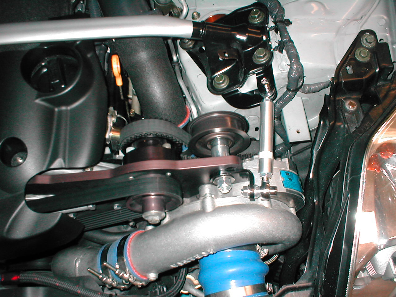

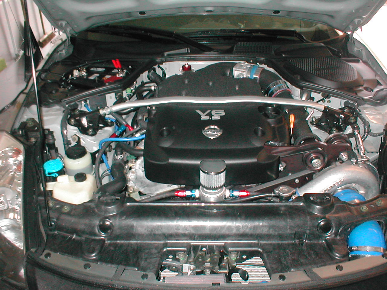

This is what it looks like installed!
Let me know if you need more help!
TimRod
Attached Thumbnails V3 Kit install on my 04 Track.... some takeaways-p1010024.jpg   V3 Kit install on my 04 Track.... some takeaways-p1010040.jpg

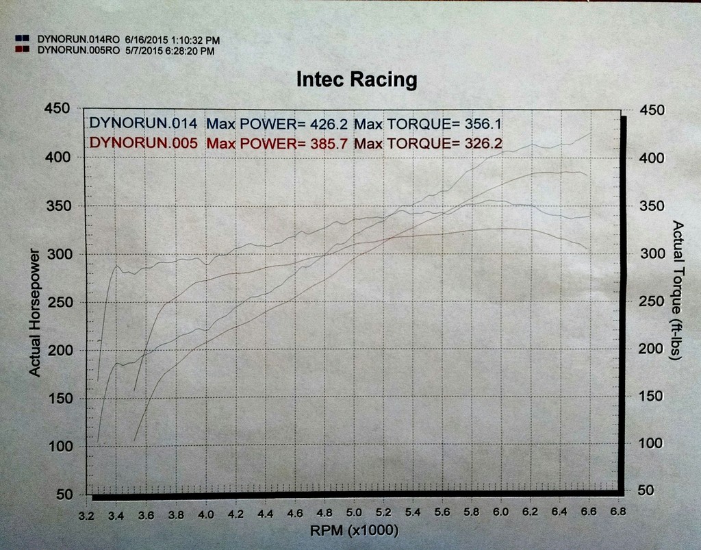

UPDATE.
Finally got in to dyno tune down at Intec Racing in Kent, WA. Only mods from last dyno to this are Injen intake set up and swapped out stock Vortech cooler with Treadsone 1045 FMIC. Outdoor temp was around 10f higher today than previous dyno, but the mods cooled intake charge quite a bit. Car saw peak gains of 41whp and 30ftlbs Tq. Lawrence was also able to tune out my pesky hot start issue. Shout out to Lawrence at Intec for his tuning and Charles at Gerber Motorsports for FMIC install.
