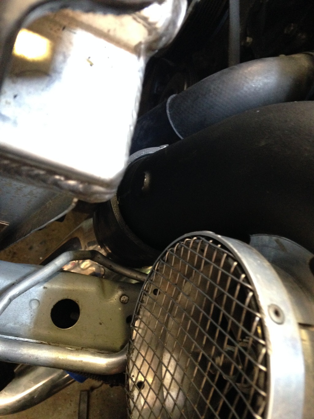

I've been wondering how it all would fit with a single sided IC and 3" pipe as this is how I would do it for a YSi setup.
Did you rotate the Volute to point about straight down? Can see in the pic's....
