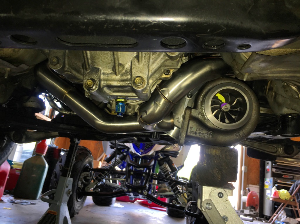

Well a final update for this vortech thread. I parted my kit out and the blower went to Poland. I'm in the process of building a mid mount kit for my car right now using a Borg Warner 6673
Copy what sasha did for the oil return otherwise the car is going to probably smoke like a bish.

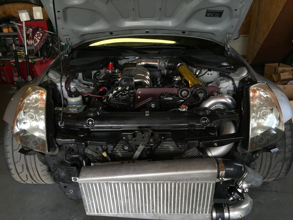

Scrapped the turbo setup. And luckily j still had my intercooler and piping and another bracket. So I picked up a V2 local and slapped it on.
Well, damn! Nice Intercooler! Would love to get a Treadstone 1245 but I really need a fuel return setup first.
