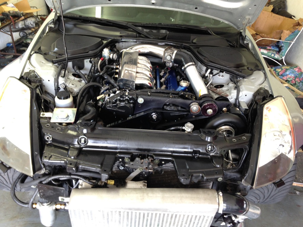

Don't know if it actually helps but I wrapped my intake piping with the reflective heat tape today. If anything at least I got a little color now.

Tried to make a couple pulls on the dyno today.
First run (blue) it spun
Next two runs it was choking out and only making 14-15psi and you could hear it starving out up top. Figured out after I got home it was collapsing the blower intake coupler again. So I pulled it off and took it for a street pull and boost went up to 19 and Idc went from 85% to 98%
So I was definitely losing power from the intake acting like a restrictor plate.
