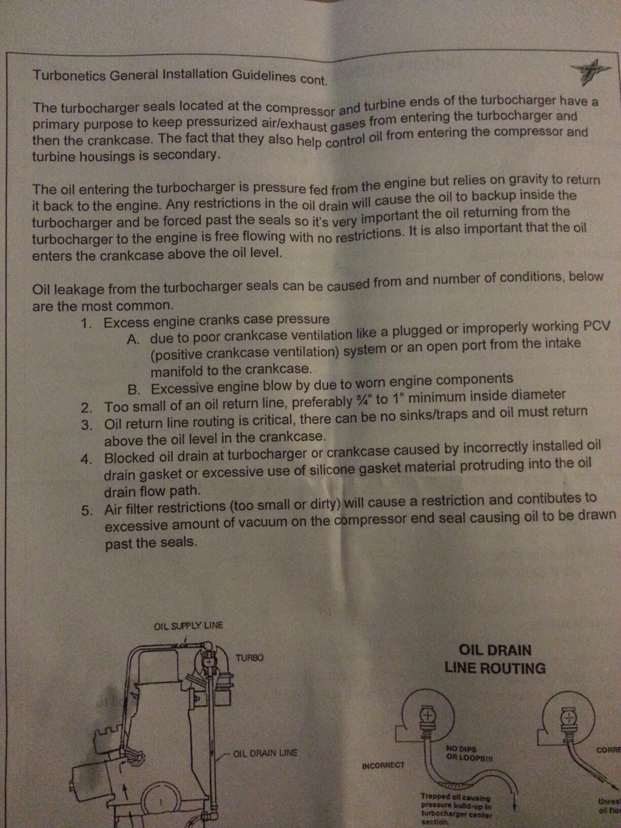

#1 cause of oil leakage from turbo seals are from excess engine crank case pressure. If you don't believe me, believe my turbonetics manual.
Attached Thumbnails please help, new engine not making power. valve float?-1438741998324.jpg

Not stock headers but HKS headers which are just as bad. they are all merged into a 1.64" runner, not even 3:1.... they then have small collectors also.
I went to shop to look at turbo, the HKS kit mounts the turbo above oil pan so a hose returns oil via gravity but the angle is not very steep. Well i felt the hose and it was kinked.. so i got a 90 degree brass fitting
Also drilled out PCV, breather on it and plugged off plenum return. = no more smoking turbo.
So now ripping kit off and doing boosted performance style kit with 6466 T4 TS 1.32 a/r

Turbo return line then? Glad you found it.
