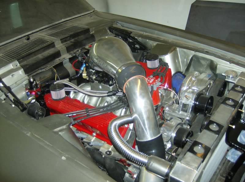

I've used Cometic head gaskets on every FI engine I have built so far, and they have worked fine.
However, I do get the mating surfaces, resurfaced to Cometics recommendations, then I spray Hylomar on both sides of the gaskets.
Don't misunderstand me. I'm not saying that you're wrong, only that I haven't had any problems with using Cometic head gaskets.
I currently have five vehicles with FI from centrifugals to turbos with the strongest engine making over 1100 hp.
