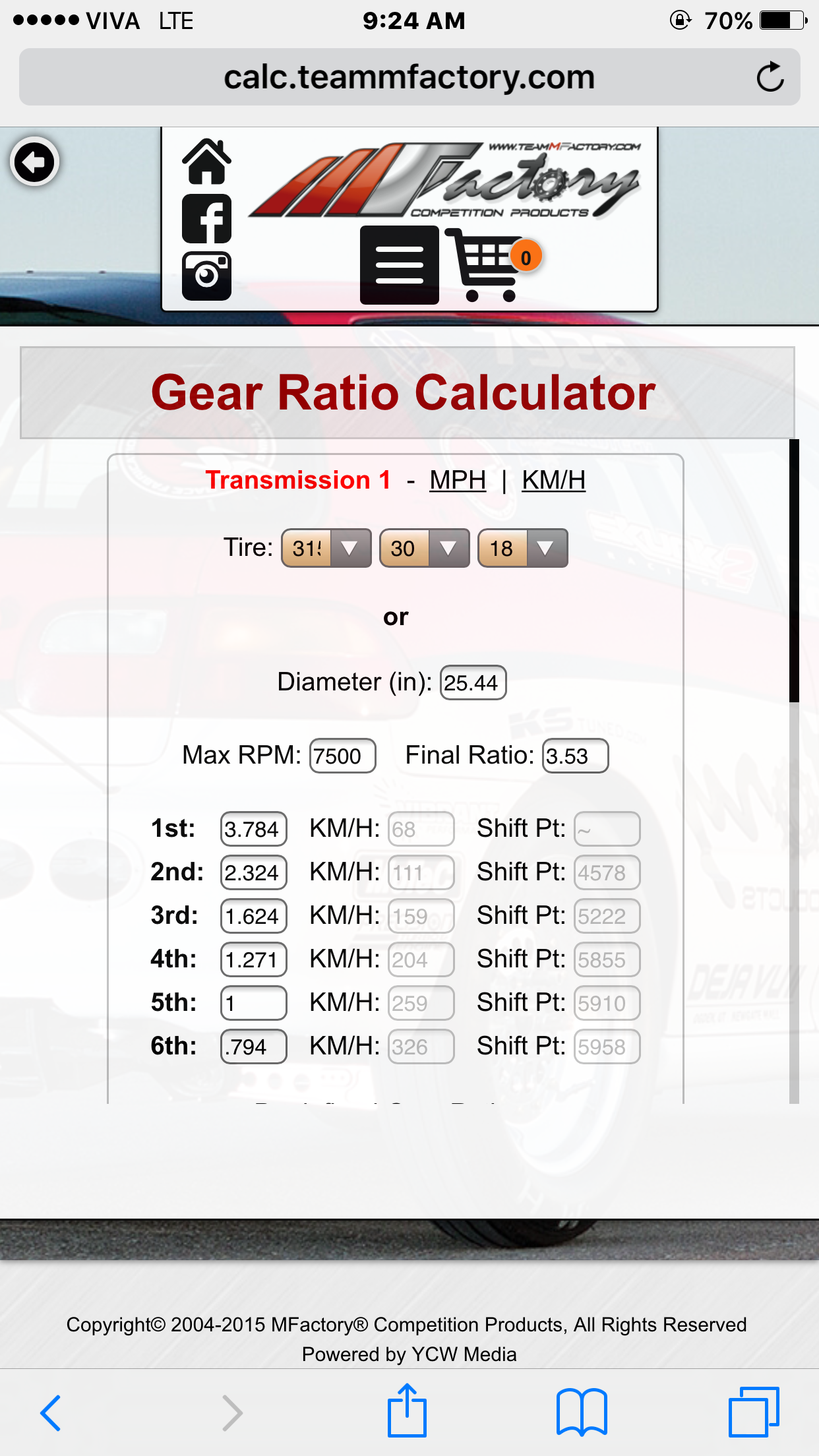

This is the speeds i came up with, with.a 7300 redline

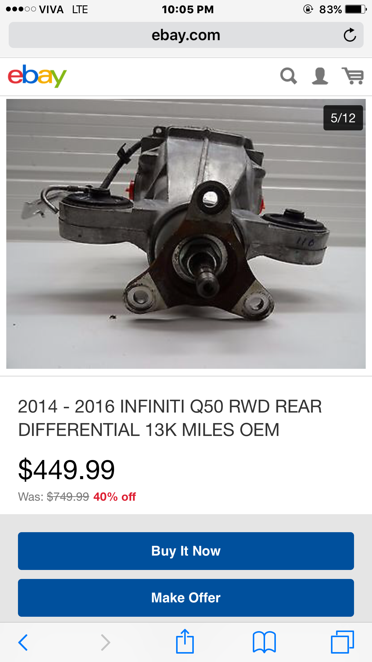

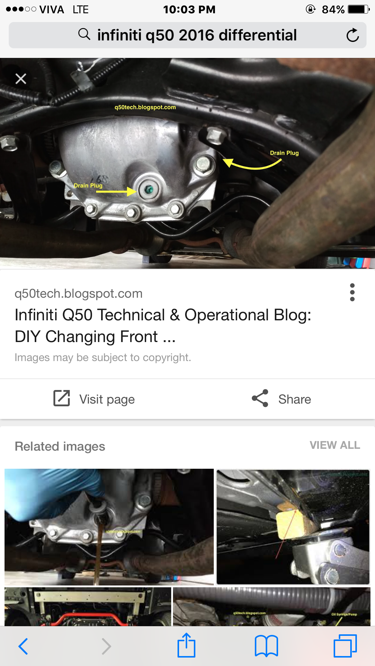

i found new info maybe a drop-in for 350z. i comes from 2016 infinityQ50 (turbo engine 3.0 v6) there FD is also 3.1, there are few pic of the pumpkin came across on the internet.
also the 4 cylinder turbo of Q50 2.0t have 2.94 FD not sure of the size though.
Attached Thumbnails 3.1 pathfinder final drive-img_5540.png   3.1 pathfinder final drive-img_5541.png   3.1 pathfinder final drive-img_5544.png   3.1 pathfinder final drive-img_5543.png   3.1 pathfinder final drive-img_5545.png

from those pics they would not be a direct pumpkin drop in as the rear bolt is in a different place. MAYBE the gears would fit but you would probably have to just jump in and buy it to find out.
The thing is that all of the Q50 models come with open diff.

The R200 has the best chance of internal gear/pinion being correct diameters to allow for using in the 350Z diff. There will not be a reference online to know without buying one and opening it up.
The Q50 unit is too small.
