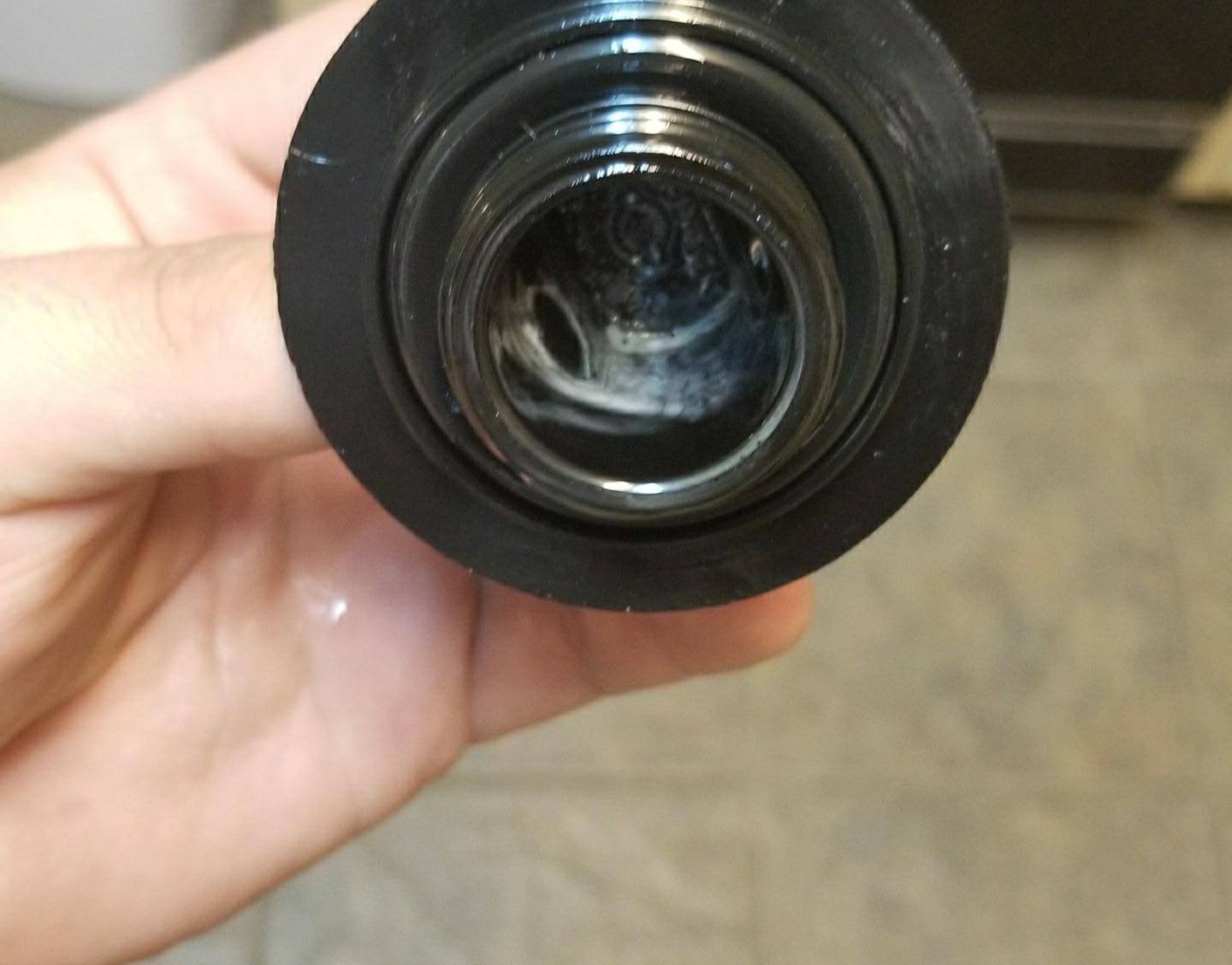

So, this is not a sight you want to see on a new block...
