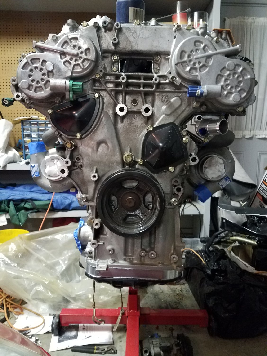

Ok so spent a few hours getting the driver side manifold on. There was one bolt that wouldn't clear the manifold tube, but I cranked on it and got it as tight as I could. I figured as long as the lock nut was flat it would be ok? Im working on the passenger manifold now. There is one bolt that a nut will not clear the tube no matter if I cut it down or not (last 2 pics). Any advice? Seeing both turbos mounted on my engine is making me real excited to get this thing swapped into the z!
This is the one I tightened as much as I could. I wish there were nuts that would thread onto these studs with a smaller diameter?

The greddy kit install manual will tell you to reconfigure the studs. As long as you have two per exhaust outlet you should be good
I believe we only had to grind 1 down for clearance on the pass side turbo

Well i put the bolts how the greddy instructions said and still end up with that one in the last pic that wont fit. Are you saying it wouldnt be a big deal to reconfigure the bolt pattern?

Mark, mark up that template you posted earlier with the ones you have on there that are tight, show us what you've got on both sides. We'll see if you're on the marker or not.

No they didnt mind. They had it for like 4 months and we were just waiting on fuel rails so they said i could come get the engine or wait another month or so for fuel rails to come in so they could install them. Heres the template for the passenger side and what i have. Pretty sure its right but i domt see how nuts are supposed to fit

It looks like you're missing at least one on the top and one on the bottom so make sure you have all six per the template at the very least.
Grab a grinder tomorrow and grind clearance into the manifold to allow the nuts to spin without interference. Loosen them all until you get all of the nuts threaded on then start socking them down in a criss cross pattern

Theyre all there. Just couldnt see the third one on the bottom until the last pic and one on the top didnt have a nut on it. Yall are killing me with the grinding, all i have is a tiny file. Cant wait to file that...

Oh yea true i forgot about that already! Sorry disyracted by the new season of the grand tour haha. It still makes me nervous grinding the manifolds down but oh well. Did everyone else have to do.this much grinding? So much for a bolt on kit... sorry about the template thing i misunderstood but the bolts are where theyre marked on the template i posted.

Yep it's pretty much standard practice with the greddy kit. Just be weary and take off the minimum amount required
