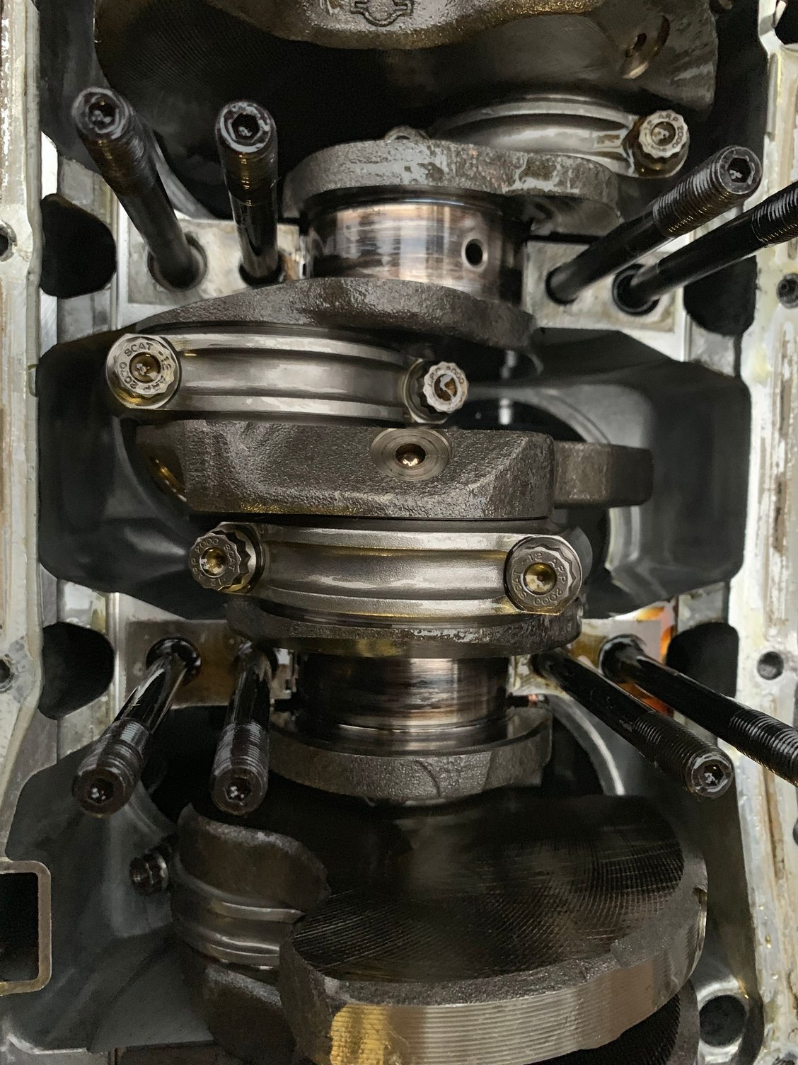

Well, I graduated with my BSN a few weeks back. And after some time off, my focus has now shifted toward studying for my licensure exam.
Thatv35guy came over this weekend and we tore the motor out. Unfortunately, the damage is worse than we initially anticipated. I'll let the pics do the talking. We're gonna tear the heads off next weekend and and pull the pistons/rods.
congrats! I'm in the same boat - I take the prof engineers exam in April ... about 2/3rds the cash I got from parting out my twins went to an exam prep Kaplan course...
Your chunks look wayyyyy worse than mine. keep the thread updated - do you anticipate fixing/rebuilding? Are you running Pauter rods?
do you think you lost your main bearing / bearings or rod bearings? what bearings were in there?
The rod bearings while worn, don't look like they were an issue. The two center main bearings took a beating. The crank journals for the two center mains are black. I'm debating what the game plan will be. I'll know more when we pull the heads off next week. I have another block sitting in the garage I may just build that one. And the rods are Eagles and the pistons are JE. Outside of those everything else is stock except for the ACL bearings, ARP main studs, and L19 head studs.
any idea why it's black? And assuming the crank is toast?
Heat, but idk why it got hot. I assume it was an oiling issue. None of the bearings were spun. And the rev-up oil pump only has 10k miles on it. I still think it had to do with the block flexing under 27psi and that's why the two center mains were damaged. I also don't know yet if the crank can be saved, there aren't any groves in it, but it is very discolored.
gotcha … were you running OEM spec bearings? gonna go a tad thinner on your replacements?
I was quoted $160 to grind/polish my donor crank … might be cheap insurance to have it sent to the machine shop to have it measured and cut to OEM spec. Not that I'm the z33 ambassador but it seems like high HP builds on other platforms are spec'ing their components with more clearance and looser fits.
I had my rods honed to the top of the OEM Spec 2.1659" (IIRC) and I'm going to have my crank taken down to the lower end of the spec, along with +1 bearings

So, some research has led me to believe that because my two center main bearings were trashed and my outer two weren't that the crank was flexing under boost. I still need to tear down the rest of the motor. I think the billet girdle likely would have helped this issue. And as TT03Z suggested I'm also adding an ATI damper.

I actually just had a similar situation in an engine I'm building at work. When torn apart I found lots of wear in the inner main bearings and almost none on the outer mains. Turns out the crank was bent .006". Now that's on a giant V8 in a cat machine. But the VQ is notorious for block flex in higher hp applications. I would highly suggest just replacing the crank not messing with the one u have and adding a block gurdle along with the damper. As far as bearing clearance goes most of your higher hp applications are going to have tighter clearances especially on mains. It allows for less movement of rotating parts. Where u set your clearances will also determine what kind and weight of oil u want to run. I didn't build the engine in my car. I got lucky and bought it unkowingly with the built block. But I run AMSoil synthetic 10w-40 in mine. Oils that are high in Zinc like this one always work better for higher hp cars.
