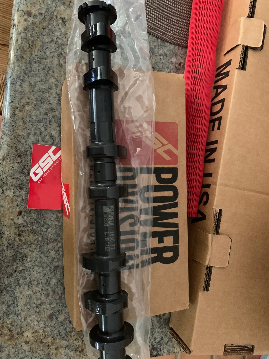

Well, I've dropped off my block to a machine shop. And in other news, I choose some cams. I ended up going with the GSC Power Divison 274 cams and springs. After reading a lot about GSC cams, they tend to make a lot of power in the 2JZ and the 4G63. So, hopefully they'll make power to 7500 rpms in my motor. I also picked up a new ATI dampener.

GSC has a lot of different options for the 2JZ. For our cars, they only have these 274 cams and a set of 264 cams. I spent a lot of time on the phone with Greg, one of the engineers from GSC, he recommended this cam and said it should push my power rpm range to 7500rpms without much issue. He actually said these are cams are very similar to the cams they offer for the VR38. I just mention the 2JZ and the 4G63 since GSC cams are used a lot more in those platforms.

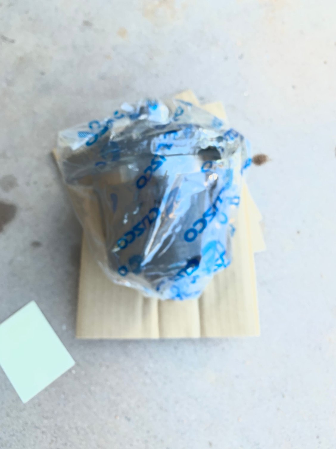

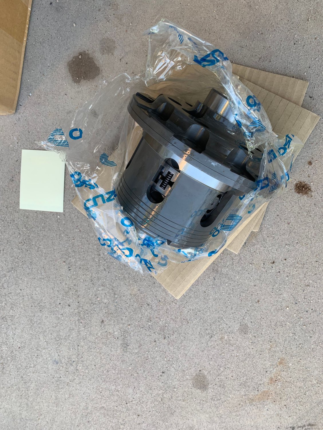

Since I've been buying parts, I picked up a brand new Cusco RS LSD. ThatV35guy has one in his G, and I've always been impressed with how straight his car stays while under WOT. Currently, I've been running my stock open diff. So this will be a huge upgrade. I got it from RHDJapan. They have the best price, and I got it in 5 days.

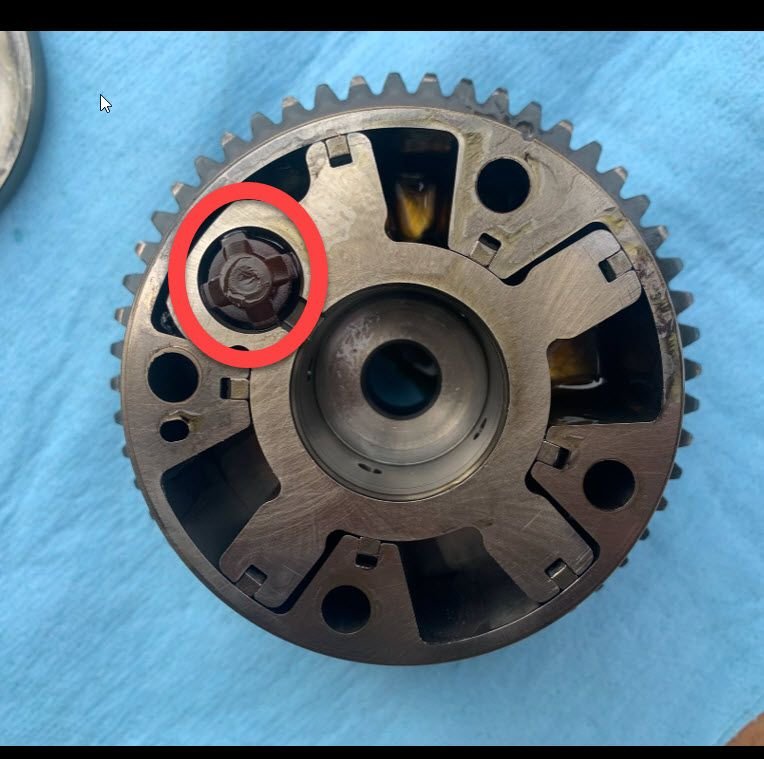

TheV35Guy came by my place and we started my engine assembly. I had a local machine shop build the short-block. We got my HKS headgaskets in and torqued the L19 headstuds then installed my GSC T2 cams.
ThatV35Guy showed me a FB post by SZR Pro, they're a Nissan shop in Houston, TX. They mention that they always disassemble the cam phasers on engines with bearing failures. So, we decided to take mine apart as my entire motor had bearing material throughout. Needless to say, I'm glad we did. There was a ton of bearing material in them. The pics do not show how much bearing material was actually in them.
smart smart smart smart - I did the same thing ... disassembly wasnt hard but keeping track of everything that popped out was ... Dont forget to clean the little mini-filter! I used a full can on brake cleaner between the two of them.

I'm not sure what you're refering to when you say mini-filter. But I'll definitly clean it if you point me in the right direction.

this little nugget has a screen filter built in …
And last but not least, I ordered a clutch. I went with the OS Giken TR2CD.
Good info. I never had the gall to disassemble the exhaust phasers. I was too afraid of the spring popping me in the face. Was it difficult to hold down the spring?

I believe these are intake cams sprockets … I think Mike runs a DE, which doesn't have the exhaust timing.

Ah, yes I took that all apart and cleaned it really well.
Bealljk is correct, on the DE I only have intake phasers. But these were easy to disassemble. It only has one small spring that pops up. Tear down and reassembly was super easy. And completely worth doing.

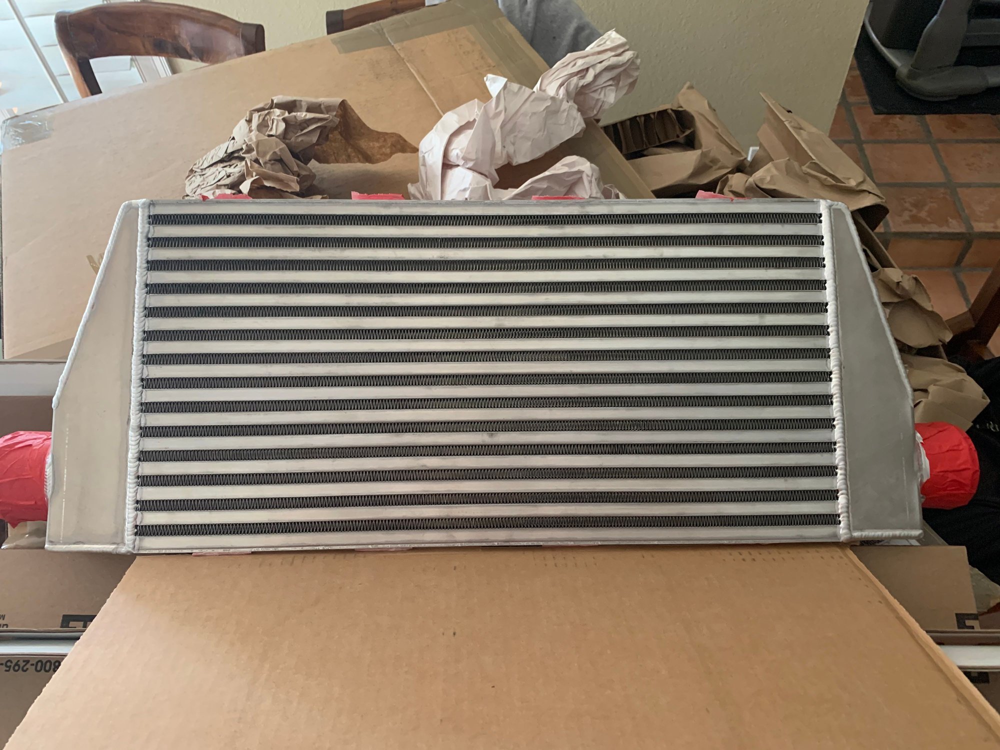

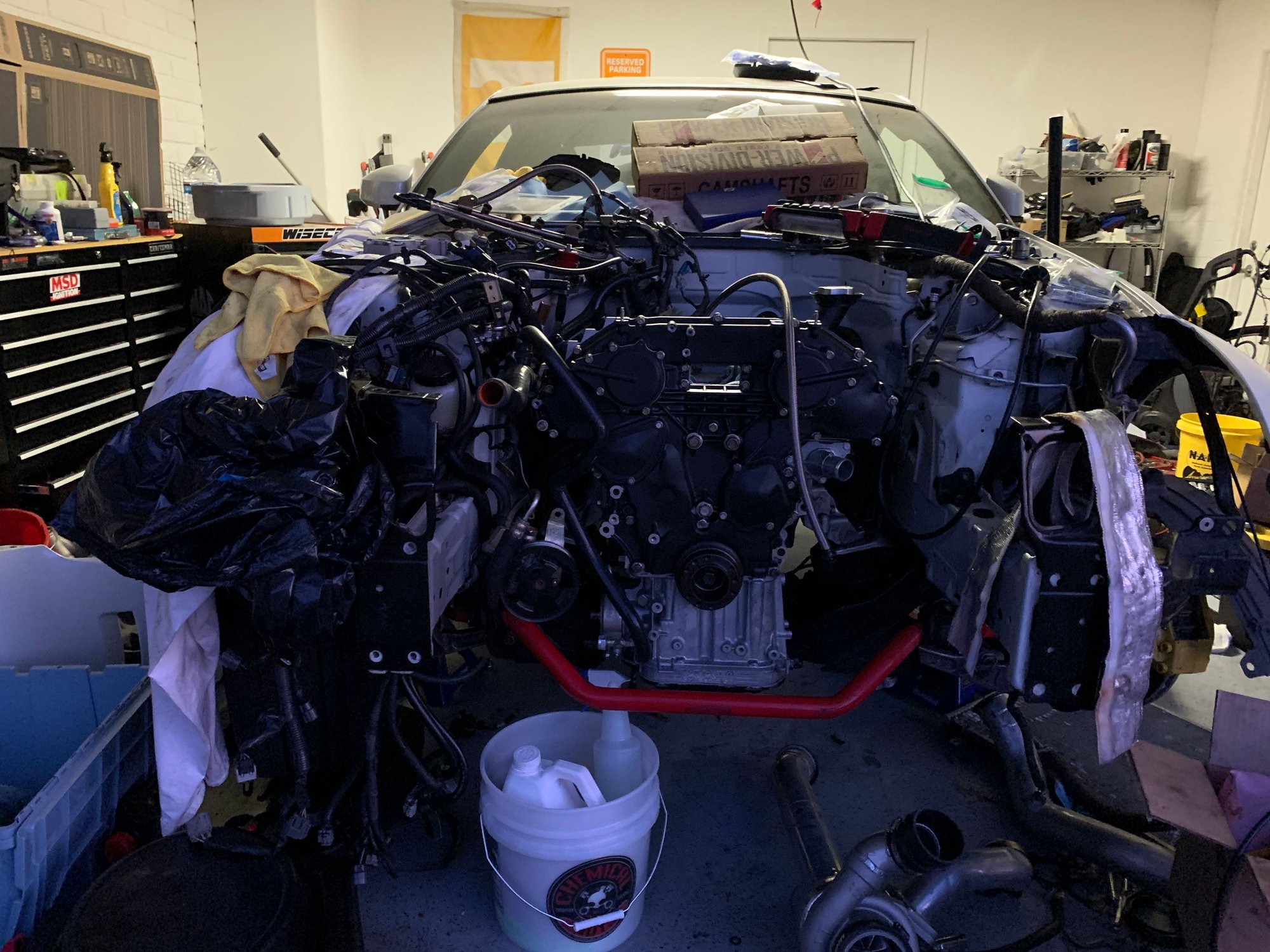

Small update, I installed my OS Giken twin-disc clutch and got the engine back in the frame. I dropped my ac line and condenser off at a local shop to change the pain in the *** spring locks to bolt together male and female fittings. I'm hoping to have the car on the road and driving come Sunday.
I also bought a couple of parts. The first being a new intercooler. This a Buschur racing "race intercooler". They make these for the Evo 8/9. I just had them change the inlet and outlet. Then I'll have a local guy fab the mounts. This intercooler uses a 1000hp rated Garrett core. ThatV35Guy add the same intercooler to his setup and rarely sees IAT go 10 degrees over ambient. And compared to the cheap intercoolers that that came with the powerlab kits there are some decent HP gains by switching to the Garrett core.
I also got a new clutch line with a provision for a pressure sensor. The sensor will wire into the ProEFI and allow a lot of functions to help keep the turbo spooled when the clutch is engaged.
