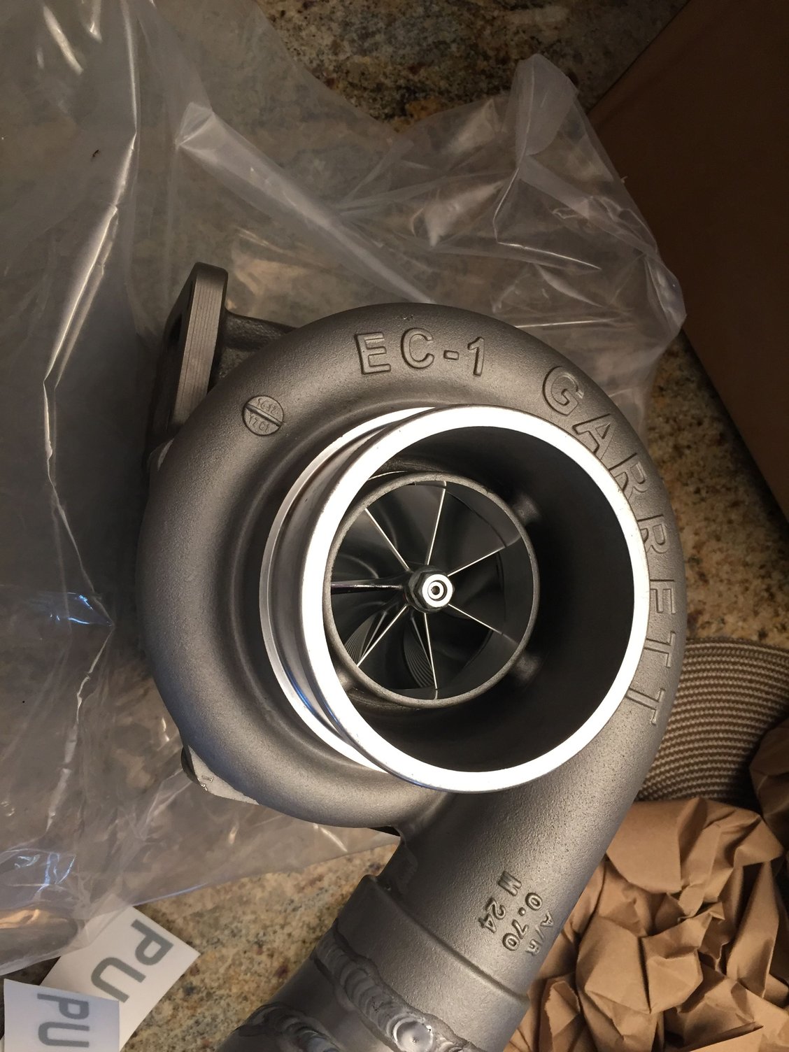

In other news my I got my turbo back from Pure Turbos. It's officially a 6466 now. I dropped off the turbine housing for ceramic coating. I'm hoping to put it back together this upcoming weekend.

dam that looks purty,
