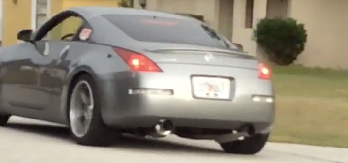

22 Inch Header Extensions with PPE Long Tube Headers for The DragStrip.
Old Apr 19, 2021 | 12:33 PM
  #80
Conway_160's Avatar
Conway_160
Joined: Dec 2012
Posts: 2,594
Likes: 357
From: Pan Handle
Oh man, that thing is going to be loud AF!
