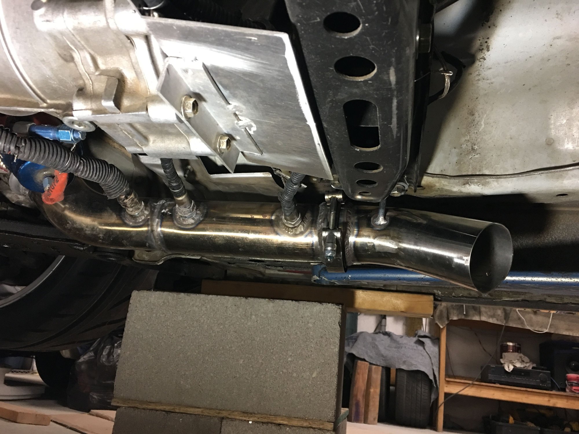

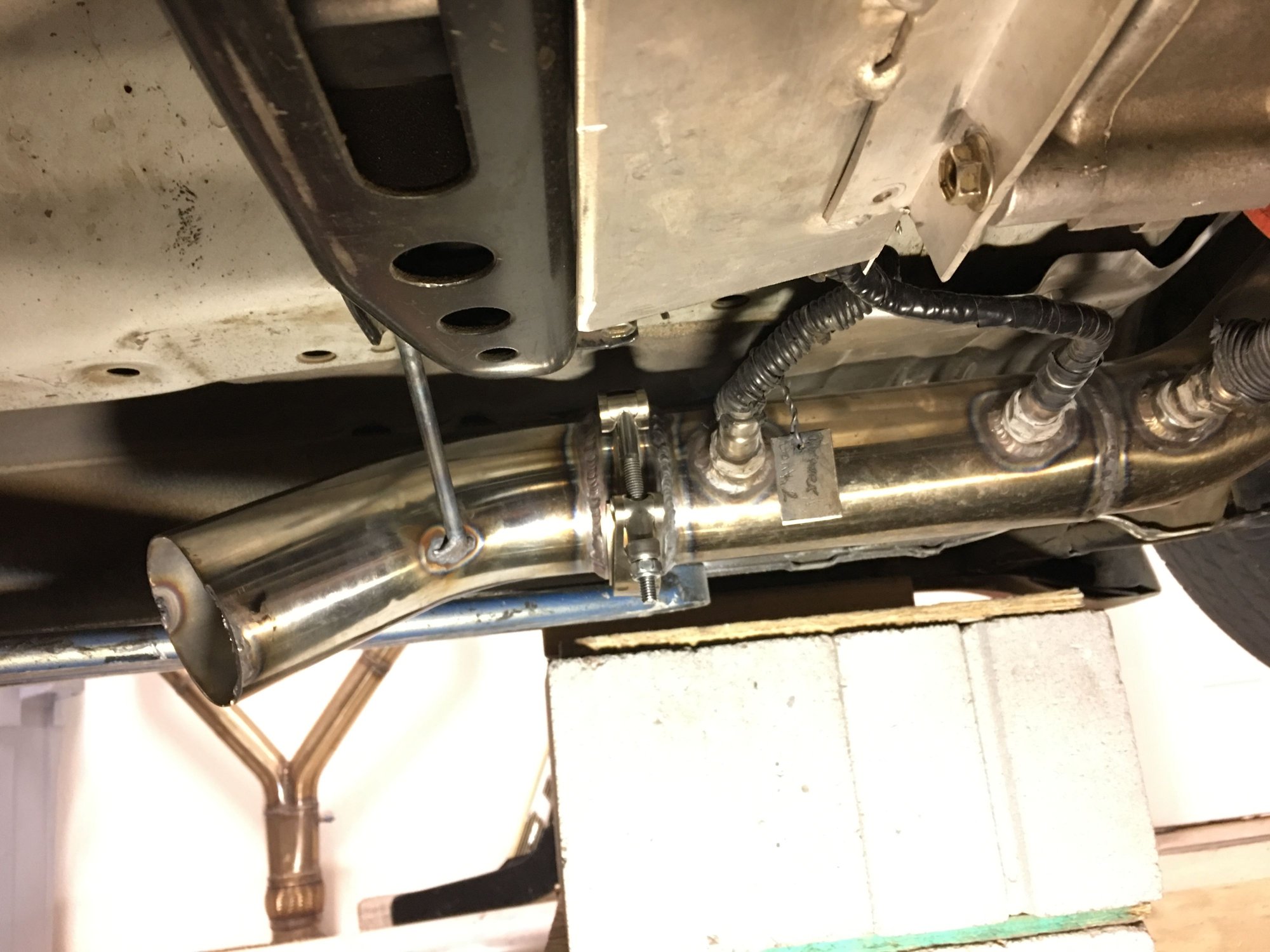

22 Inch Header Extensions with PPE Long Tube Headers for The DragStrip.
I did a set of these for my greddy twin kit ... it was indeed loud and it sounded great ... very gurgly!
OMZ - you should do them with V-Bands rather than 2bolt flanges

Looks Good! You have a lot of sensors in there.....
My Extension are Done!
I will only use them for the Drag Strip 2, 3 times a year.

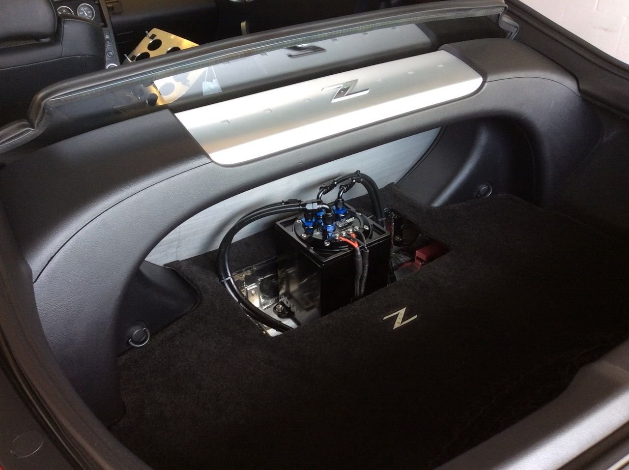

You can control the fuel pumps with the G4X. (I'm using G4+).
It's interesting to see that you went with the surge tank setup. The trunk is the best place if you don't mind having the fuel inside the cabin. In my case I relocated battery and fitted the surge tank were the battery used to be. The problem with my setup was that E85 temps were way too hot. In order to tackle the issue I installed a Aeroflow fuel controller and changed the piping a bit. I'm not sure if this will solve the issue, but have you considered a fuel cooler in the return line?
Elaborate - How do you use the G4+ to control the fuel pumps?

Yes, I might add a Fuel Cooler.
Temps are not to bad when I have 1/2 a tank or more, but their is some Heat.

Sorry took my time to answer this one.
You can use the analog outputs to control the fuel pump itself or a fuel pump speed controller. If you need just on off switch you control a relay with the G4+ (G4x) and hook the relay to a fuel pump.

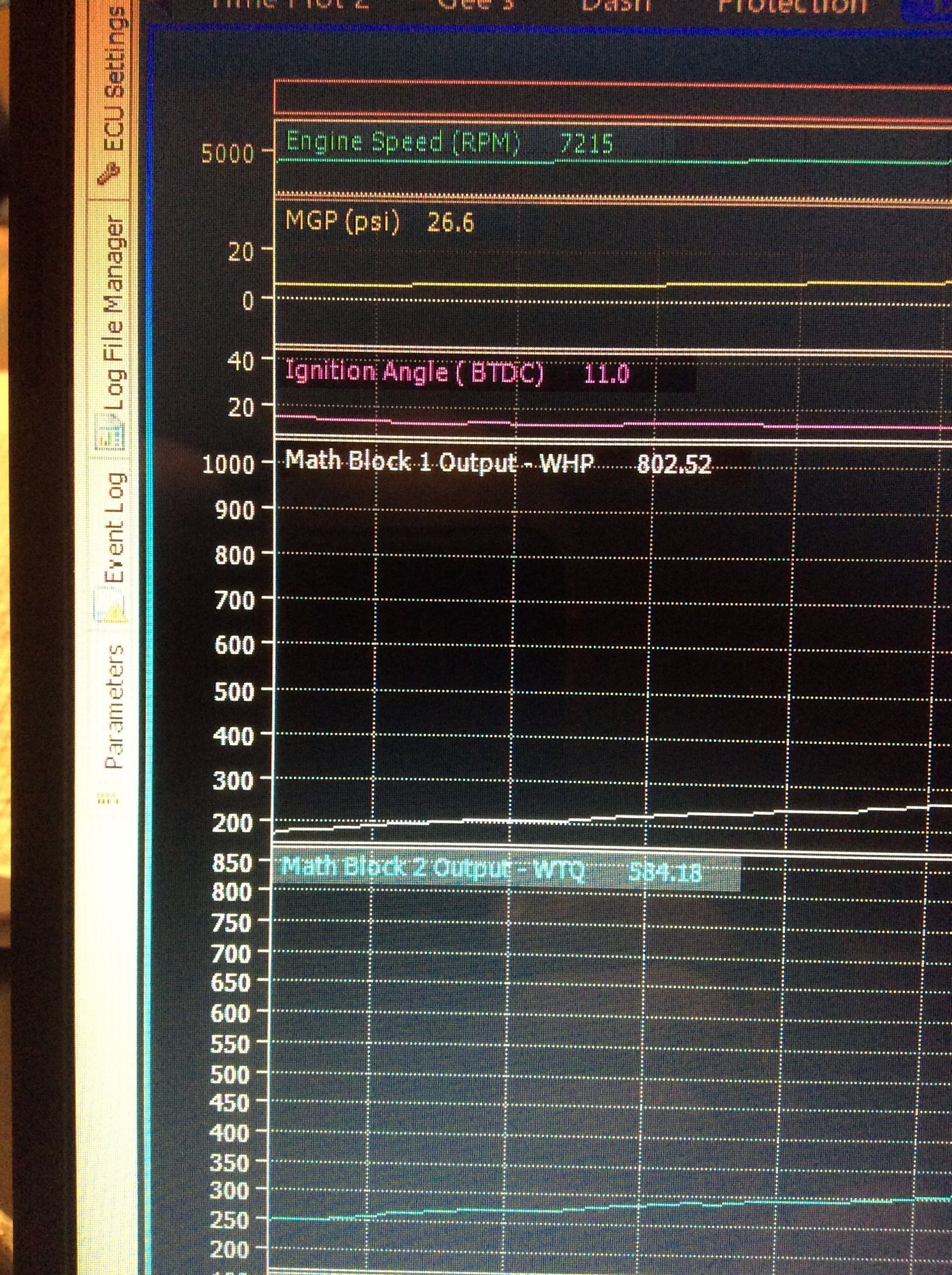

Likes: 230
Mid Race Tune is Done!
This is a Mix of 93 Pump & Race Gas about 102/104 Octane.
Data in Pic
Intended to run it out to 7500rpm, but tires were spinning to much, & I already had to lift out of the throttle @ 6000rpm because of tire spin.
