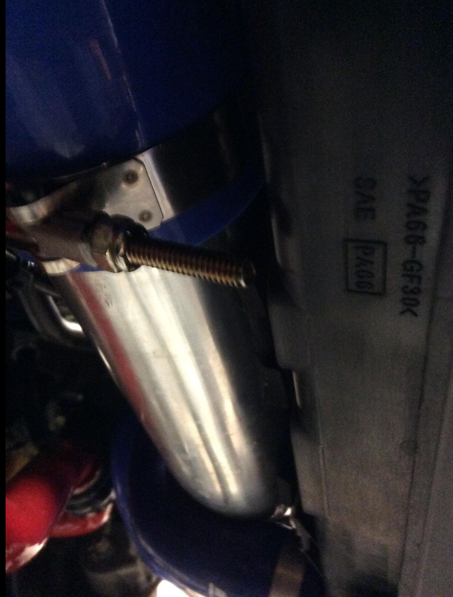

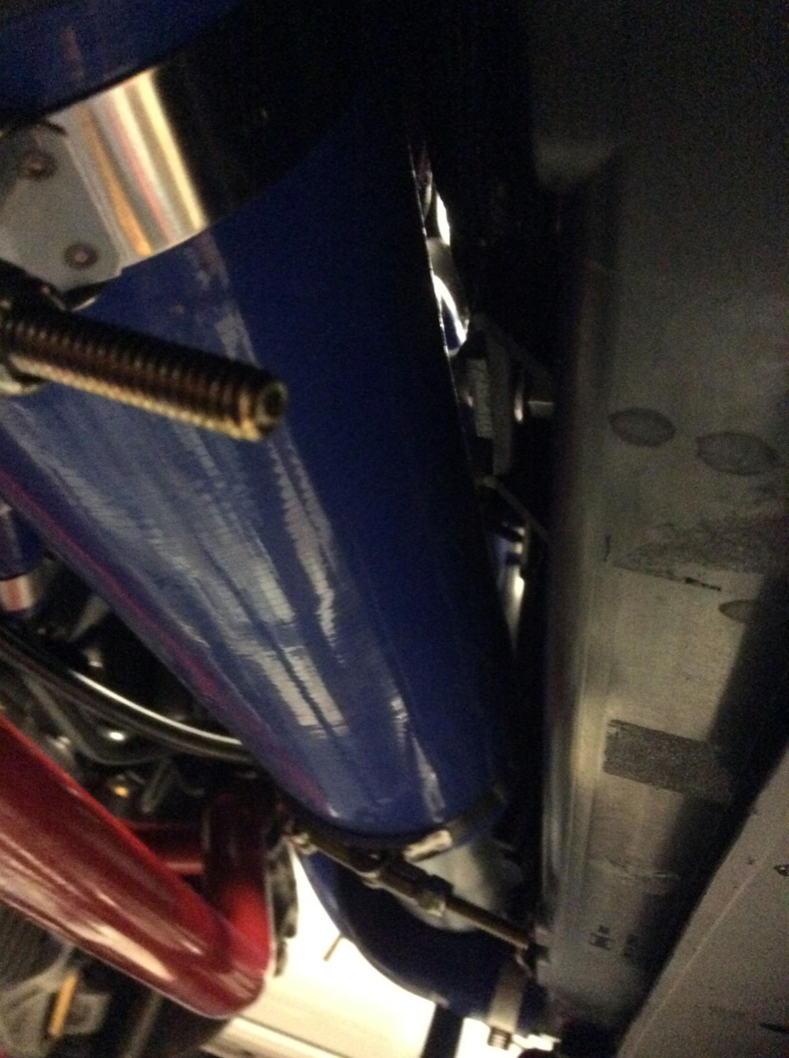

Hey Tim, can you post pictures of your 3'' piping ?
Old Sep 9, 2020 | 07:53 PM
  #57
OldManZ350's Avatar
OldManZ350
Posts: 2,429
Likes: 230
I don't know how much this will help you, but here are my best shots......
