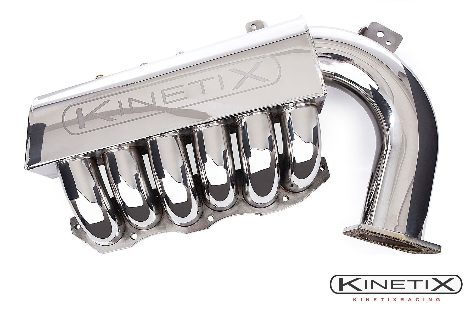

thinking of fabbing my own kinetix manifold, looks like a straight forward fab, but id be curious as to the manifold its self, metal thickness 1/8th of an inch? with a support structure inside? to support high psi,
Have fun building an intake (something I want to do as well) but dont mess up your OEM intake/plenum ... when you go and dyno do a back to back comparison and I bet the OEM flows better.
Corky Bell's Maximum boost has some good info on intake runners - design / theory and do more research but in reality, you wont out R&D OEM nissan ... only intake that flows better than OEM is cosworth ... but go nuts and enjoy the process.
I got the flange cut (water jet cutting), one step closer to putting it all together, I feel pretty confident in my tig welding and my fab after doing my turbo, but don't mean its going to be easy,
hmm...i will bite my tongue 😀
I'm still waiting for your OEM vs. Kinetics comparison ... One of these days I'll convince you!
I already did my spacer vs kinetix. And we know the spacer stomps a oem plenum. So i'd hate to see oem vs kinetix.
Now i really do wonder what the graph would like on a tuned 100% stock vs tuned stock w/kinetix.
