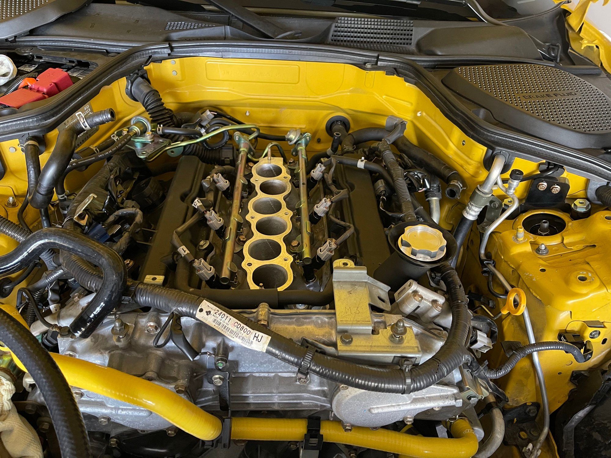

I actually have been working on some cooling issues lately. I am running on a very small shifter cart track that is really hard on my vortech supercharged engine. Cooling is key, especially in Texas. Here is a picture of the setup. Making about 410hp on E85. CSF Radiator, Mishiomoto Fan shroud, but with Spal fans installed, Nismo thermostat, water cooling additive, Tuner programmed the fans to come on sooner. Also, I switched from a V2 to a V3 supercharger so it is not involved in the oil circulation. Counter intuitive to some degree, but the bearings where going out on the V2 and contributing to higher oil temps. Once it warms back up outside we will see how it does. It has always been fine on the street, no over heating. Next steps will need to be more airflow thorugh the front and or a vented hood if I want to keep trying to run it hard on a very tight track. Here is a short video of my 17 year old son driving it on the track having fun running down a Corvette. LOL.. Ignore the trash talking my brother owns a corvette and we were calling him out in the video. Running on this type of track hard for 10 minutes allows very little air flow because the speeds are low, but you are running the engine very hard. ALL the cars come back needing some cool down time for both the engine and the brakes.

Actually, what happened on my last run at the track is the oil temp was running high around 240, but the water temp was holding and then it to started climbing fairly quickly toward the end of a 10 minute hard run. I think the causes for that were a few things. Look at where my license plate is? Not a great place to be for air flow track running. Plan on taking that off next time I go. Also, I discovered later after I took it into my shop that the bearings had gone out on the supercharger. The theory is that supercharger (V2 uses the engine oil) was cooking the oil quite a bit and contributing to the overheating. So, new V3 supercharger(self contained on the oil), Take off license Plate, Nismo thermostat(recommended by mechanic), Racing Radiator Fluid additive(People swear by this stuff), Pathfinder Mod. to better cool the rear two cylinders. Spent some time talking to the owner of the Z shop and he said the last two things to try was different bumper(better airflow) and a vented hood. He did say if the car overheats next time, take off the hood and try that to see what affect it has. Cheap way to check out before buying a new hood, which I really do not want to do. The capacity of the CSF radiator is far more than the OEM radiator with very good venting. Should make a substantial difference in that way. Trial and error. I should again point out this is not a "street" problem at all. Just on a very tight track, low air flow because of lower speeds, and running the engine hard. Probably the most extreme situation for the engine you could come up with.

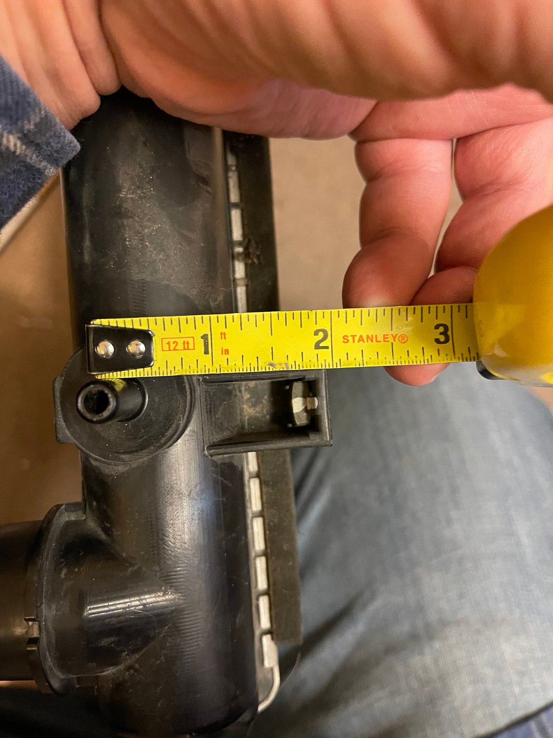

Note the difference in radiator capacity, but the mount points are the same depth. Still, I went with the thinner fan shroud with the SPAL fans. If I had to do it again I might have just mounted a single large spal fan right to the radiator. Not saying you should buy a CSF radiator either, it is great, but so are others. Just don't by the Mishi radiator. I have been told the fitment and quality is irregular. This CSF was well made. Heck, I would start with the OEM and then if there is a problem then make changes.
