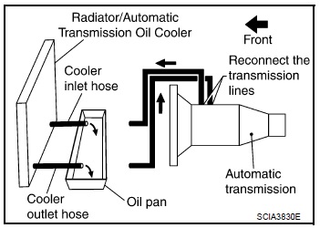

Reviving an old thread. I cannot remember which of the hard lines is in or out. Does anyone remember?
Also, has anyone replaced the hard lines? My trans cooler currently runs a line clamped onto the hard line. I'm going to look in the FSM but I would be interested in hearing from anyone who has already done this.
The attached diagram shows which one is which.
My hard lines were replaced with braided line.
